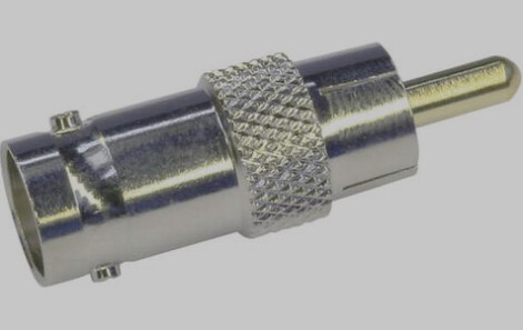

Now I have a doubt that could be a dealbreaker for su2
One of the things I want from the SU2 is to instantly swap between dacs.
My 2 dacs currently have spdif only, and the SU2 has only 1 spdif out, the other being a BNC one;
Is BNC compatible with spdif? Is the AES?
I tried to research on my own and the answers were not clear.
Again it will take me a long time to save for the yggy or comet+ since I quit my job; now that I’ll have a preamp with volume control (3xp) I might as well go BF2 for the time being which also has spdif inputs only (just saying, not that I would go bf2 + su2 in that case I would get a better dac instead)
On the SU2, the coax rca and bnc outputs both output spdif, so they use the same. Unbalanced AES can be run over bnc, but in this case it is just spdif. BNC is just a connector type like RCA, so whatever is run over it will vary. Assuming it’s a 75 ohm spdif output (which I think it is), you can just use a simple bnc to rca adapter and use that as another spdif output. Now if those two outputs can be run simultaneously is another story, and I’m not sure if they can or not (although I’m pretty sure you can). It had no issues outputting both aes and spdif at the same time, but I’m not sure if both spdif outputs are tied together or something
Thanks, deals saved
And also wavetheorys video confirms all the outputs on the su2 run at the same time (maybe except I2s)
The BF2 is still tempting AF tho for an unemployed man, I never got one because I wanted a volume control with remote control and now ive got 2
Cool cool, then all you will need is either a bnc to rca cable, or a simple adapter like this Audioquest RCA to BNC Adapter to just use a normal spdif cable (doesn’t have to be aq, just an example of what you’d be looking for, basically a female rca to male bnc adapter)
Ive already looked for a bnc and adapter on amazon, that audioquest looks prettier tho
Depending on what cables you need, you could run a BNC-BNC cable and then use a “BNC female to RCA male” adapter:
Or turn BNC into RCA right at the RCA-out
Since BNC is a very common connector in the measurement world, quality adapters can be had for cheap.
Edit: My BNC cables and adapters are either “Telegärtner” or “Testec”.
Interesting factoid, the Pi2AES BNC output is SE AES. Not a common thing.
It’s actually irritating because almost no hifi dacs support unbalanced aes lol
