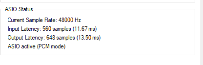

I can live with 13ms, lol

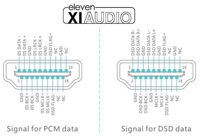

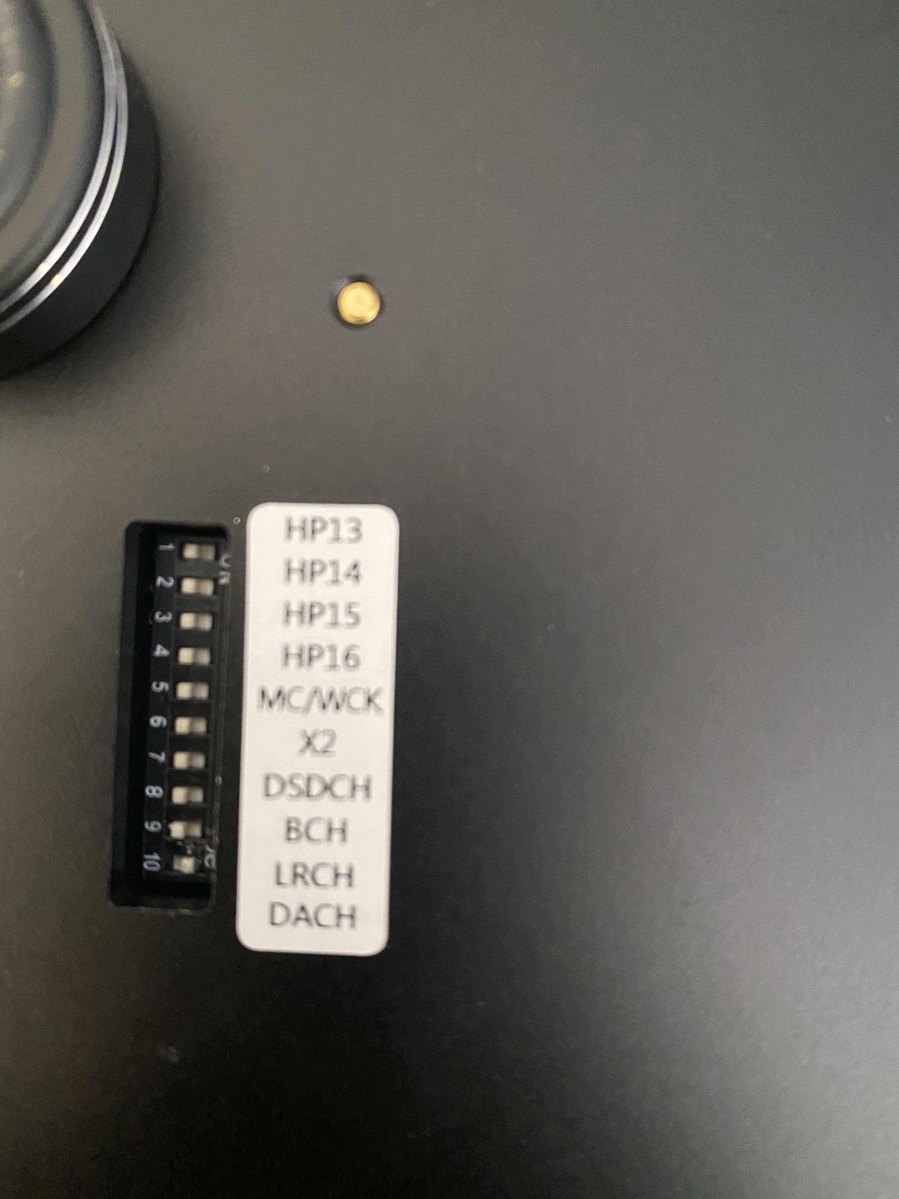

Can anyone assist or point me towards a guide on how to (or if it is possible to) apply the I2S pin out for PCM I got with my DAC with the I2S setting dip switches on the SU-6 pictured here? Google didn’t tell me anything.
Not 100% sure, but it looks very similar to the SU-2 switches:
Best guess, if you don’t want to use DSD, you just need switches 9 and 10 on.
It’s unclear but to enable DSD you would need to set either one or two to on (not both).
You might have to also toggle switch 6 if it’s not playing properly.
Thank you guys. Those didn’t work- but they actually sounded better than the defaults, lol. I’ll reach out to Singxer and see if I can get a definitive answer.

Should mostly just click and pop, most of the settings are just determining if the pair of wires associated with a signal needs to be inverted, or whether a clock needs to be doubled.
The first 4 switches just determine how it decides if it’s in DSD mode or PCM.
