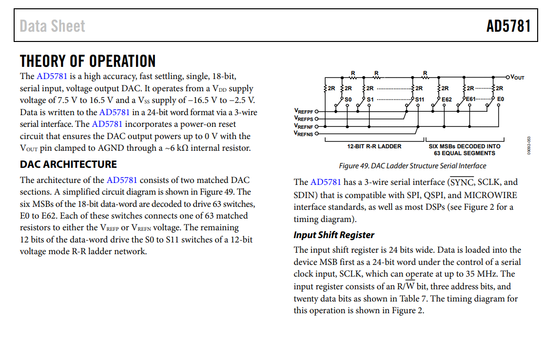

Hey guys, quick question. A friend of mine told me the Gumby is not a real R2R DAC, that it uses a R2R chip or something like that. I found that very strange, is any of it true?
All the Schiit Multibit DAC’s use R2R chips.
All DAC’s used to be that way, then DSD chips came along, and they were cheaper and could claim a lot more “bits”. No one makes audio specific R2R chips anymore, so Schiit use Analog Devices and TI chips designed for industrial machines like MRI machines.
They are still resistor ladders, just on a piece of silicon, and probably more accurate than building something out of discrete resistors.
They use multiple chips to increase resolution and multiplex the bottom bits to increase how it measures further.
Is it R2R? yes
Does it use chips? Yes
Does it use discrete resistors? No
Do they increase the resolution with oversampling? Yes
Cool, thanks for the explanation!
Regardless of what the schiit uses, I’d say “real” r2r counts for both discrete designs and chip based r2r, don’t think the chip based designs are inherently inferior or lesser than a ladder of resistors. Heard (and owned) excellent examples of both (but no longer own a chip based r2r now that I think about it)

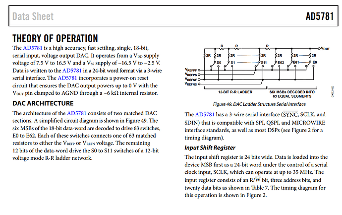

It uses an R2R chip, and the datasheet even shows how the device operates:
It is not a discrete (= stand-alone resistors connected via PCB) DAC, but it is definitely R2R.
They’re not as “visually impressive” as rows upon rows of discreet resistors though. ![]()
