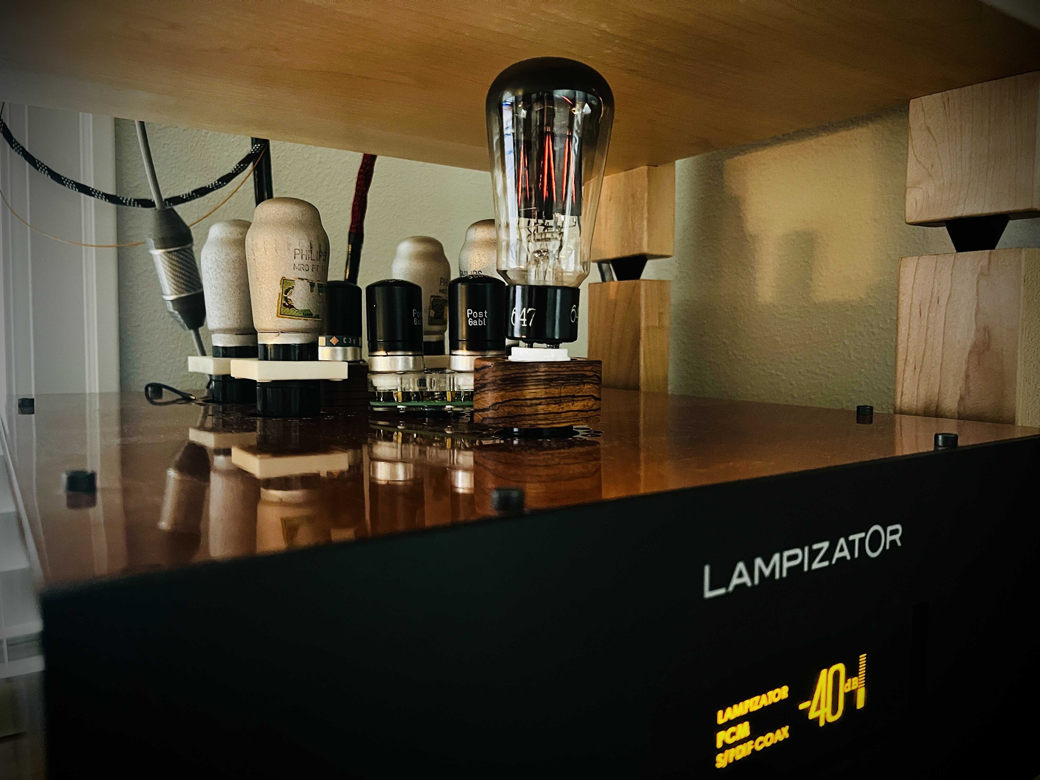

Obviously I’ve never heard the Poseidon, but this is my current configuration of the balanced Pacific2 w/ the Valvo G2504, 2x Telefunken C3G, 2x Siemens C3G, and 4x Philips PT14 tubes, and it is sublime. If my prior DACs were V8, this is V10 or V12 – not necessarily faster, but just more goodness.
I just cannot describe the last nth degree of vocal realism and timbre, but if this is what DHT is about, I’m sold.
In listening to Lukasz’s interview, I think DHT has a special place in his heart if not for how difficult it is to find tubes, and this isn’t just unique to Lampizator. Alas, in this bottomless pursuit, for me it’s worth it. If my house ever burned down and I lost all these tubes, I’d probably give up on audio.
