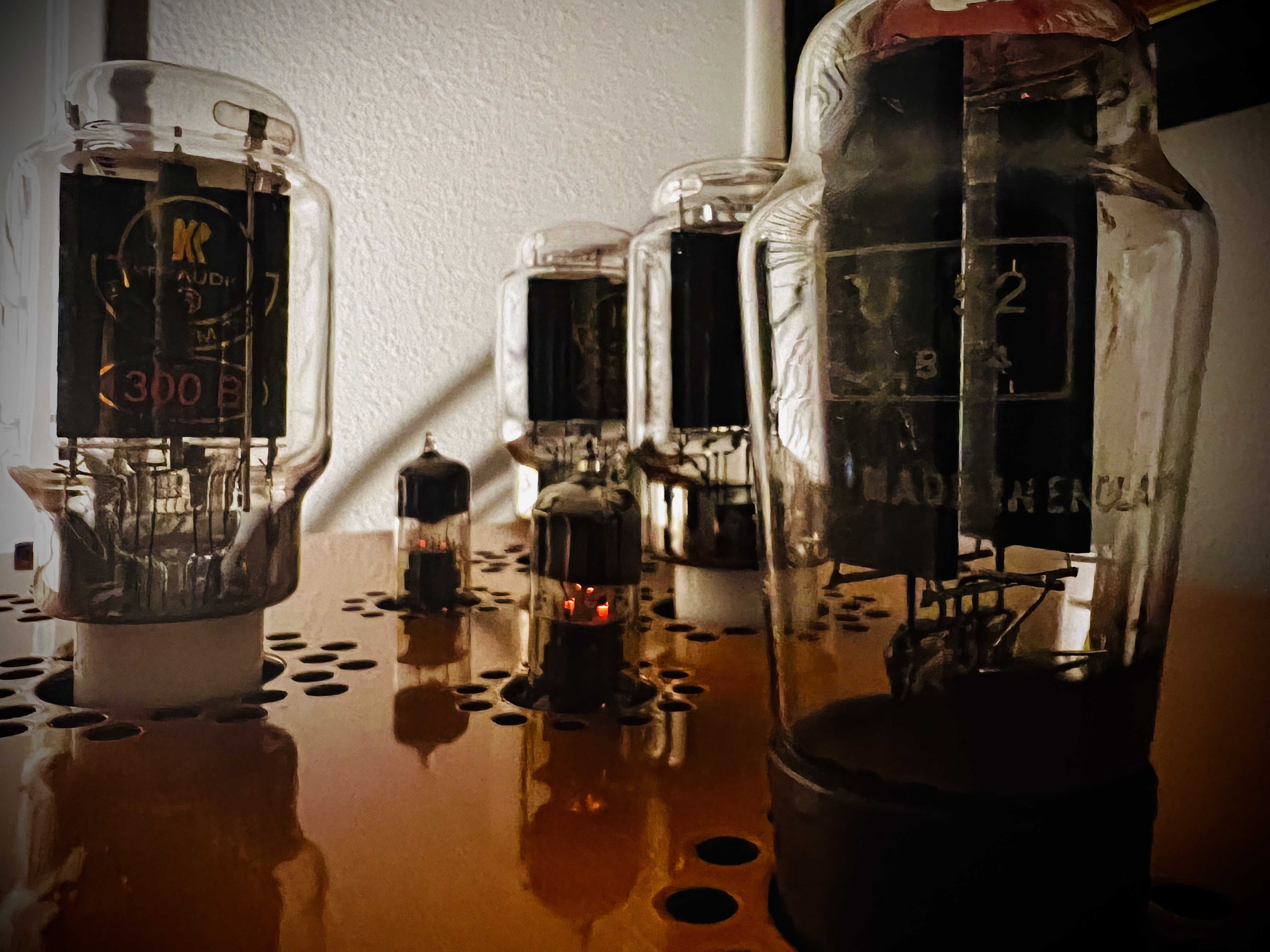

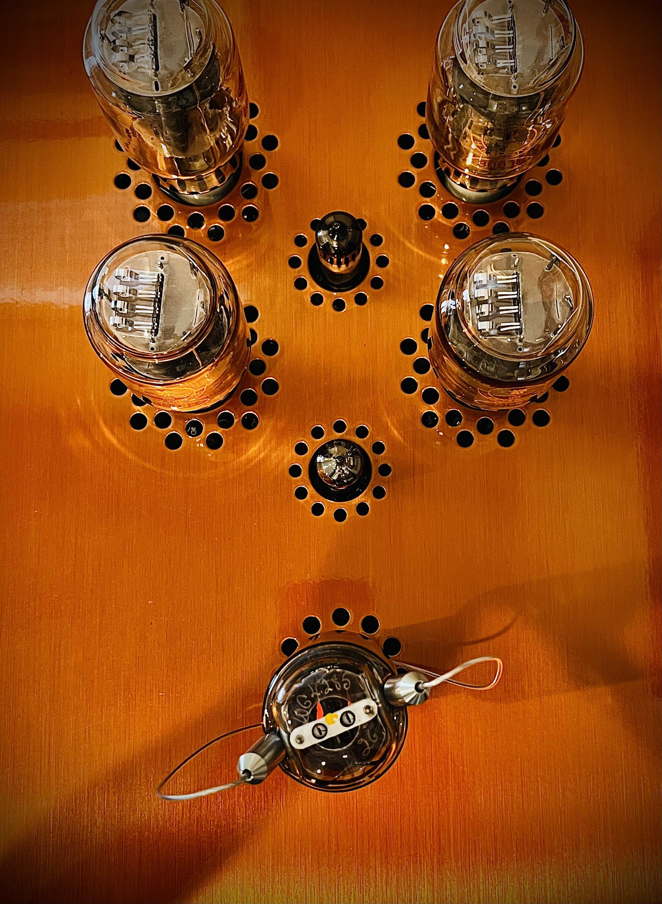

Yes went back to stock KR 300B RK anniversaries + USAF 596 frankie. The combo is surprisingly awesome – just right fleshiness, tight, deep bass, very quiet and transparent and detailed. I think this might be my defacto combo to unthrone, but there’s a few more incoming tubes ![]()
The only downside is that the 596 is huge. So now it’s 14" tall from the base so can’t move it from the top shelf anymore.
