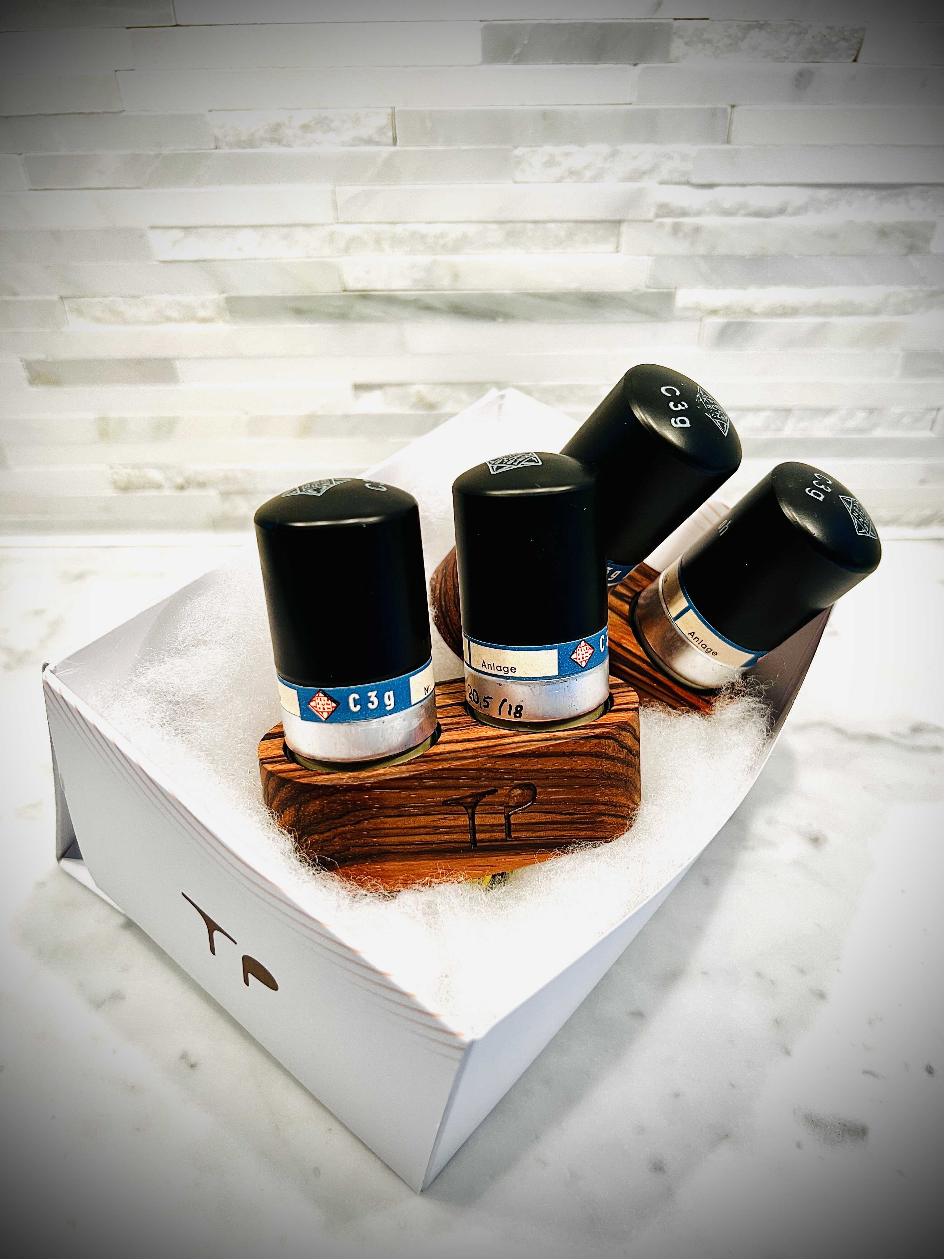

@NickMimi I am ashamed that these adapters are yet another terrible reason why tubes are not eco-friendly. Look at this poor tree that got hurt. Oh, and there’s even a grounding wire for the adapter. Greta would be ashamed.
Alas, luckily, since everyone is now going to only buy SS gear, I might as well enjoy these for awhile…
I did find these tubes though, and thought to help the environment by just getting rid of as many of them as possible…
I hate you…if ever I find myself in Seattle though I’ll buy lunch or even dinner as a thank you for the opportunity to allow me to listen to and possibly lick & fondle that set up :grimacing:
