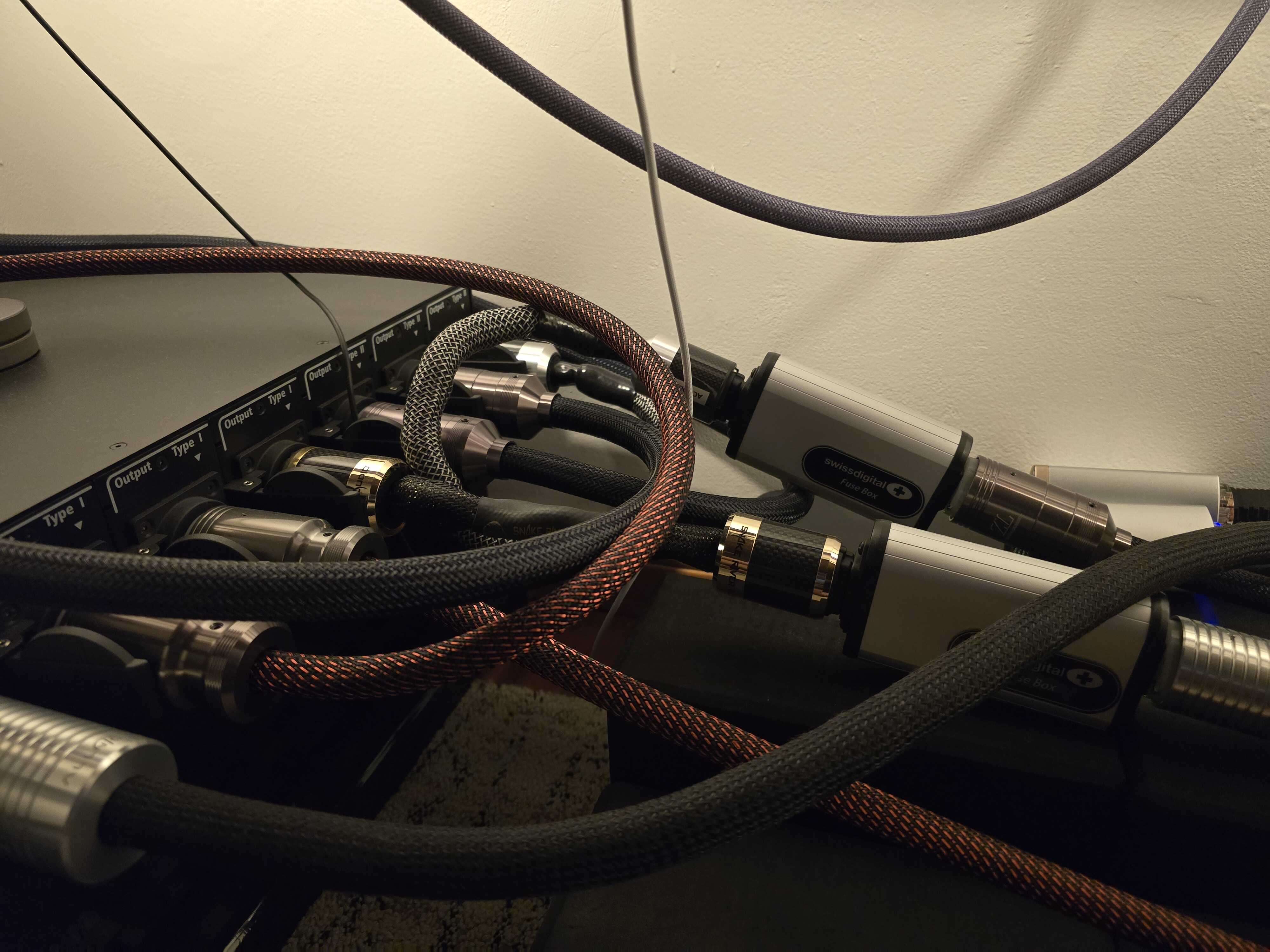

It’s the safety device (SwissDigitalFuseBox) that functions as the fuse. You can either program it to one specific component rating or a box that can do multiple amp ratings, in case ya want a more versatile option.
If you wanted to know how it’s setup here’s a pic of it on my system (it’s ugly, should find a way to clean it up lol)…

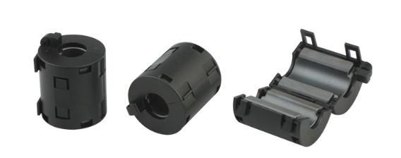

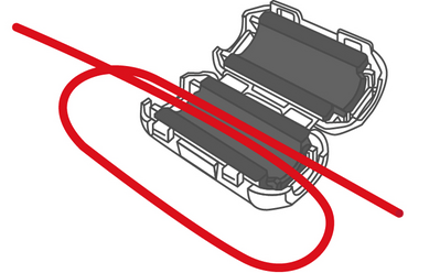

Ferrite cores should always be on hand. Cheap little problem solvers.
Install like so on signal cables and hear what happens:
