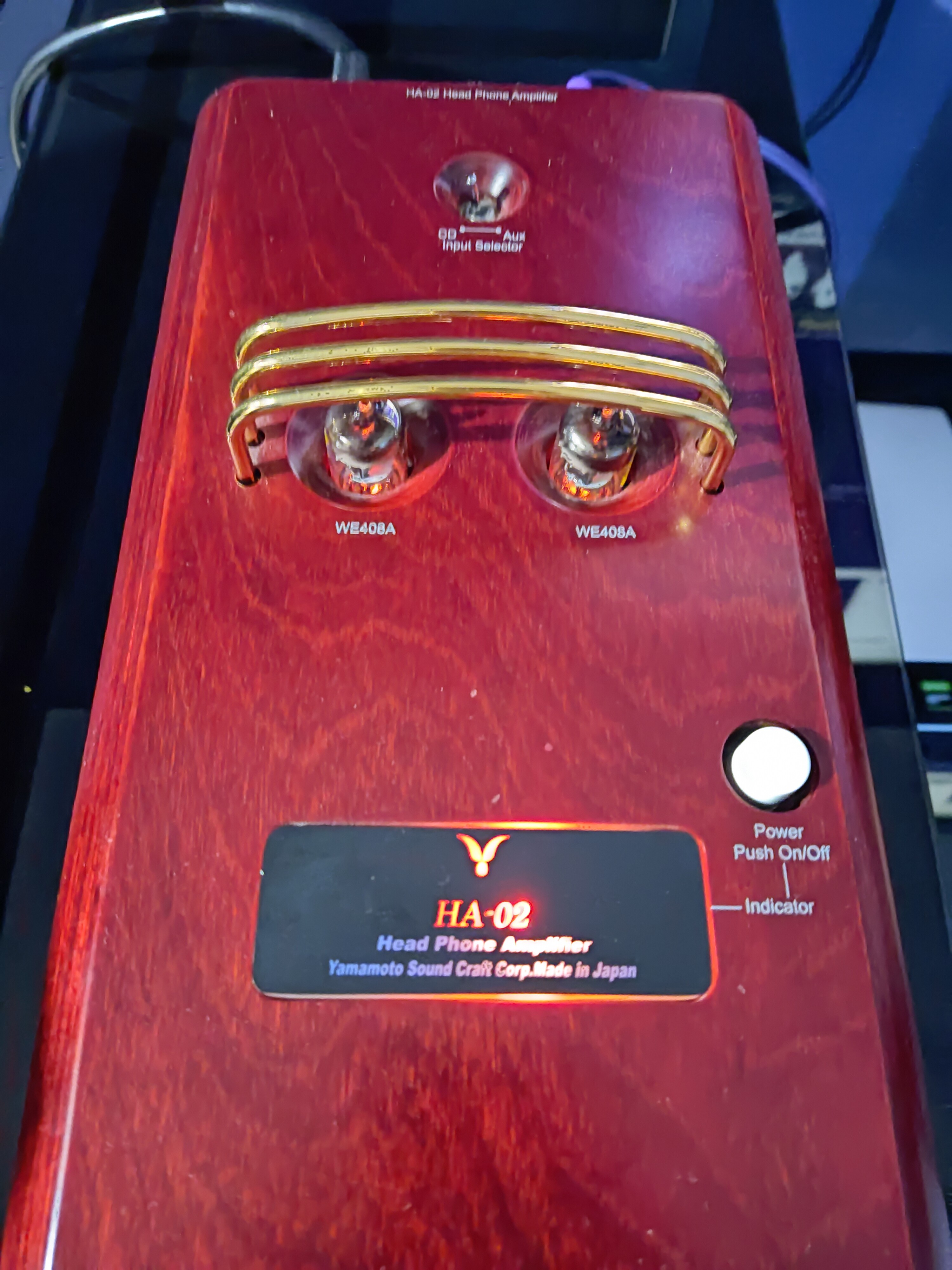

If it’s the tubes swapping the tubes over will reverse the effect.
If it’s not that it’s probably not user addressable.
Thanks thats nice to know, will test after work

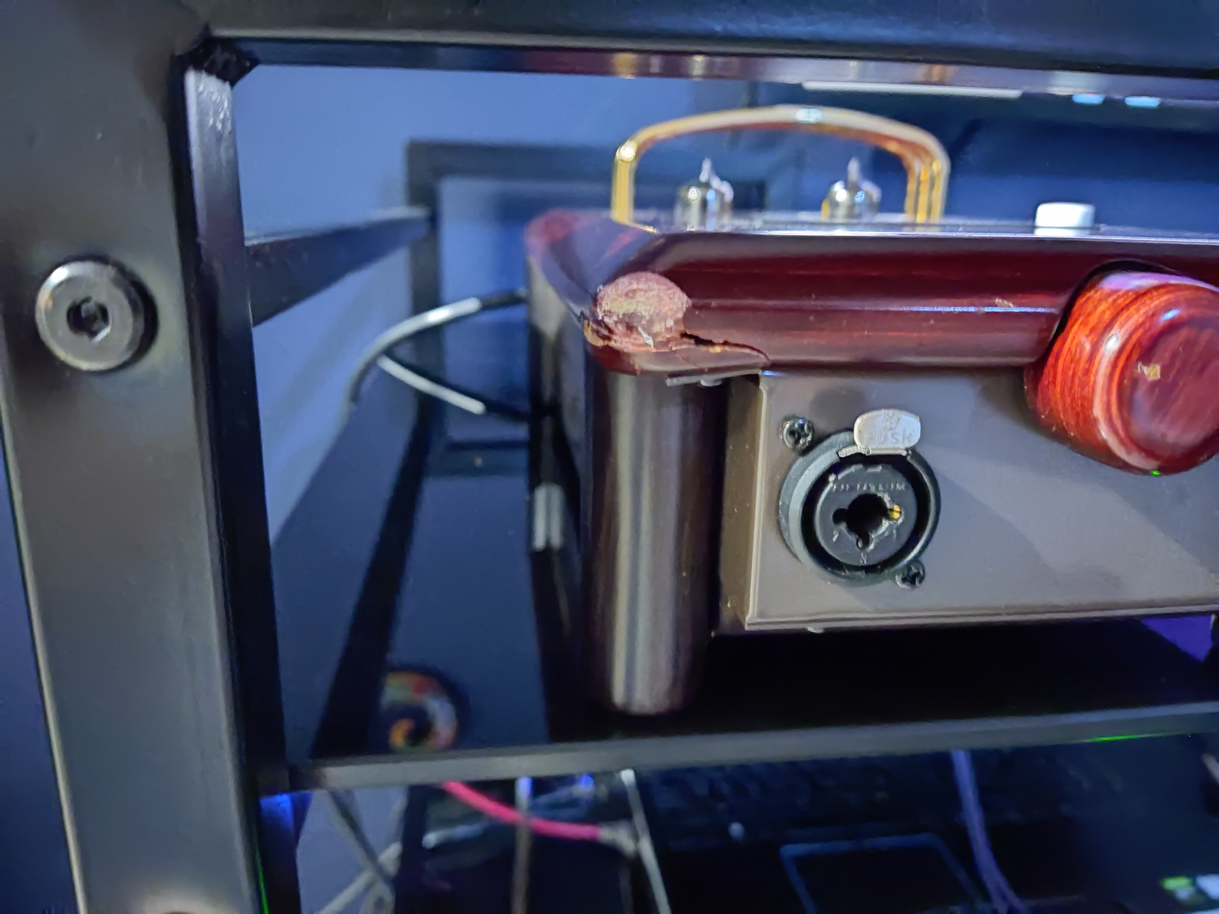

The box itself isnt very damaged ive gotten way worse it was packed tight, but also has a sus stab
The hit was strong enough to even bend the metal underneath, the wood itself has no fungi or stuff
Leds light up properly
There is a decent chance it’s a tube, I don’t see how a drop would damage the Pot, if it’s not that there is a very good chance one of the heavier internal components (a transformer or choke) damaged something more substantial when it came to an abrupt halt.
That would take someone with real tools to diagnose.
I really hope the tube swap confirms that, it would make my day
If not its going to yamamoto or at least the local audio repair guy, this is discontinued so I hope its the tubes

Okay so swapping the tubes didn’t work as the issues remained exactly the same on the same channels.
the tubes look aesthetically perfect and im almost sure they are good and working, as the sound I can get on the left channel sounds very clean and good.
I have two more clues which could be useful
  1. If the amp is turned off (with its switch) the sound doesn’t go through passively…
    but if the amp is turned on with the pot off position, the music plays through the right channel anyway, which is the buzzing channel; then while turning up the pot, only the music (not the buzz) gets louder and goes from right to left until it only plays on the left. As I said before the music on the left channel sounds very good.
  2. the buzz volume is consistently the same, its around 70db~ and sounds very much like a 280hz sine wave is phasing with a square wave; aka the classic analog static sound.
    I can manipulate this sound by getting my hand close to the surface of the amp, not anywhere else.
    The closer my hands are to the wood, tubes or tube shelters the more distorted the wave becomes in that order; so touching the wood gets a distortion, the tubes more distortion, and the golden tube shelters extreme distortion.
this leaves me to believe there is a bad contact or something but also this
so im gonna open it to see if theres nothing visibly interfering the signal path, and then im gonna leave it to experts. (also dont worry im aware of the safety measures and not doing stupid things with live current)
Update: there are 0 shorts and everything looks perfectly fine except for the power transformer, the metal plate that holds it is clearly bent and partially detached, so this is 99% likely dead imma keep on with my life, maybe turn it into a mono amp for the lulz
