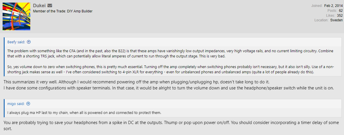

but yeah he doesn’t say that hot plugging is bad, just be careful
Not that big of a deal, you just have to know, becomes 2nd nature whenever you want to use the amp
That’s personally what I have done on that amp and it works reasonably fine
Also I should note that it’s safer to hot swap an xlr plug vs a 1/4 inch trs plug, because when you hot swap a trs you short things out, you don’t get that with xlr
Edit: well look at that the same thing was just posted above lol
Oh wow. Well let me edit my posts. I PMed dukie about it a whole back when I was thinking about commissioning one and he told me it wasn’t necessary
So if you want to warm up wa33 with nothing plugged in just do it in preamp mode?
I just plug something in before I turn it on, but I leave headphones plugged in to pretty much everything unless I am swapping them out.
There is a chance they are assuming the preamp output is connected to something, not just dangling. But my guess is there is a load resistor in parallel with the pre amp output, in which case it’s probably fine. But I’d check with Woo if you intended to use it like that.
Me too. I would definitely find a way to blow it up.
Well damn perhaps I shouldn’t have mentioned that, but it sounds so good lol. It’s really not that big of a deal as long as you know how to use it properly
It’s the specific reason Abyss will not recommend the amp FWIW, they’ve had owners damage headphones.
But generally I’m with you it’s not a big deal.

The hot swap issue isnt even that hard if he wants no compromise. Ive seen DIY builds have a switch that connects a resistor for a load durring warm up. You switch over to the resistor when you want to swap cans and switch back once something is plugged in.
