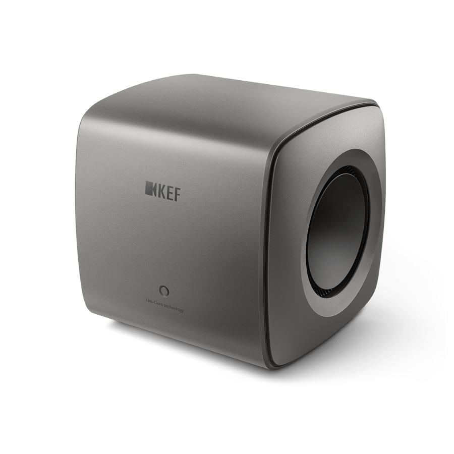

KEF does a dual firing series of subwoofers, one is obviously designed for the Meta Speakers, while the other larger variant is more traditional in ascetics.
Anyone have any background on these two?

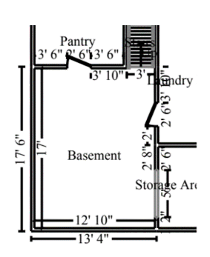

The HT is setup in the basement (concrete floor w/ rug). The HT is in the 12’10”x17” area. The whole basement is about 20x23.

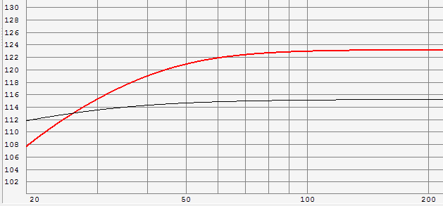

" BRIEF TECHNICAL EXAMPLE OF THE MBM
The following charts highlight the differences between a MBM loaded with a pro-audio driver (in this case a PA-460) and a Full Marty loaded with a big excursion driver (in this case a UM-18).
The first chart shows the frequency response (with no EQ) of both systems with an arbitrary 500 watts of power. What can clearly be seen is for the same amount of “nominal power”, the MBM produces significantly more output in the upper bass. 70Hz is roughly the frequency where folks report “kick-in-the-chest” bass.
Frequency response at 500 watts, PA-460 (red line), UM-18 (black line):"

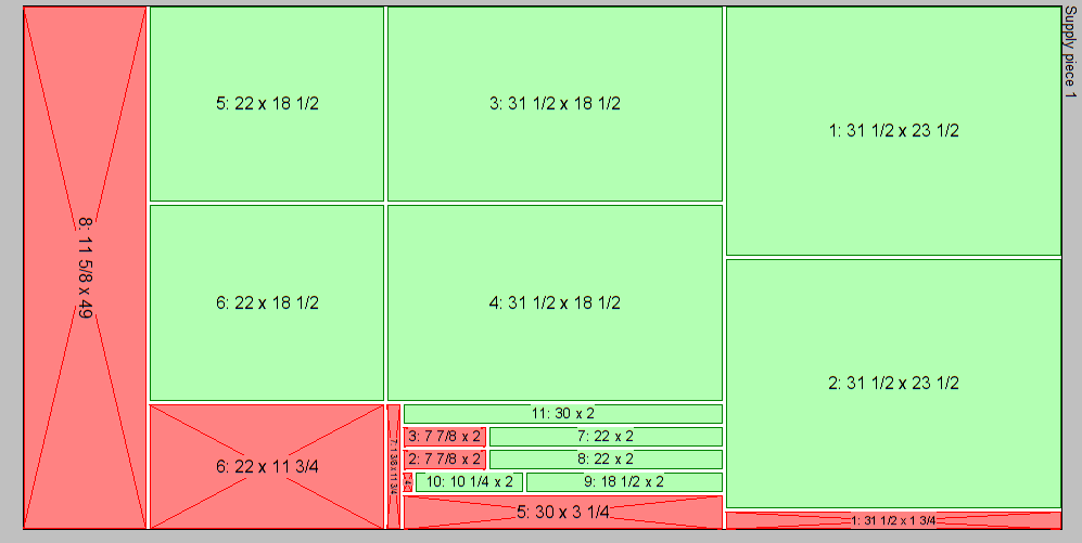

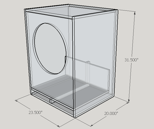

I decided I’m going to try the DIY route. If I cut the plywood myself, I’ll be able to build (2) 18" subwoofers for roughly the cost of (1) 12" monolith. :exploding_head: Should be a fun project whenever I decide to start.
Don’t even go that route, there are some very good flat pack precut kits out there.
Yes, GSG Audio has awesome flatpacks.
However, there’s this subwoofer called V.B.S.S. (Value Buster Subwoofer System - MTG Designs - VBSS). The person who created it shared the cut list and it seems doable. I want to create the slot port version.

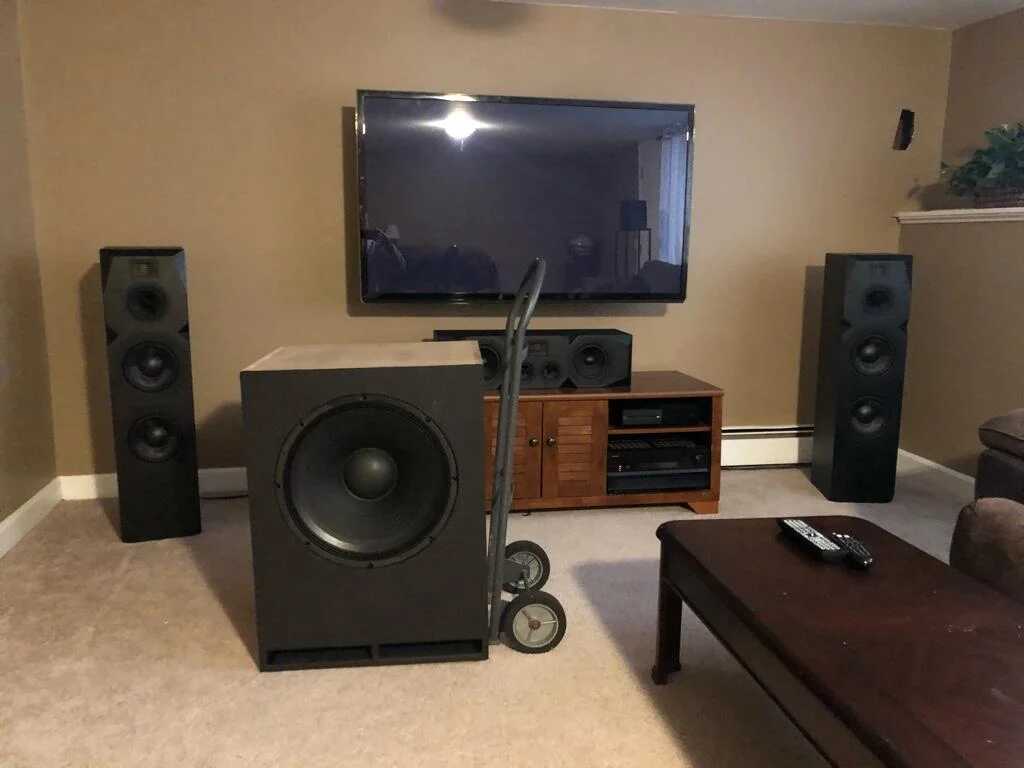

Browsing through the DIY build forum and found a picture next to a similar HT speakers I have… these thing looks massive… LOL.
You making this for 2 channel or HT? Just curious :eyes:
DIY subs for HT use. Still loving the sound from the Zu’s w/o any subs.
