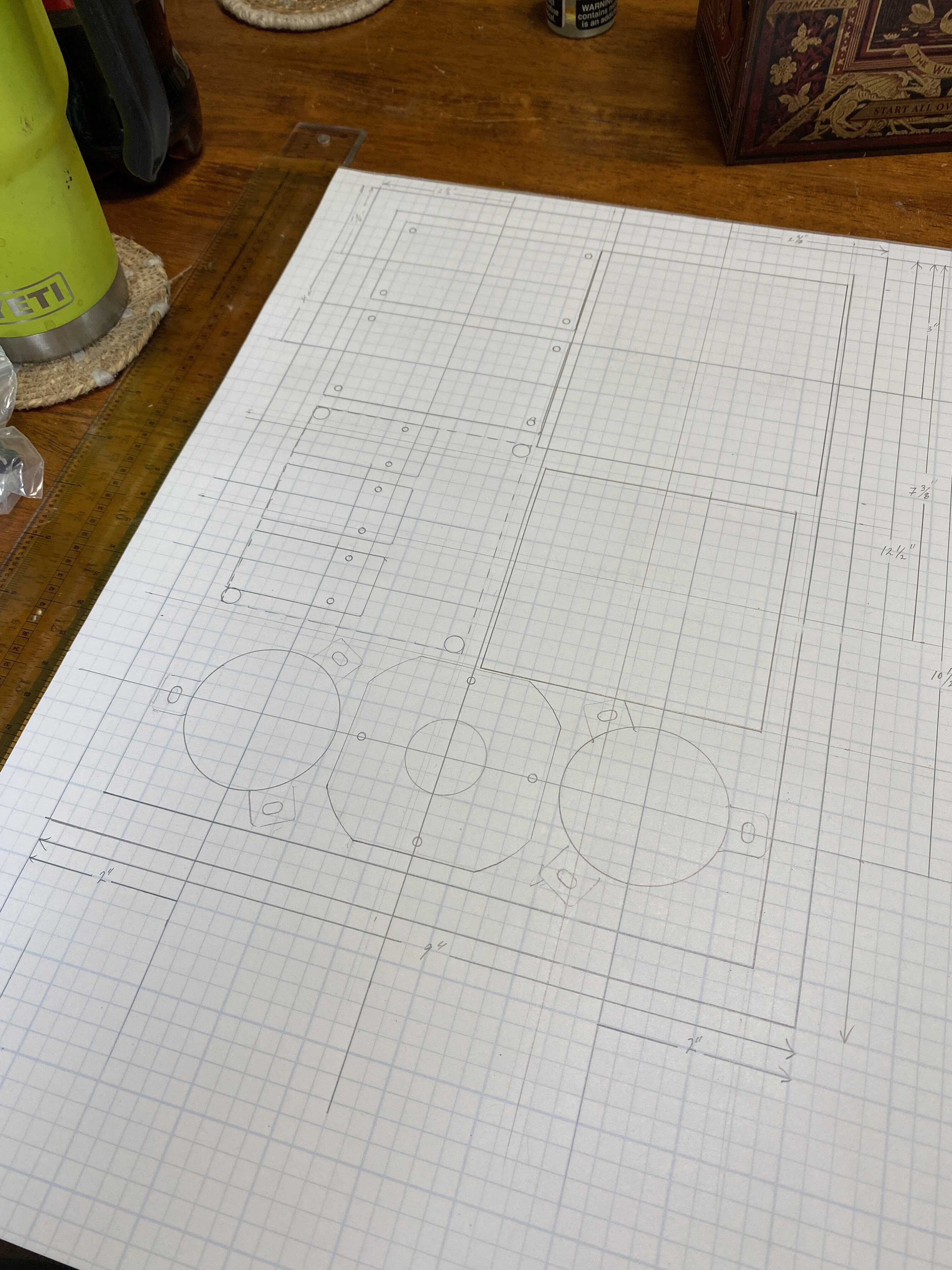

With this though, there needed to be more room in the chassis to accommodate. So we have moved to a 2 chassis design. Much smaller than what others proposed footprint wise though and the slab i picked out should be able to be used for the front of both so it will look splendid together.

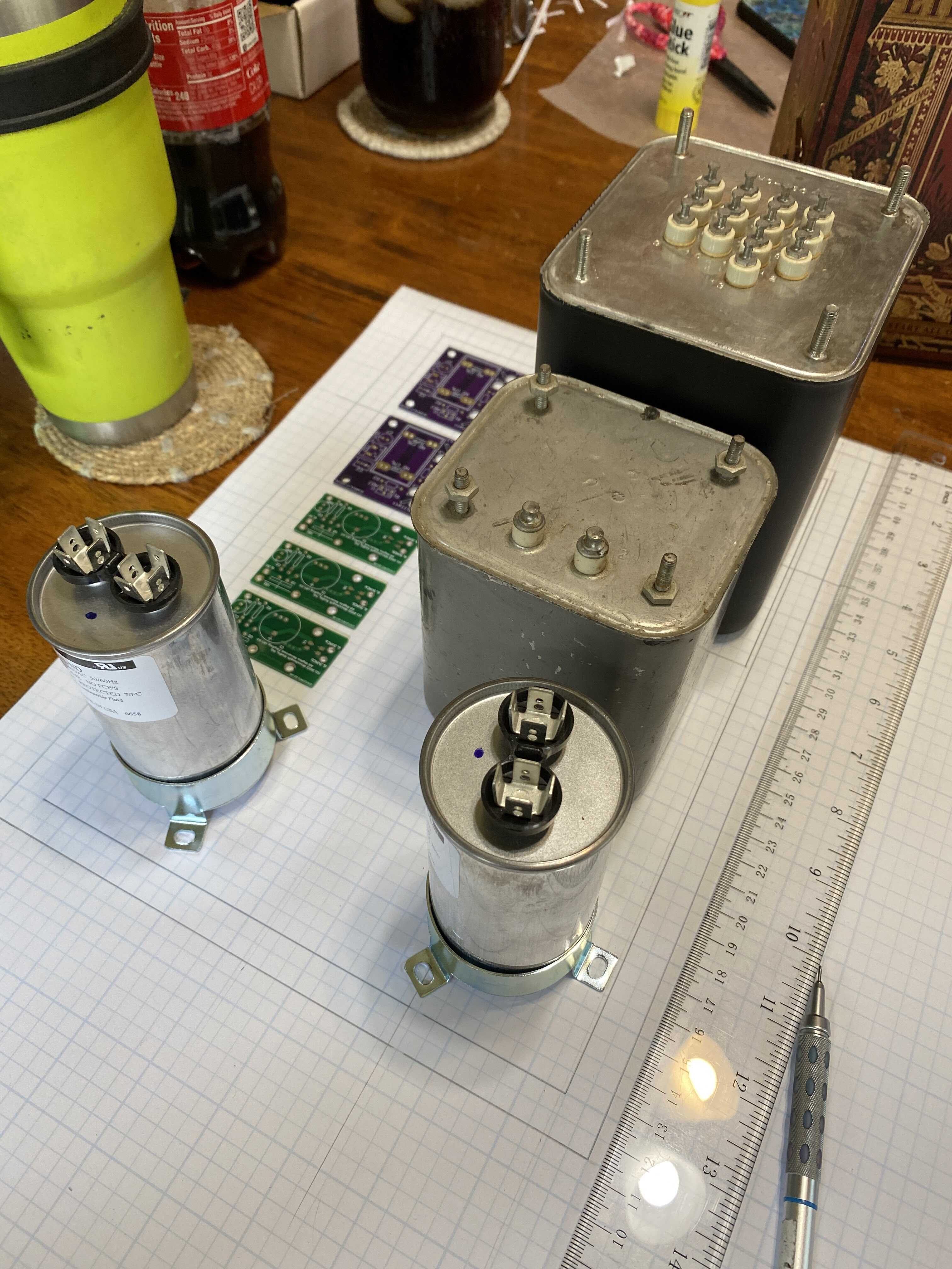

But with the 2 chassis there is also a few other things we can do. First thing is there is now room for paper-in-oil caps in the power section. The other is the C3gs can now have all their own dedicated regulators.

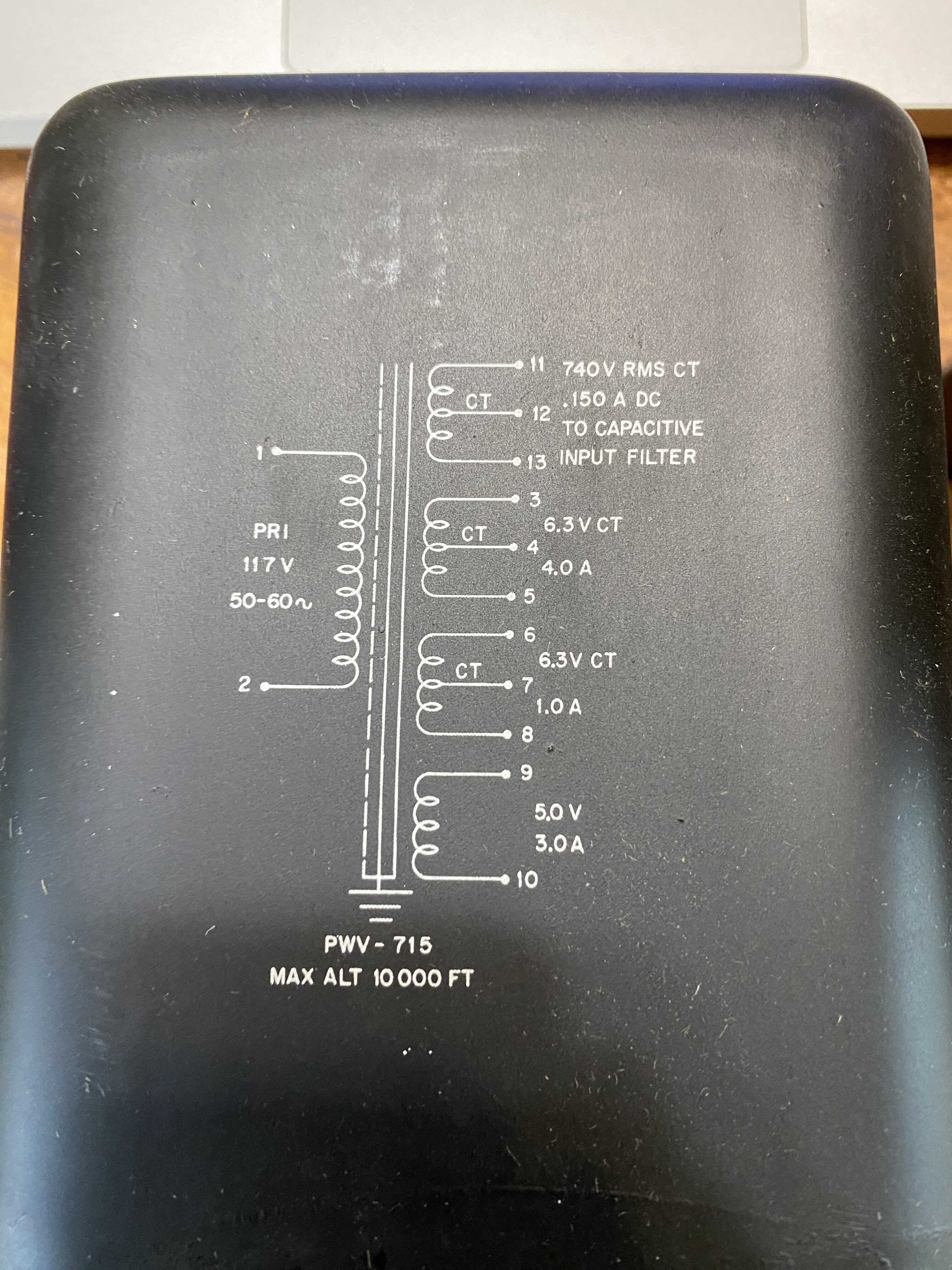

Finally got some pics as the pieces come in. He waits for everything to come in to make sure it will physically fit before making the CAD layout and putting together the box.
Apparently TKD still makes these, but you need to be an industry insider and Japan native to even have a chance.

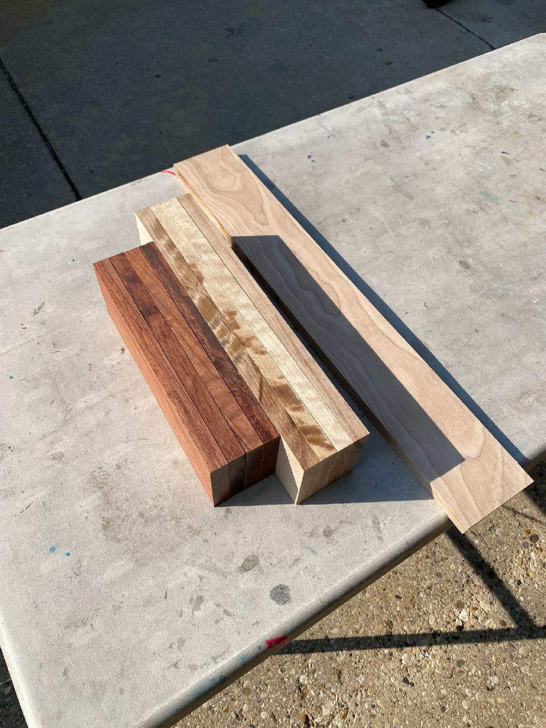

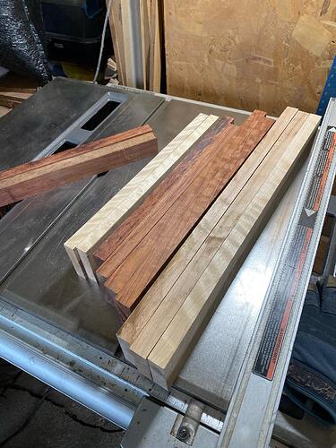

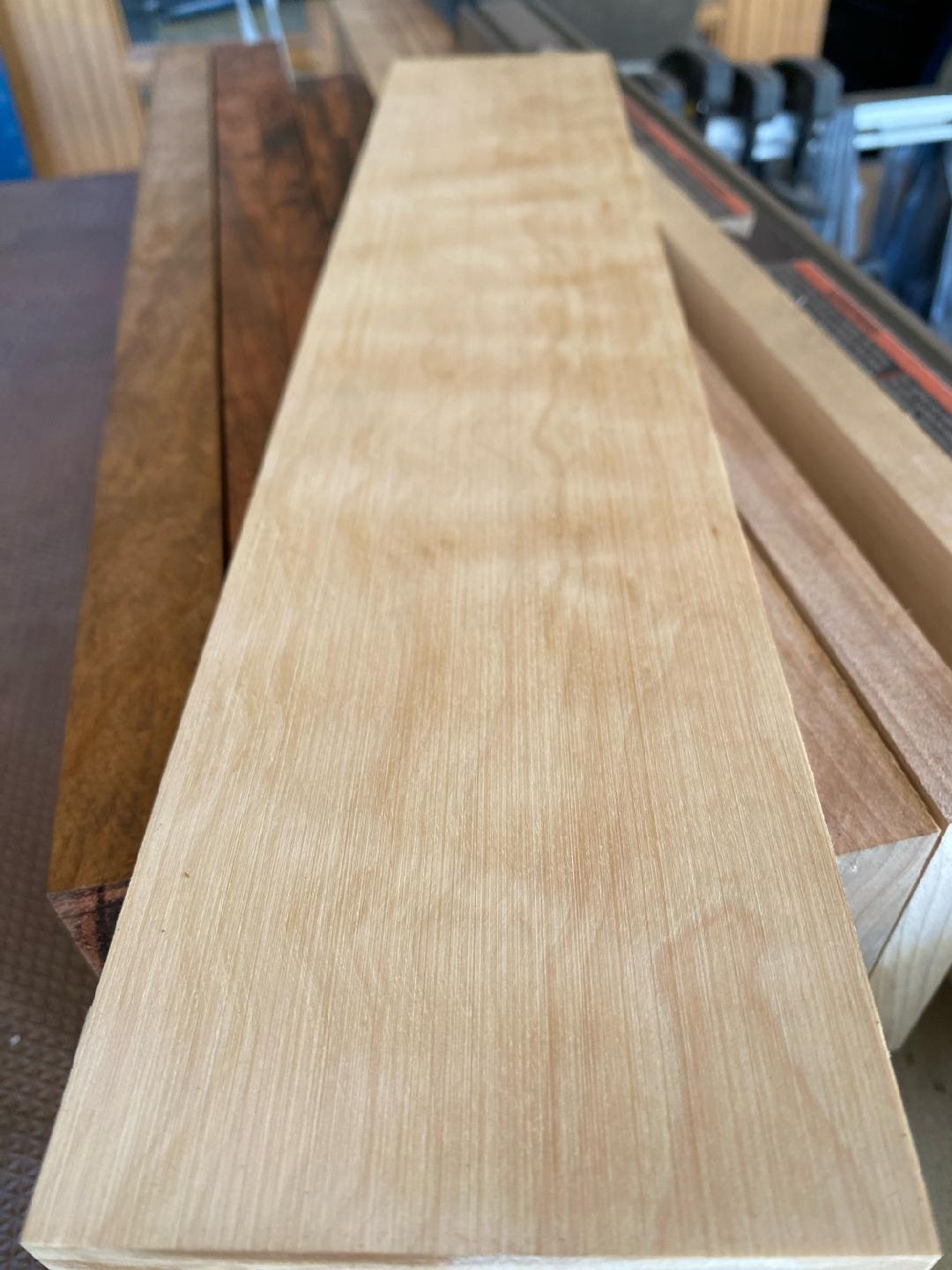

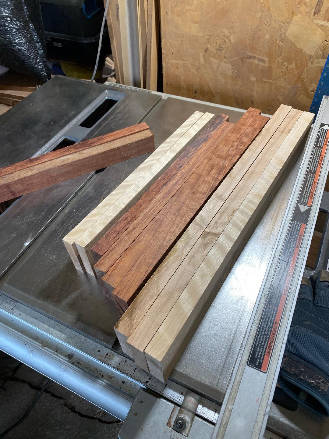

Anyone want to take a stab at the woods me and the builder chose?
Maple, Bubinga, Cherry
Def have maple and cherry but no clue about the last one. Bubinga is as good as any I guess… Sapelle looks like that as well but don’t know its raw color.
Oh and the one up against the wall is easy! Oriented strand board. :upside_down_face:

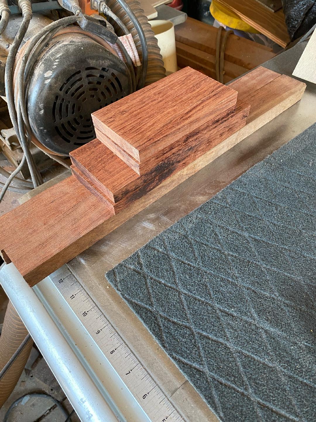

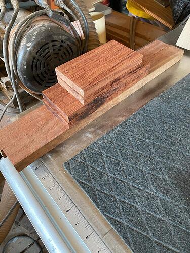

Bubinga is the main one. We picked a rich red/copper waterfall figured piece. I wanted redwood but forcthe use it needs to be stabilized and i didnt want to do that. Maybe this will make me miss my Atrium less.
The other is birch, at least the pieces on the left. I admit the ones on the right look a little more like fresh cherry or maple, hard to tell since its a quick low-rez pic and it may be for another project.
But the “B” woods are mine!
All cut down and should be here in a month or so. The builder has been very forward and transparent with progress.
