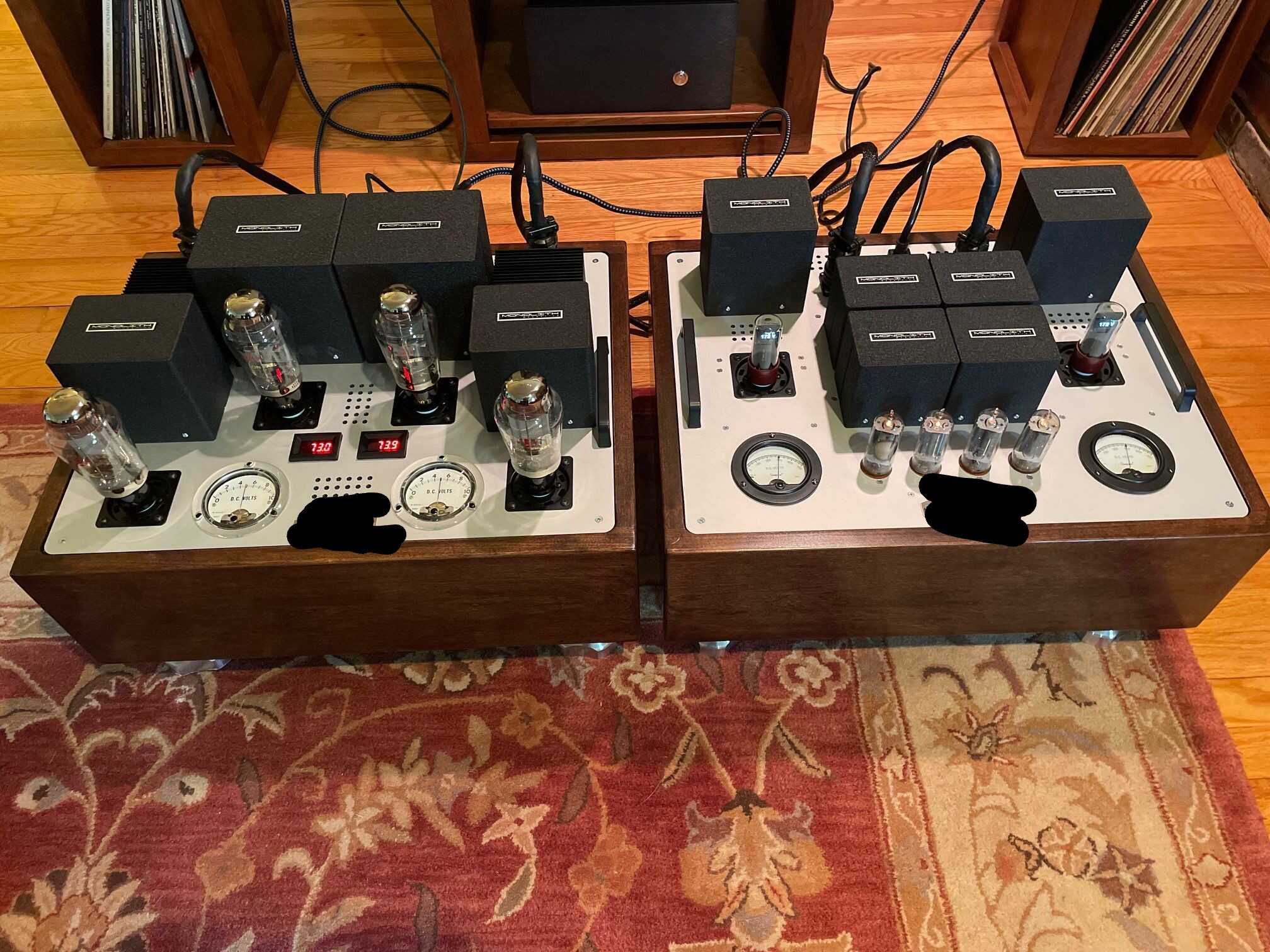

This is a pic of one proposed design.

and you are absolutely right! The C3g does look really cool naked. ![]()
Well, here is a pic of what I’ve got on the bench right now, a Line Stage in progress…, your amp wouldn’t be too dissimilar from this (aside from being flipped)…
Yep, nothing to hide…, I routinely post “gut shots” of these pieces. Full transparency. :)… even the indicator lamp has its own discrete regulated DC power supply…
The tube socket mounting/isolation plates are of my own design as well. Good stuff.
