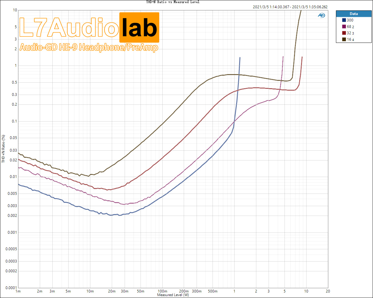

This is the more important one IMO. manufacturers almost never tell you what their power rating represents. In the lower end its almost always peak output @ the stated ohm load @ 1khz @ 1% TDH but in the higher end its really all over the place. Mass Kobo (and a number of japanese companies) use sustained @ the stated ohm load @ 1khz @ 0.01% THD. This is why some japanese amps seemingly have more power on tap than they do.
For example, the difference between these measurement criteria is the difference bewteen the AudioGD Master 9 having 9 W of power at 32 ohm (1% THD) and 0.1 W of power at 32 ohms (0.01% THD) and thats not even bringing up peak vs sustained power
