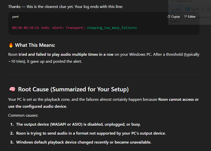

06/30 09:59:51 Info: Alert: Transport: stopping_too_many_failures
06/30 09:59:51 Warn: AddTopLevel: win_alert(3421)
ChatGPT says this about the logs:

The fact that it’s checking for updates and getting back appropriate no update required messages, means that it’s communicating out to Roon and your being able to access the local Ropee page means that you don’t have network issues. That’s a nice step one.
Now you’re looking at software.
The other big reason Roon has the issues you originally decribed is it not being able to see an audio device (DAC). So as chat GTP suggest, set your local machine to use Wasapi for all default audio.
If you’re using your PC as the Roon server that complicated things and makes your local settings even more critical. I can’t believe reading your whole post again that no one asked you which version of Roon you were using. lol So much for letting people on the internet help. lol should have been the first quetion I asked. Derp.
If you use the PC as both your server and remote, the machine is running two separte Roon instances and to put it as short as possible.
You’d want Wasapi for local playback using direct playback complicates things alot.
