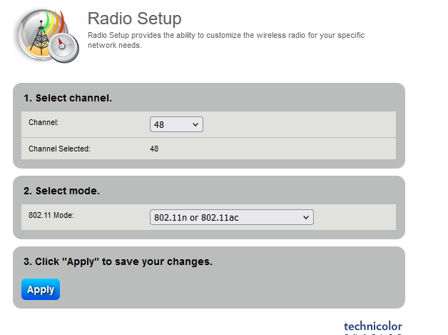

Here is the channel setting not sure if I should try a different one?

The channels aren’t actually all discrete near by numbers overlap.
If you want to try a different one, try 1, whatever the maximum is and exactly in the middle, if none of those solve it, it’s likely none of the others will.

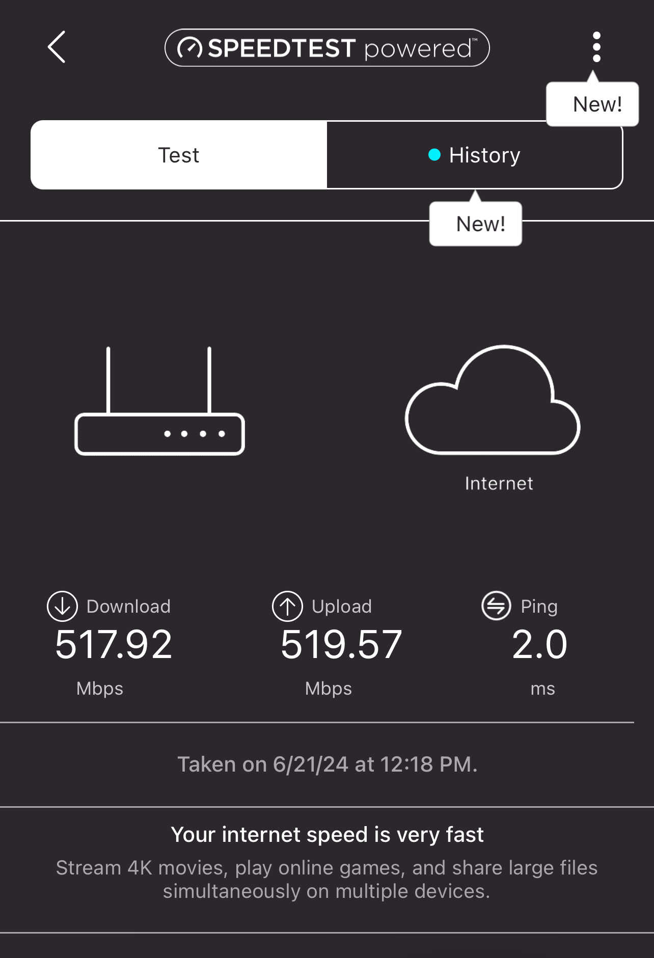

Did a few speed tests and seems pretty decent this far. Now need to test signals strength throughout the house.

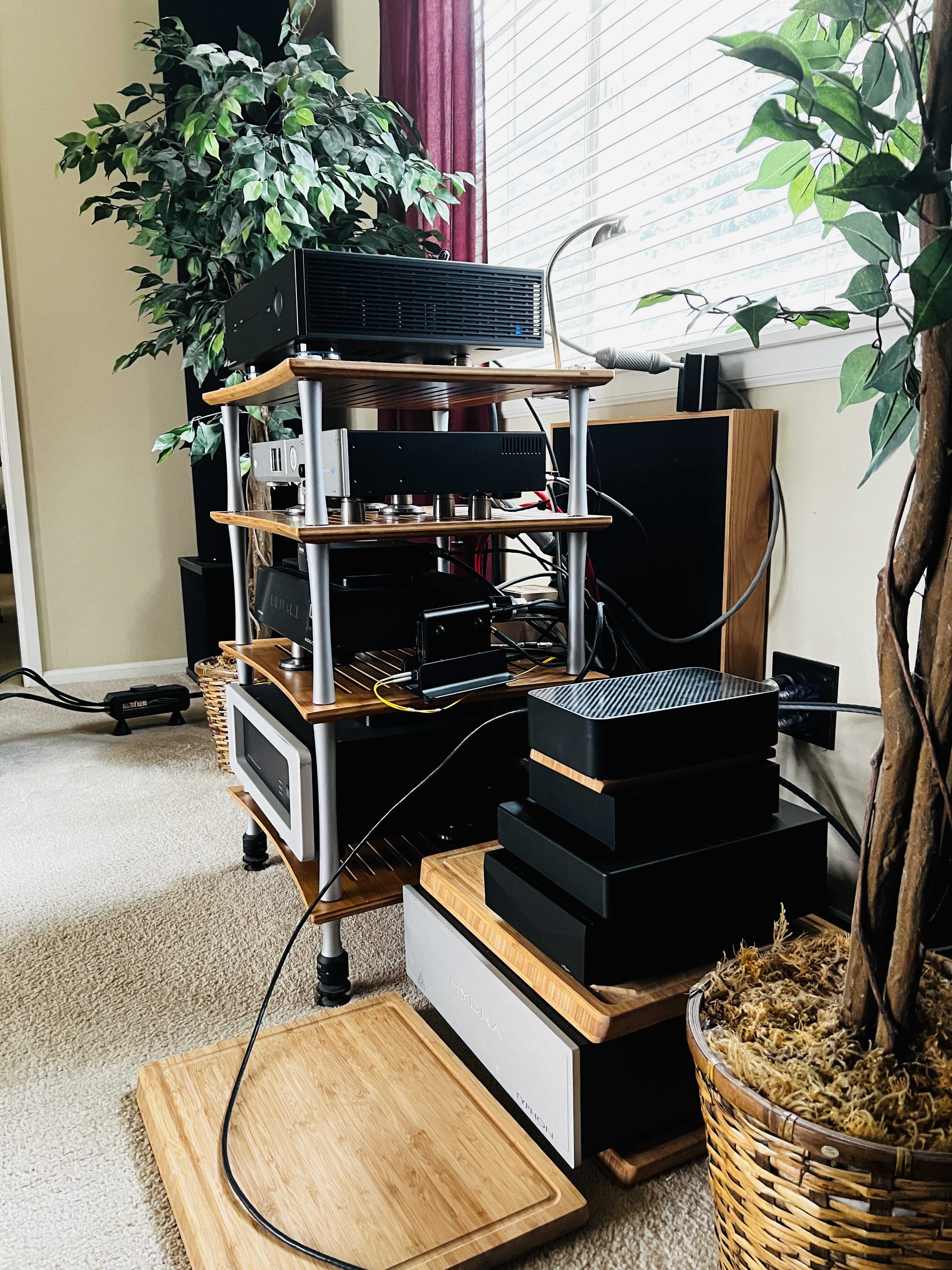

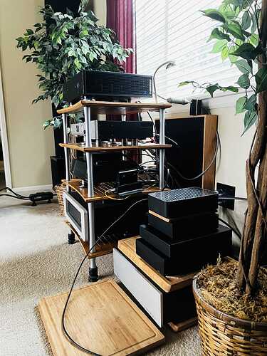

(Switch stack with Synergistic Research switch UEF, top, Network Acoustics Tempus, Innuos PhoenixNET, bottom, sitting on top of his Shunyata Typhon. EtherRegen v1 is on the adjacent shelf)
