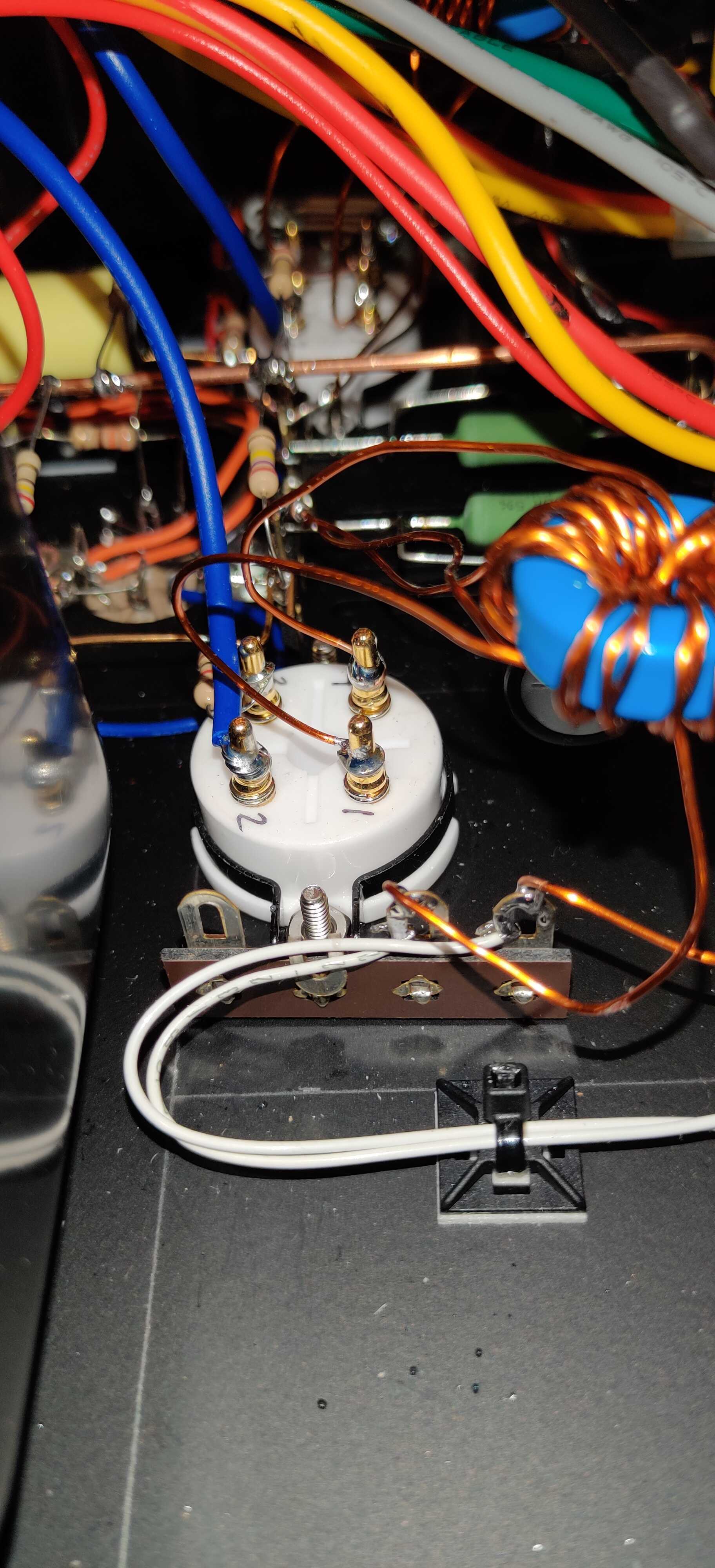

Yeah that’s some type of resin/epoxy that came off.
Agreed, looks like epoxy to me, it’s probably fine, the only things that could really happen are a wire broken off, or the choke physically hitting and damaging another component.

So to update. It looks like all the small things i was worried about were just screws that loosened during shipping. A few twists of the philips head later and it is all buckled up.

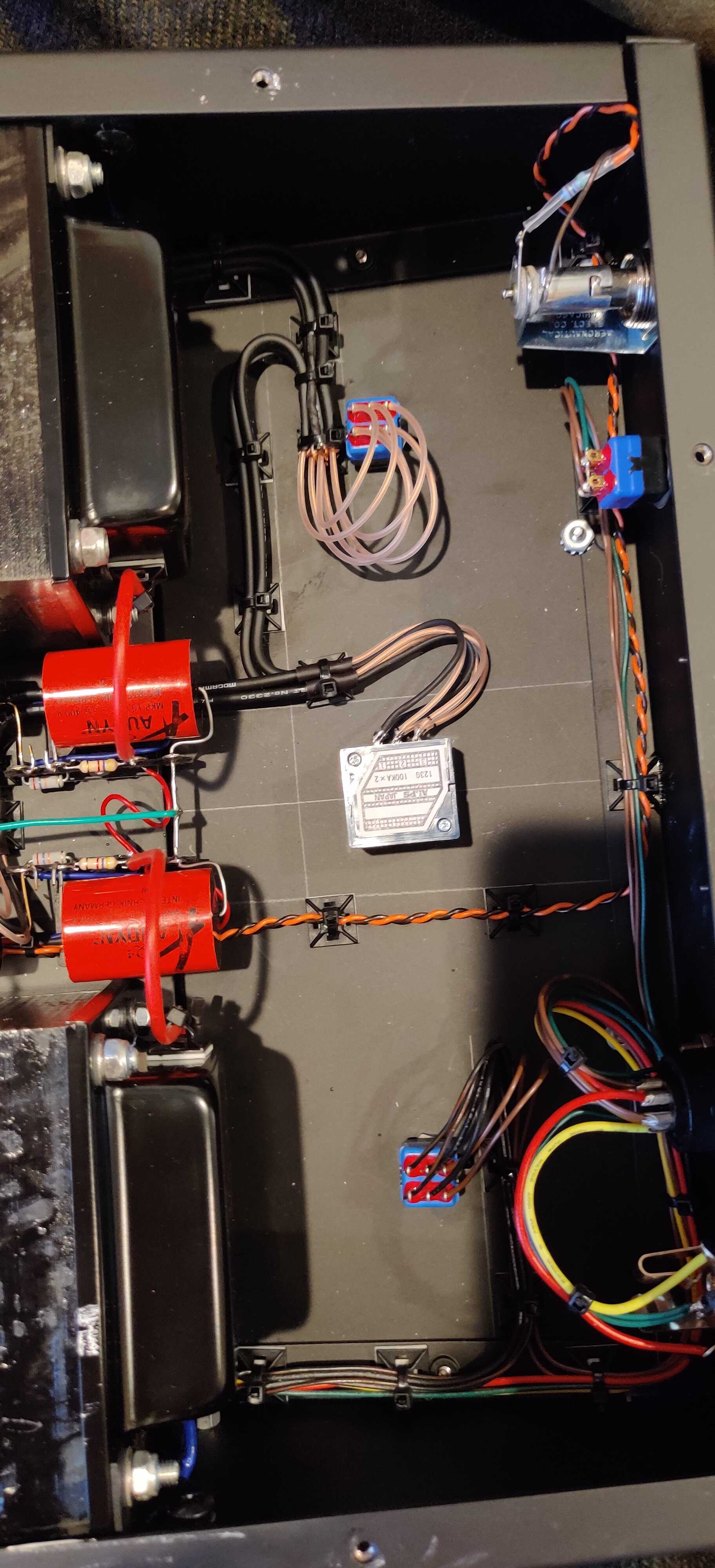

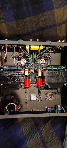

Some inside pics:
A deceivingly simple design. Things like the pot could be easy upgrades. Many rave about the TDK, and I wonder what some premium caps can do.
Almost all screws were loose from shipping despite the huge amount of packaging that was around it all. Even the 300Bs insert sleeved were really wiggly. Craig said that is mechanically ok, and you can see how it is via the wiring underneath. He also mentioned that they are either rivet pressed in or they can be tight ed via bolt underneath and i can pop it open to check. So mine are… riveted… There is a washer type thing that spins but unless i replace the socket then they are forever very loose. Im thinking of maybe looking at a thin rubber or felt washer to take away the play.
