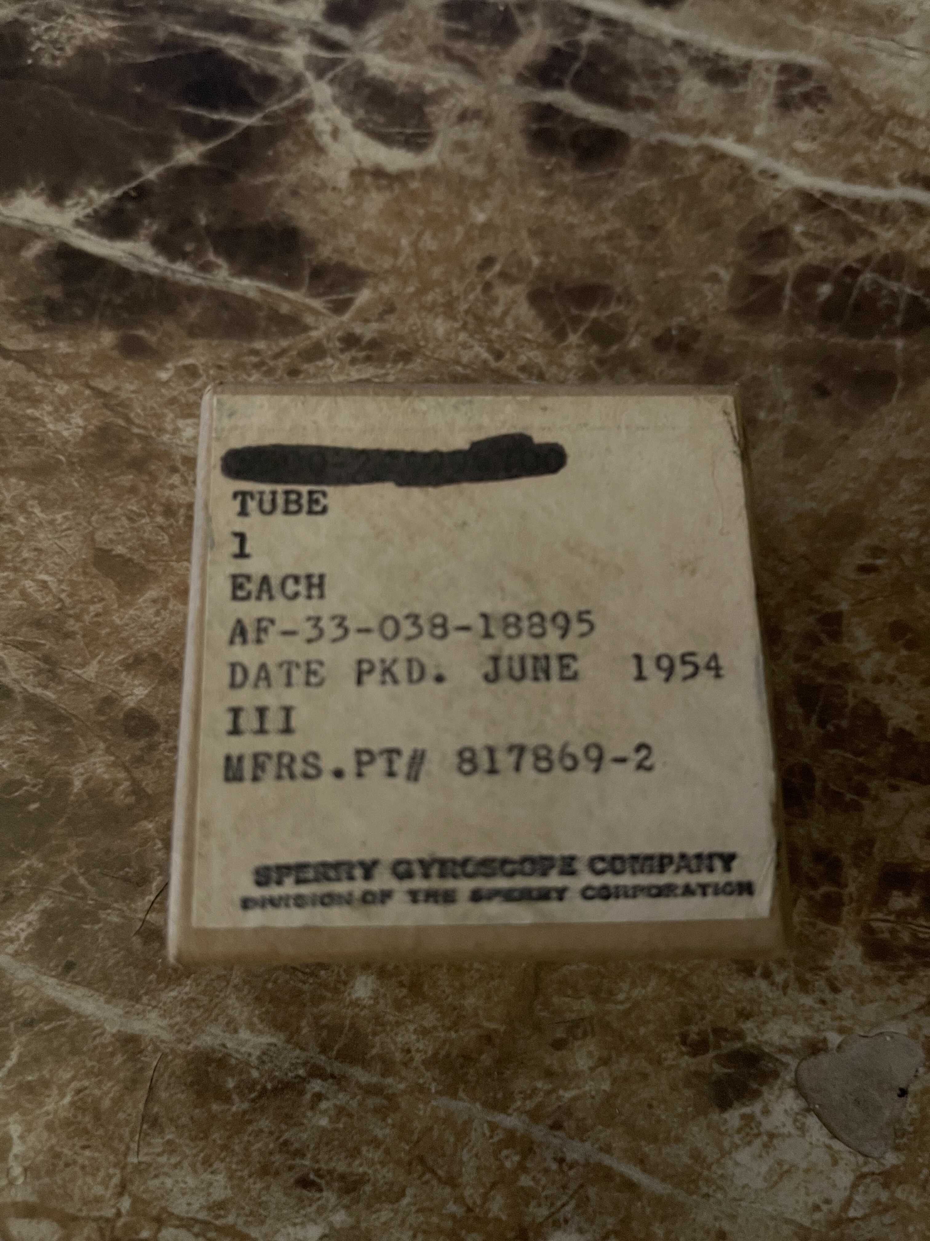

Tungsol was like a scifi lab with tubes, especially with their Chatham stuff. I know his site says it us better, and i wanted to grab one but i want to try the WE before i go deeper. I do like they are sperry gyroscope tubes. Those were legendary gyroscopes.
I find the bendix to be similar toned to the JAN GE he includes but better in every way. Holographic and detailed, it feels bright but i dont know if i would label it so. I got a 4 pack from that ebay buy so let me know if youre interested in one.

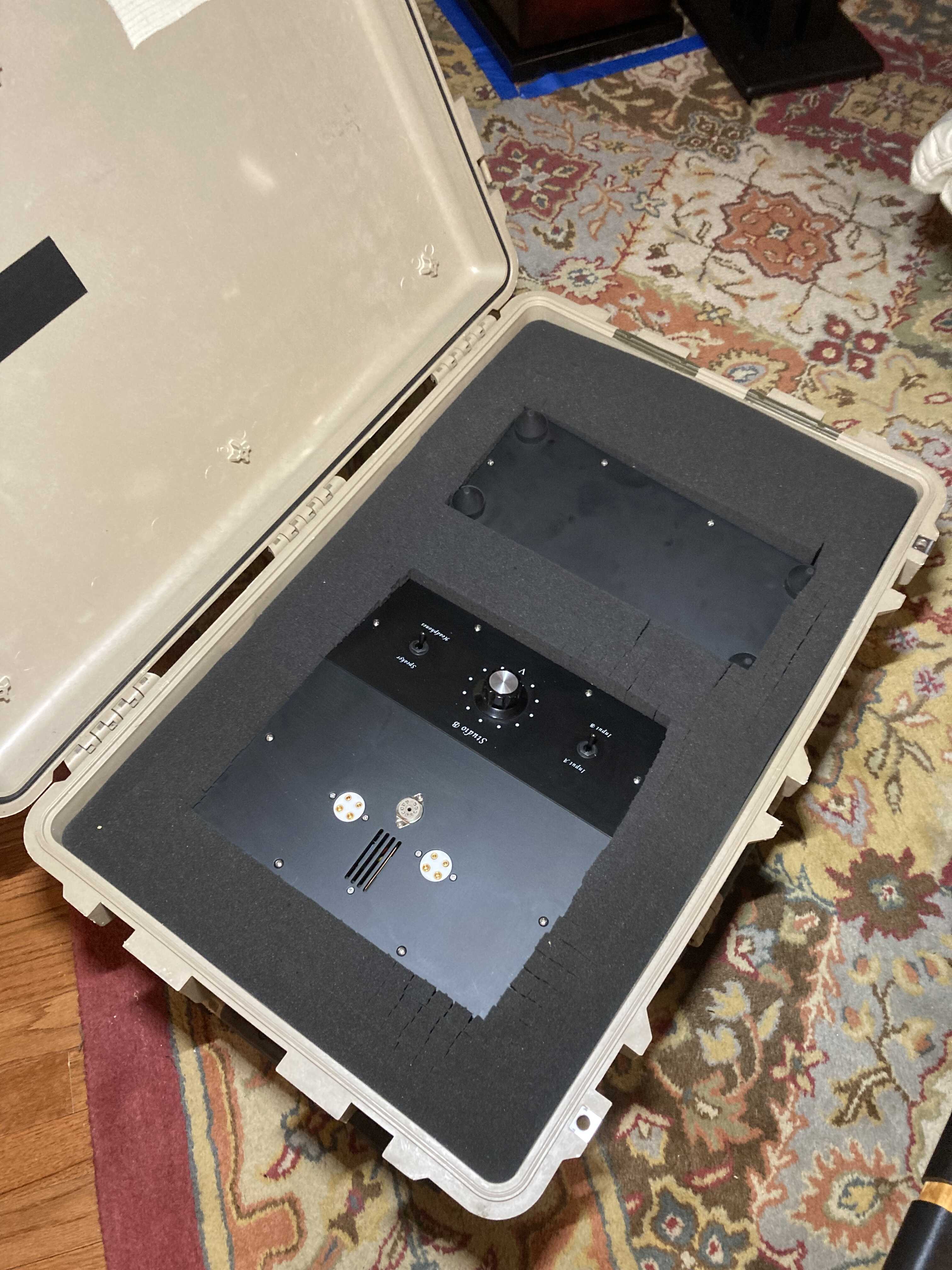

Public Service Announcement, if you are purchasing or selling an Eddie Current Studio B please be aware the amplifier does NOT travel well and can damage easily. The transformers in the power supply unit are mounted well enough to provide years of service but they do NOT ship well. The bolts used to secure them and some other pieces are quick to unscrew and the possibility of minor damage is real. A little bit of blue loctite on some of the internal screws and bolts before shipping the amplifier and power supply are highly recommended.

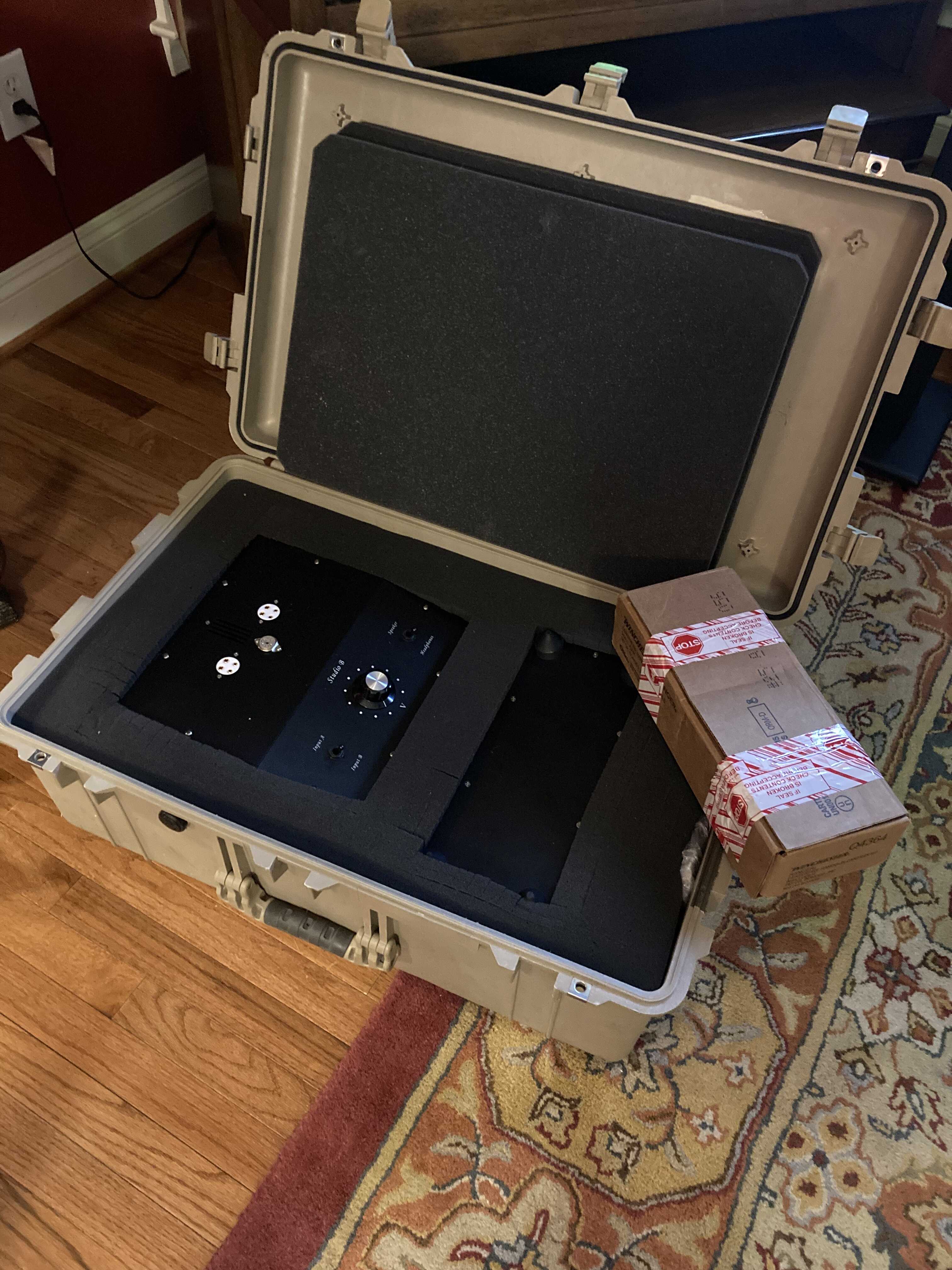

I sold my EC Studio B recently, the amplifier was basically new with less than 500 hrs on it. I packaged it in a heavy duty Pelican hard sided shipping case because I knew others have had issues and wanted to avoid any headaches w/ my buyer. I used the 4” thick pick & pluck foam ($150) which i had to purchase new for the case, I made sure all was super snug and we STILL had a loose component and a connector that popped off and cracked :triumph: :rage: :triumph:
A local technician in Chicago, wonderful man, fixed it quickly, cleanly and was kind enough to not bother with charging, it was such an easy repair.
Nonetheless, fair warning, you are best off picking up a unit local and even then giving the bolts and screws a good once over before attempting to power up for the first time.
Consider yourselves warned and informed.

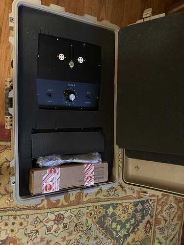

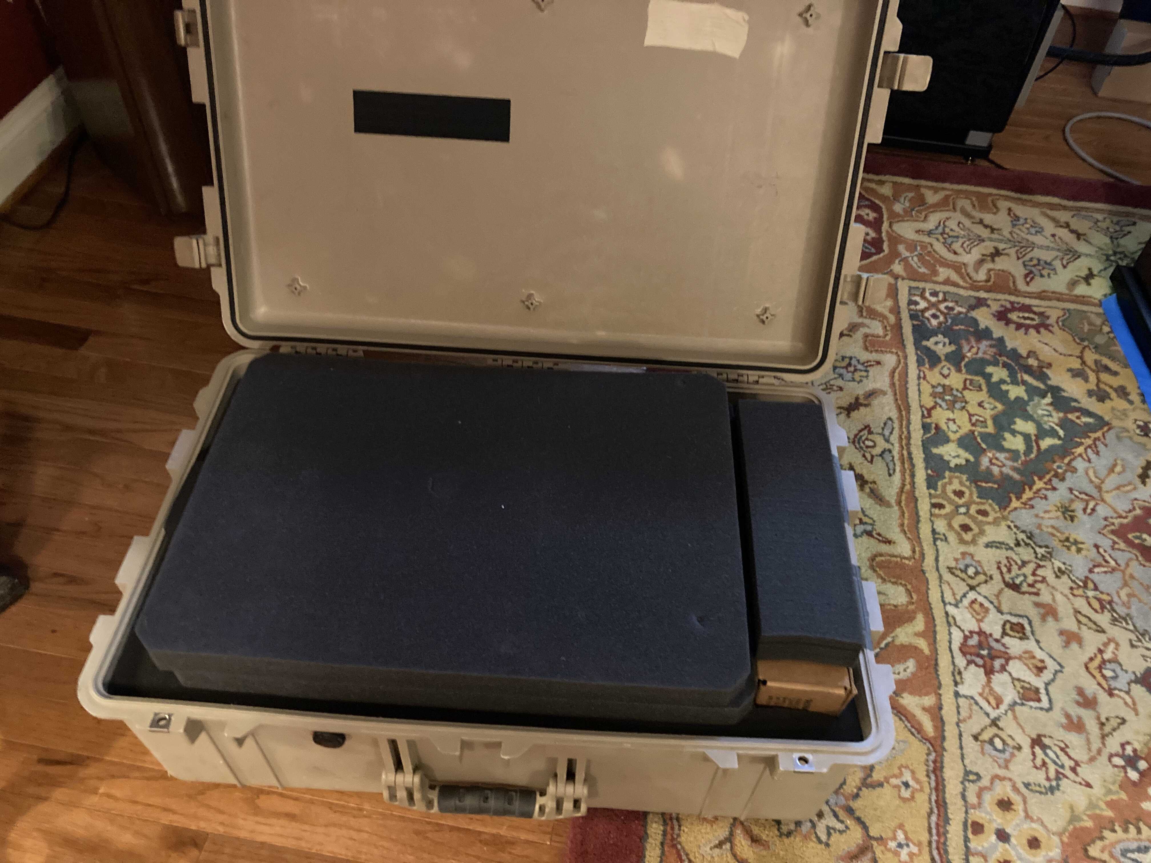

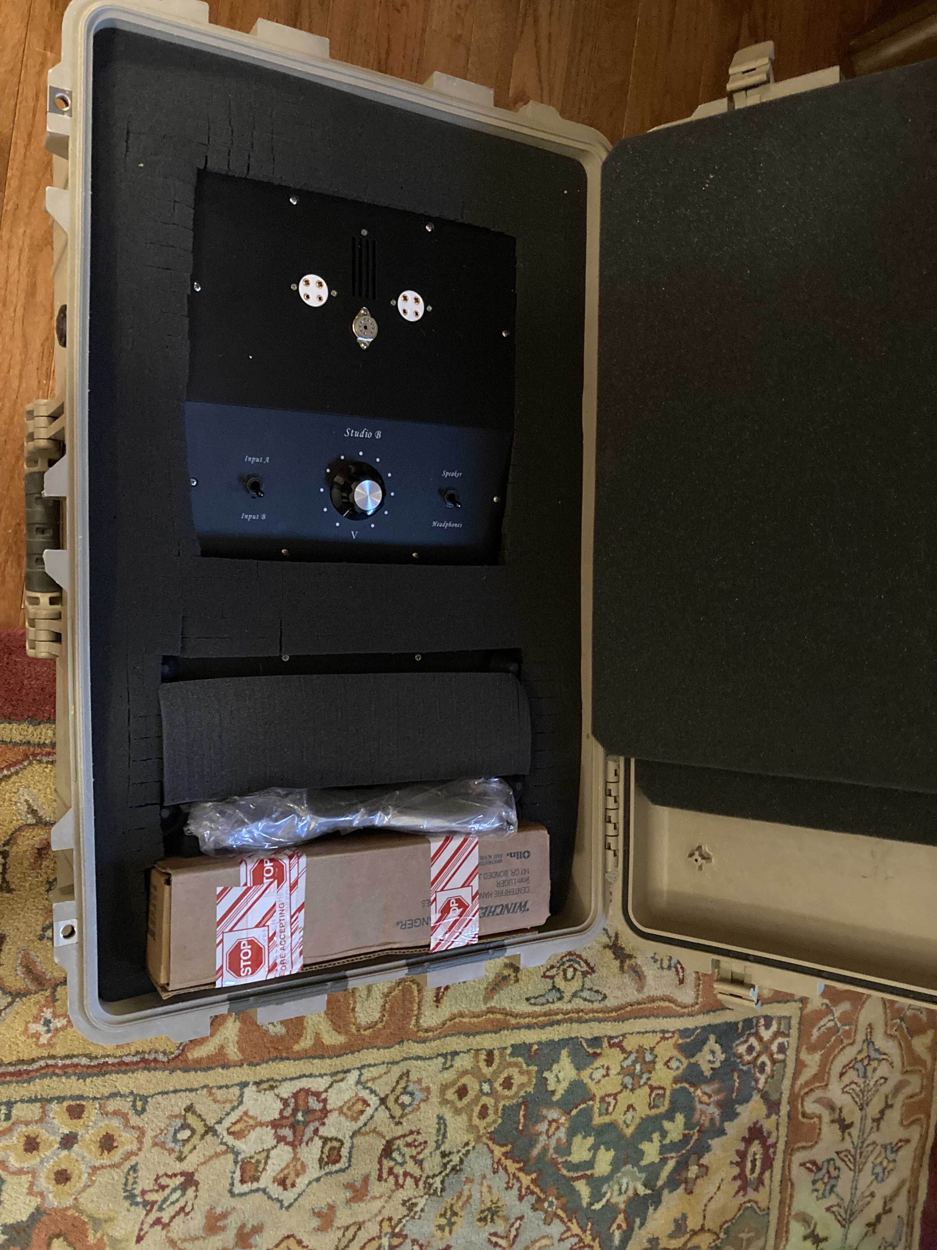

This is how i packed and shipped the amp, it was bomb-proof but not free of g-forces it sustained while on its travels.
Damn, immaculate packing, that’s pretty shit it got damaged regardless, that’s good it was able to get repaired though
A+ on packaging Nick, amazing job and doesn’t leave room to think it can be your fault somehow.
Thank you @orrman, there is NO FAULT in this or anyone’s particular situation w/ the EC studio B. This is the 3rd instance-noted in this thread where one of these amplifiers has arrived with slight damage due to shipping. Both @Souldriver and @Towa if i am not mistaken had to deal w/ the same exact issues which is why i decided to overpack and STILL had to deal w/ an unhappy buyer who was worried that he might not be able to get the amp operational.
This is fair warning to all, I love the SQ of the Eddie Current product but 3 similar and separate unrelated instances should be considered a warning to folks to be careful and take extra steps w/ these amplifiers to help avoid loose parts flopping around. The bolts need some loctite for shipping. :muscle:
