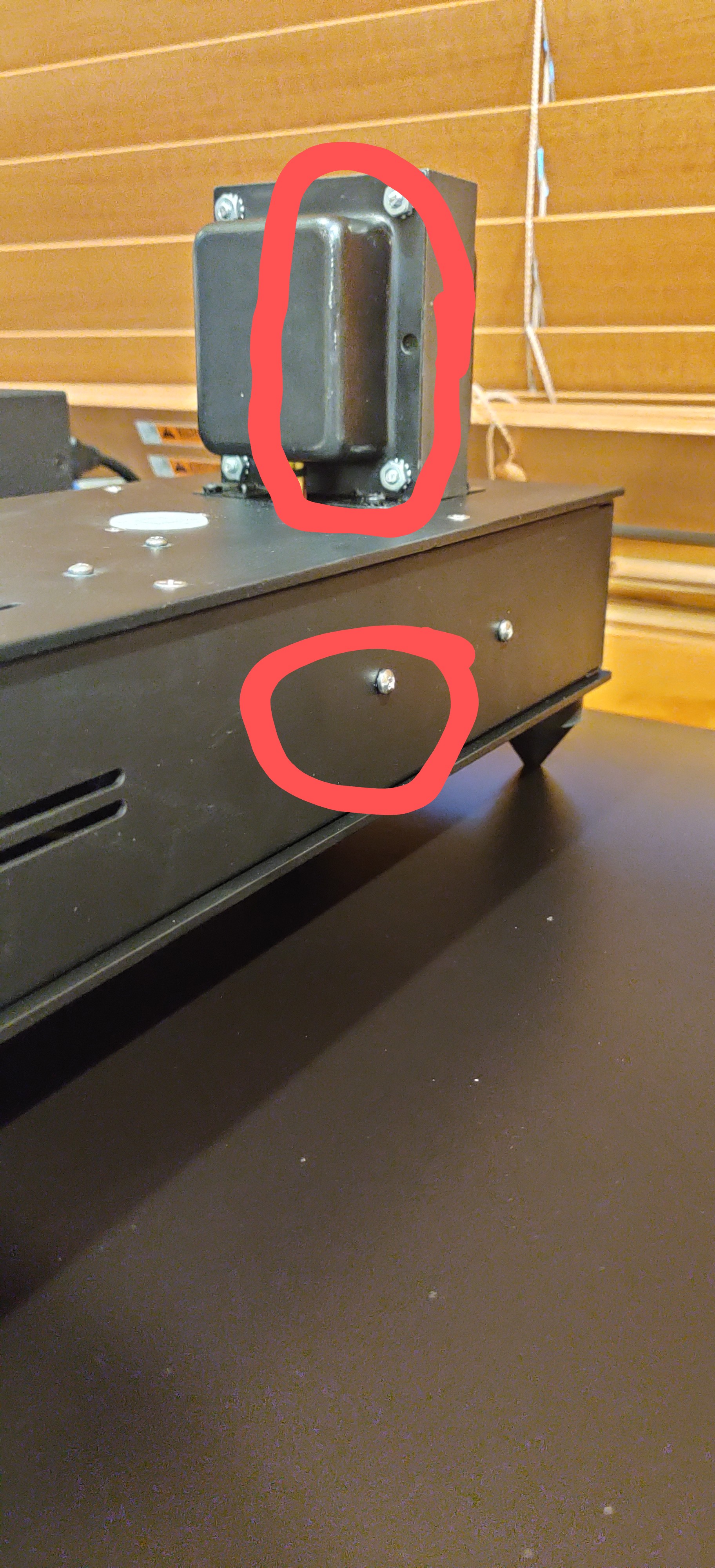

I think unfortunately there may be an issue with the power unit.

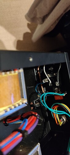

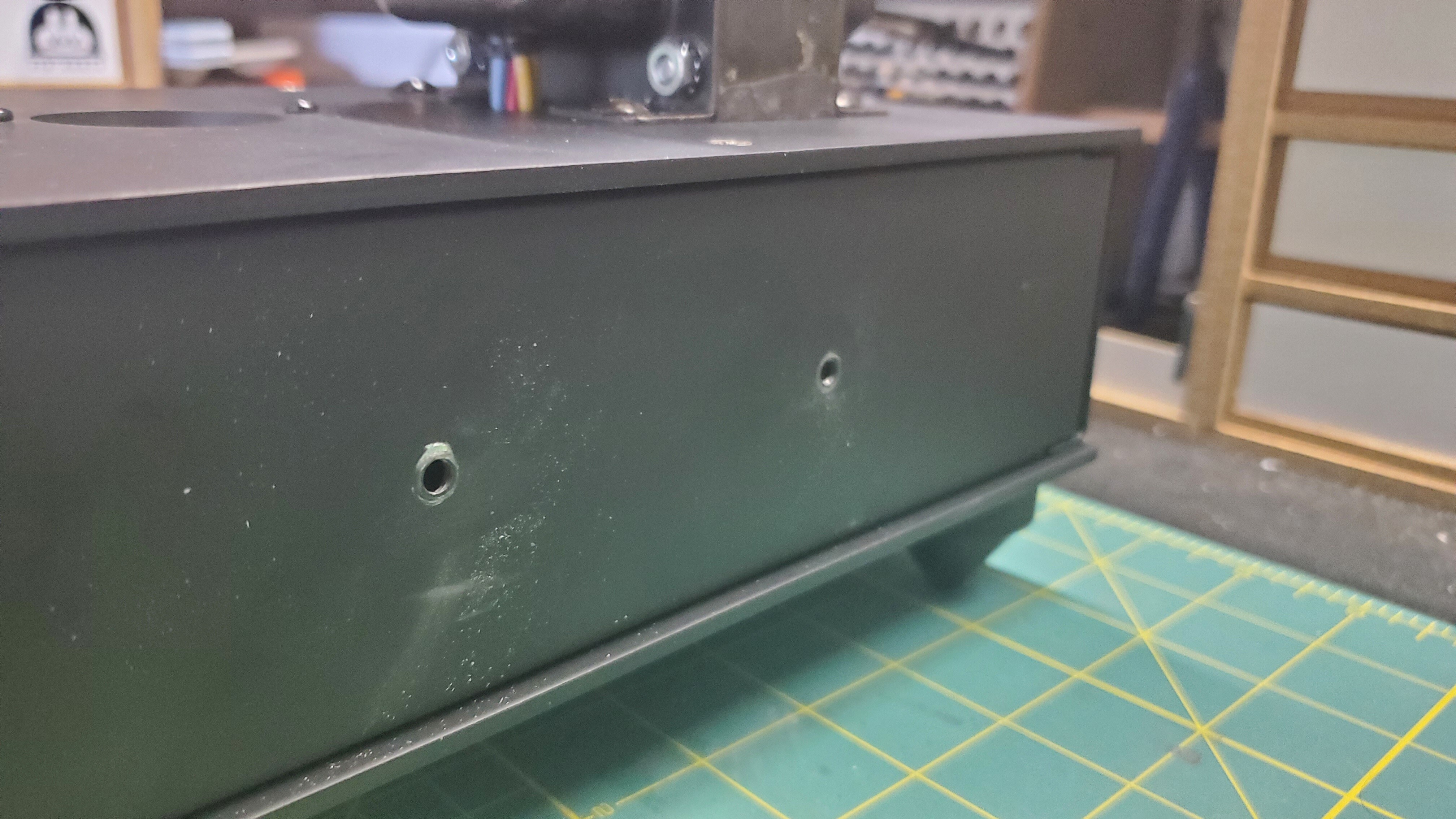

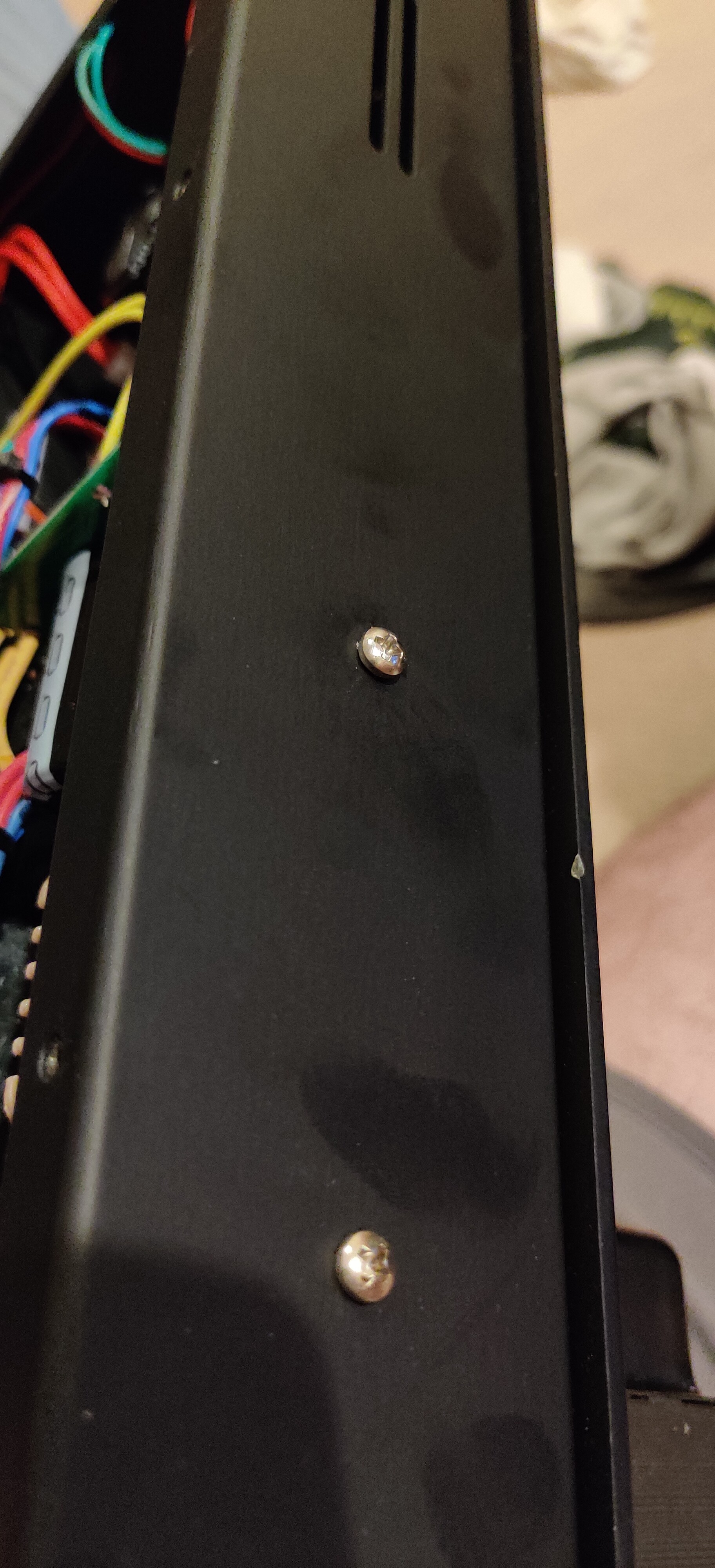

I got some time to unpack and set the amp up today. Immediately when i picked up the power unit i felt a heavy thunk inside and a shift of weight. There was also what sounded like small pieces or sand plinking around. Both of this continued whenever i would shift the unit. I also see one of the screws on the right side was loose and bobbing in and out (see attachment). It seems stripped as it is not able to be tightened. The transformer paint is scuffed but not sure if that is normal.
The amp itself seems ok, just a few white marks and scuffs which i assume is from packaging. The rectifier tube box was ripped open but the tubes seem ok.

I think @Towa had a choke or transformer come loose inside his PSU in shipping, I think it was an easy fix, but I’d ping Craig first.

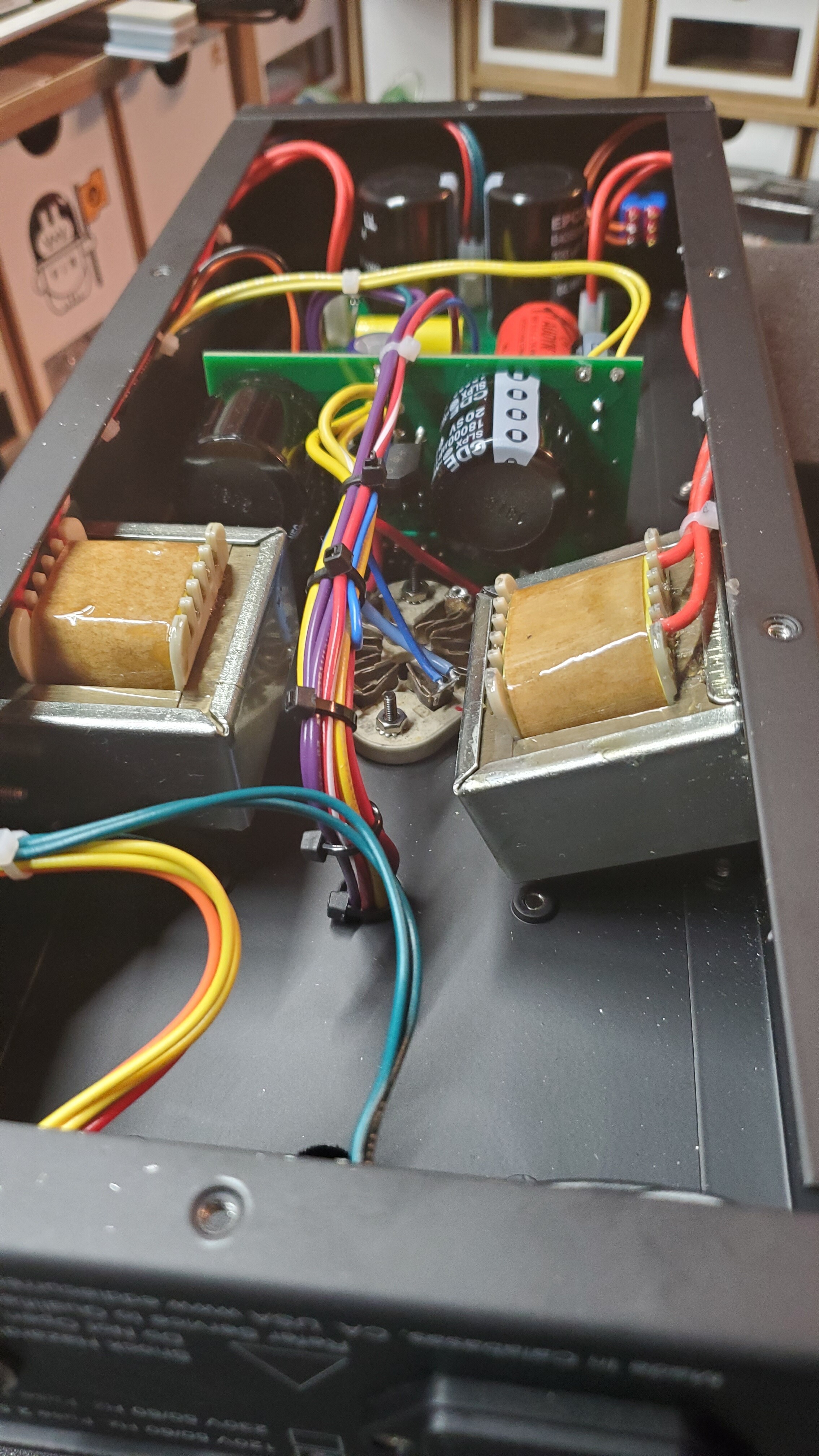

yep mine came with one of the chokes loose inside the power supply, due to shipping. I emailed Craig and after some back and forth with pictures and his guidance to open up the unit it was determined that no damage had been done and that I could either send back for repair or remount the choke myself. I opted to do the repair myself.

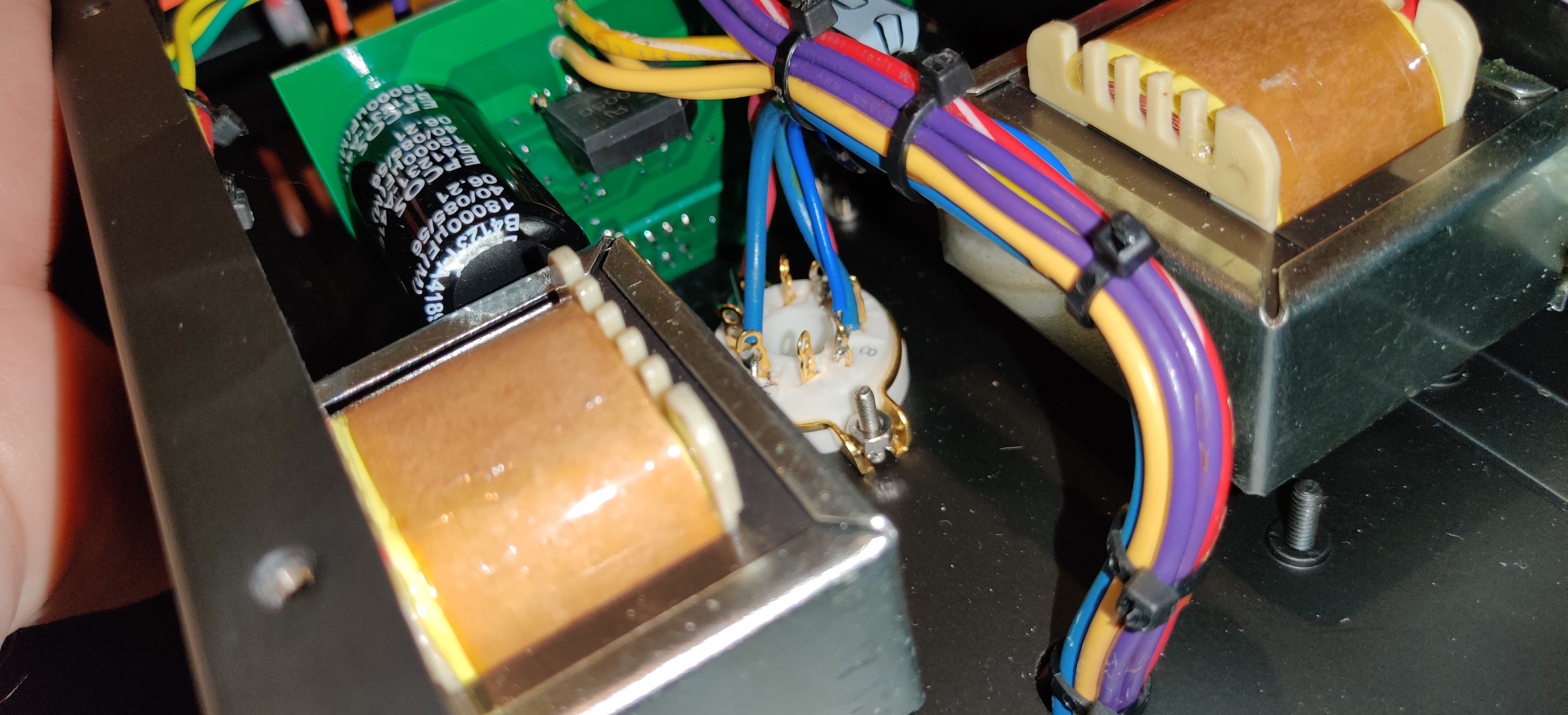

actually I still have some pictures from the repair, let’s see…

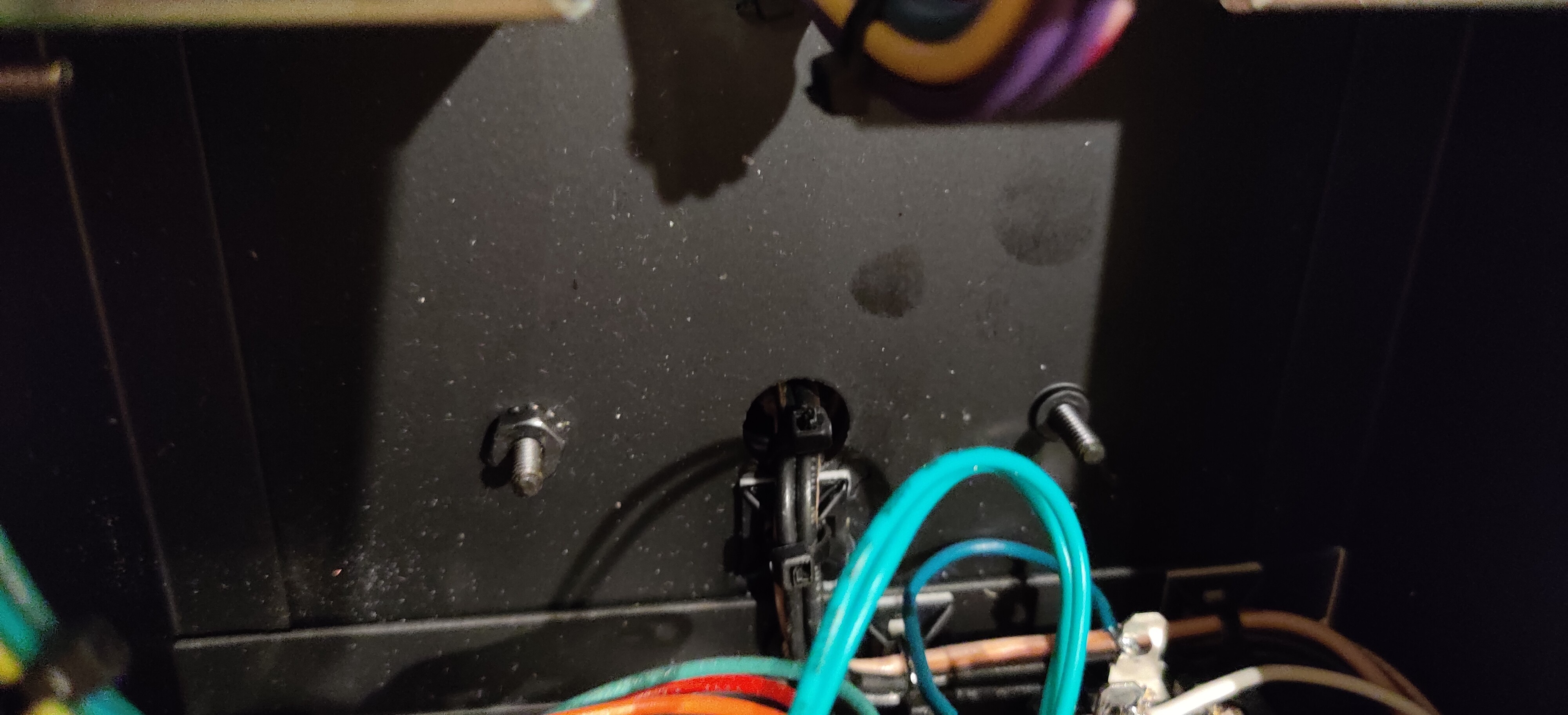

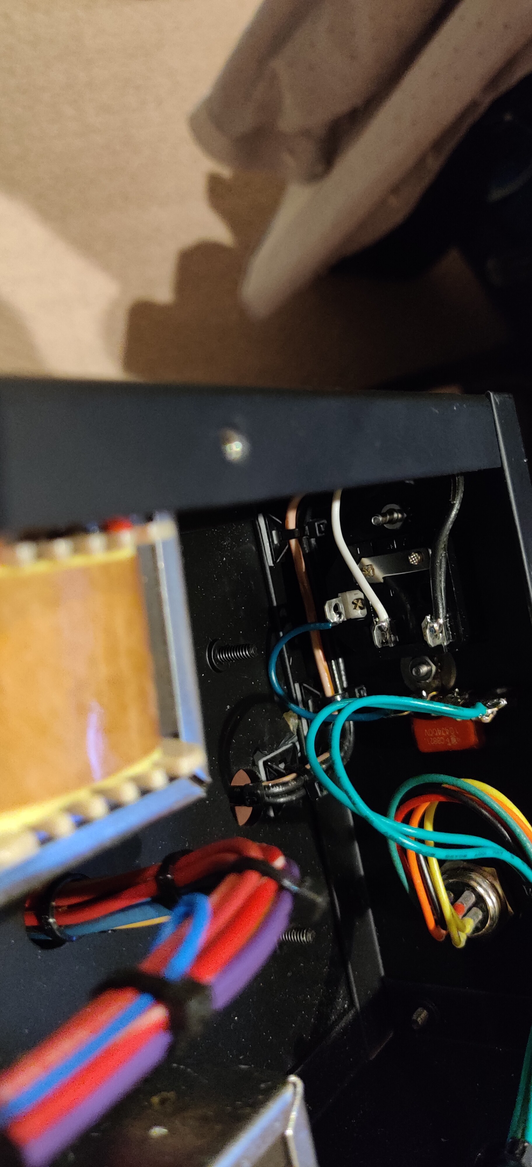

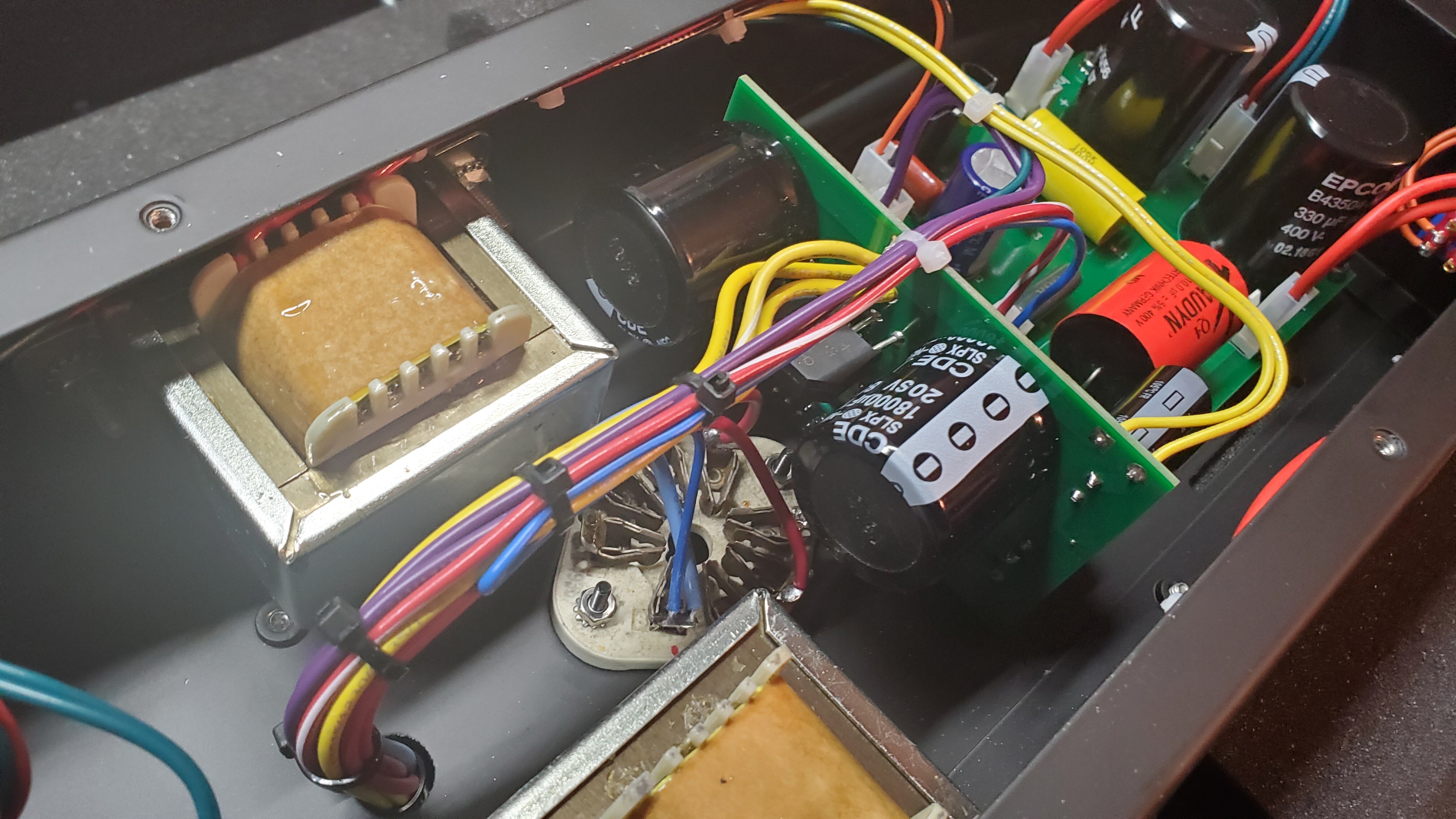

Good news. It was just loose screws. The bolts were still on so it was moving just enough to clunk around. I found a few other screws and tightened them all up. It looks like the transformer only had one bolt and lock washer, but it looks like thats part of the design?

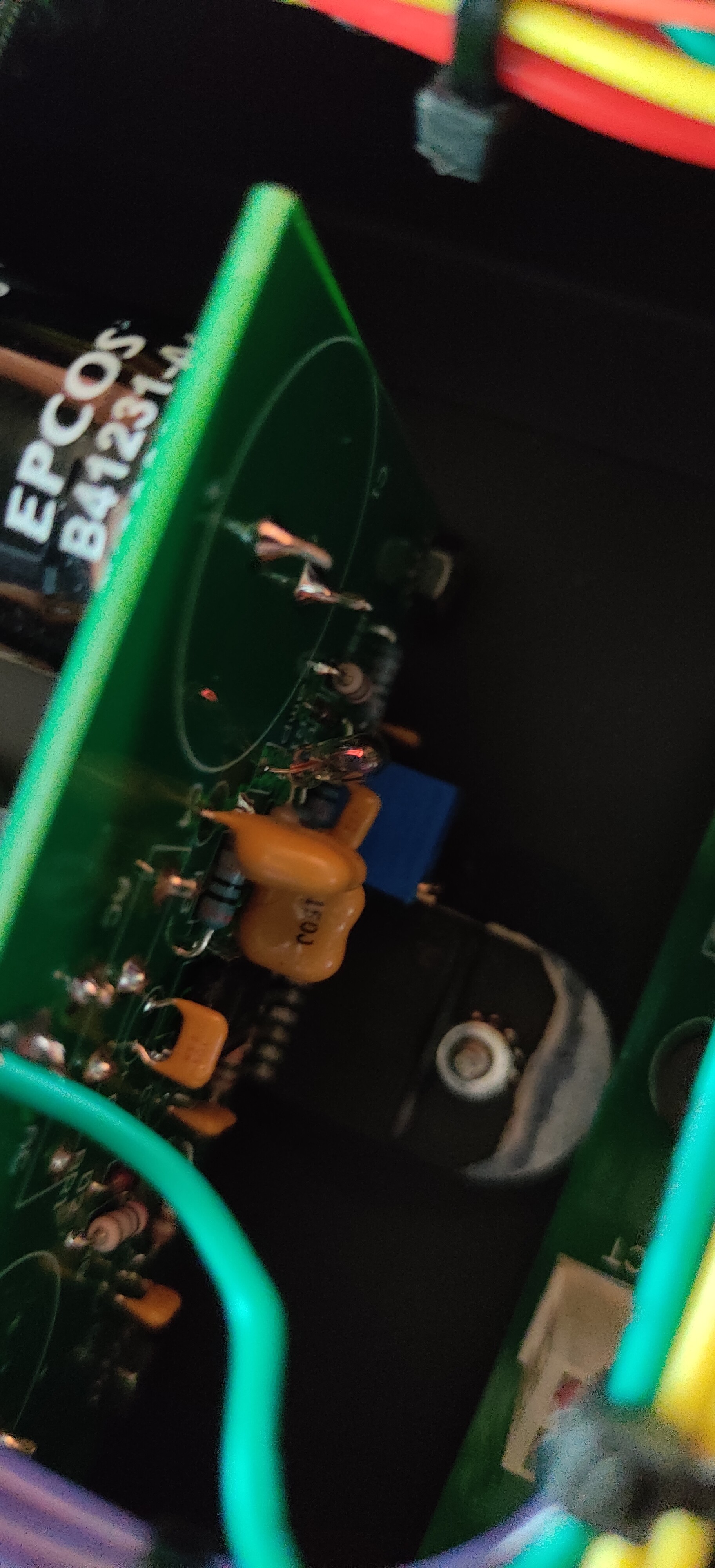

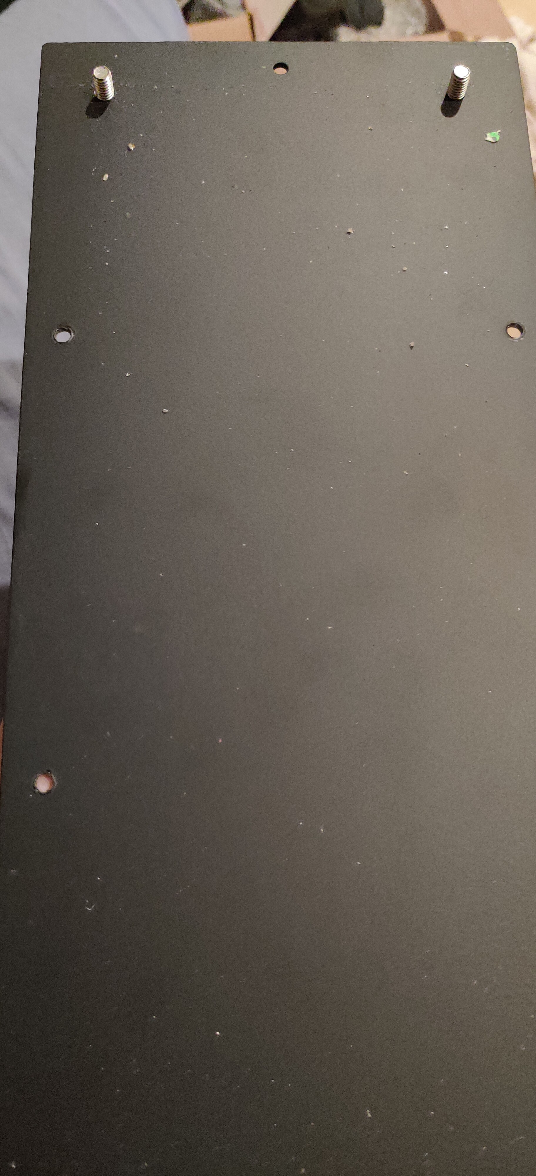

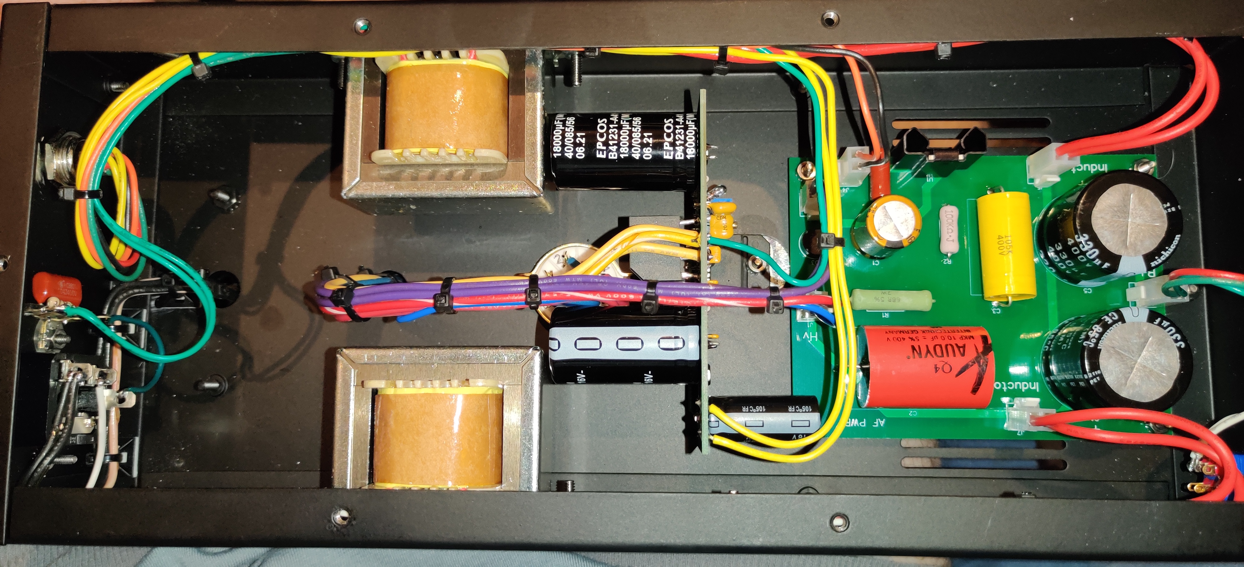

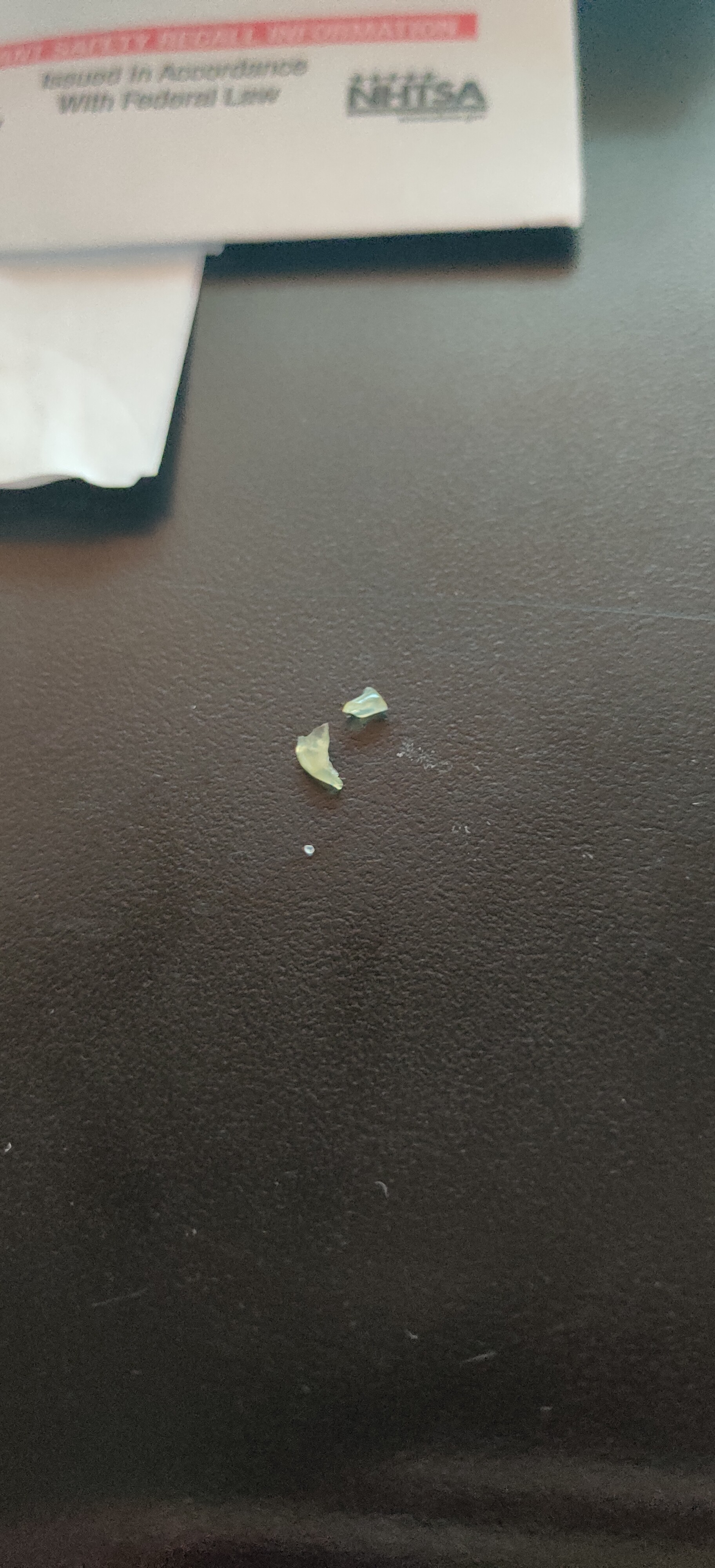

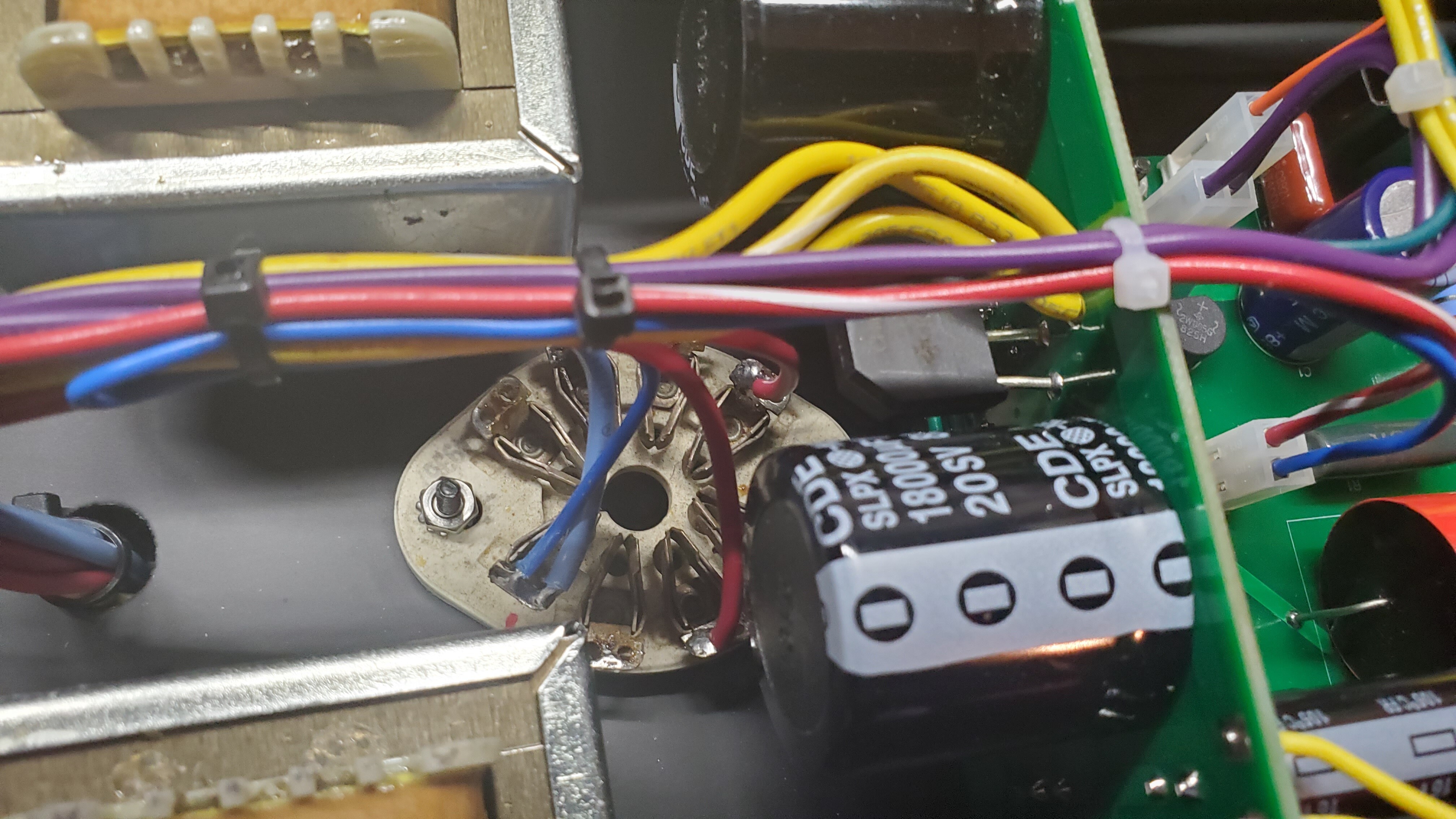

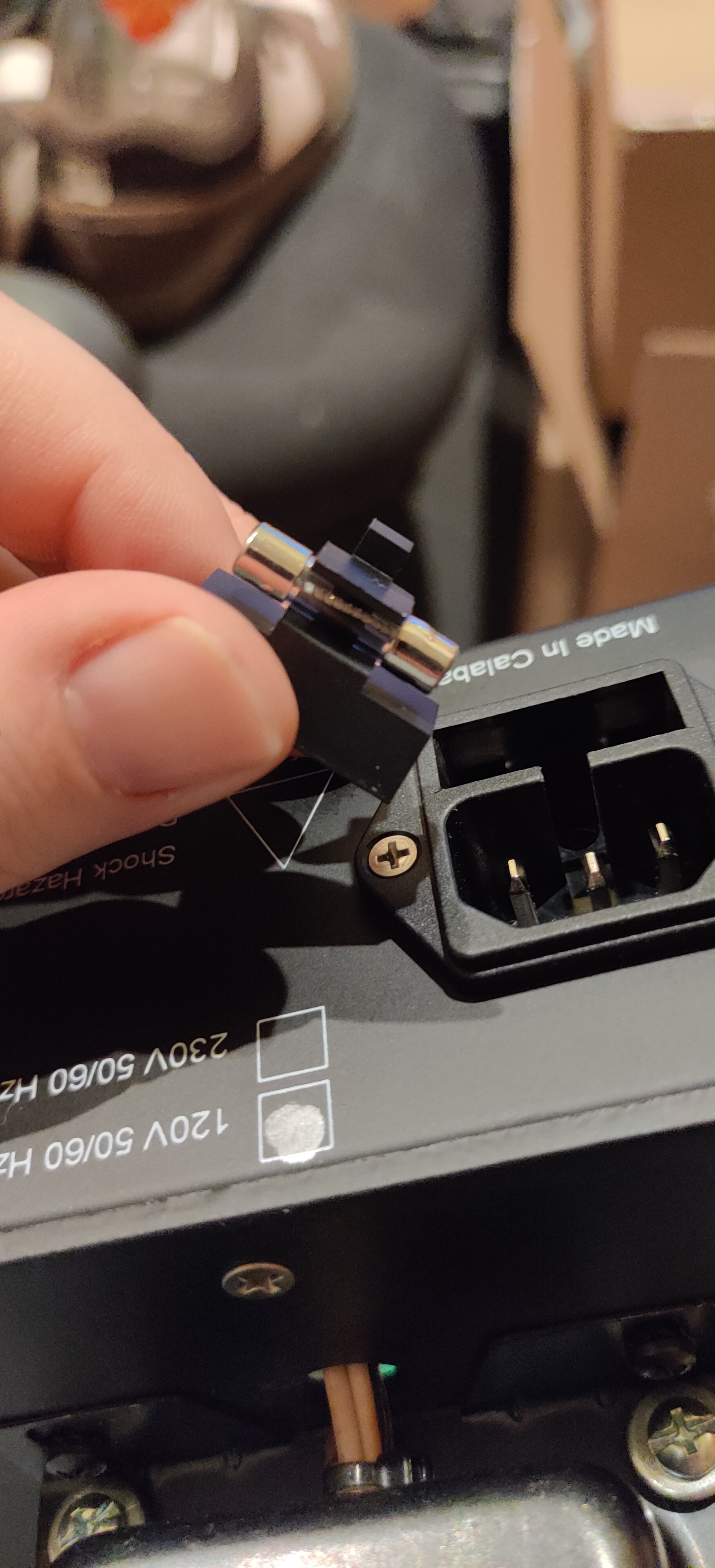

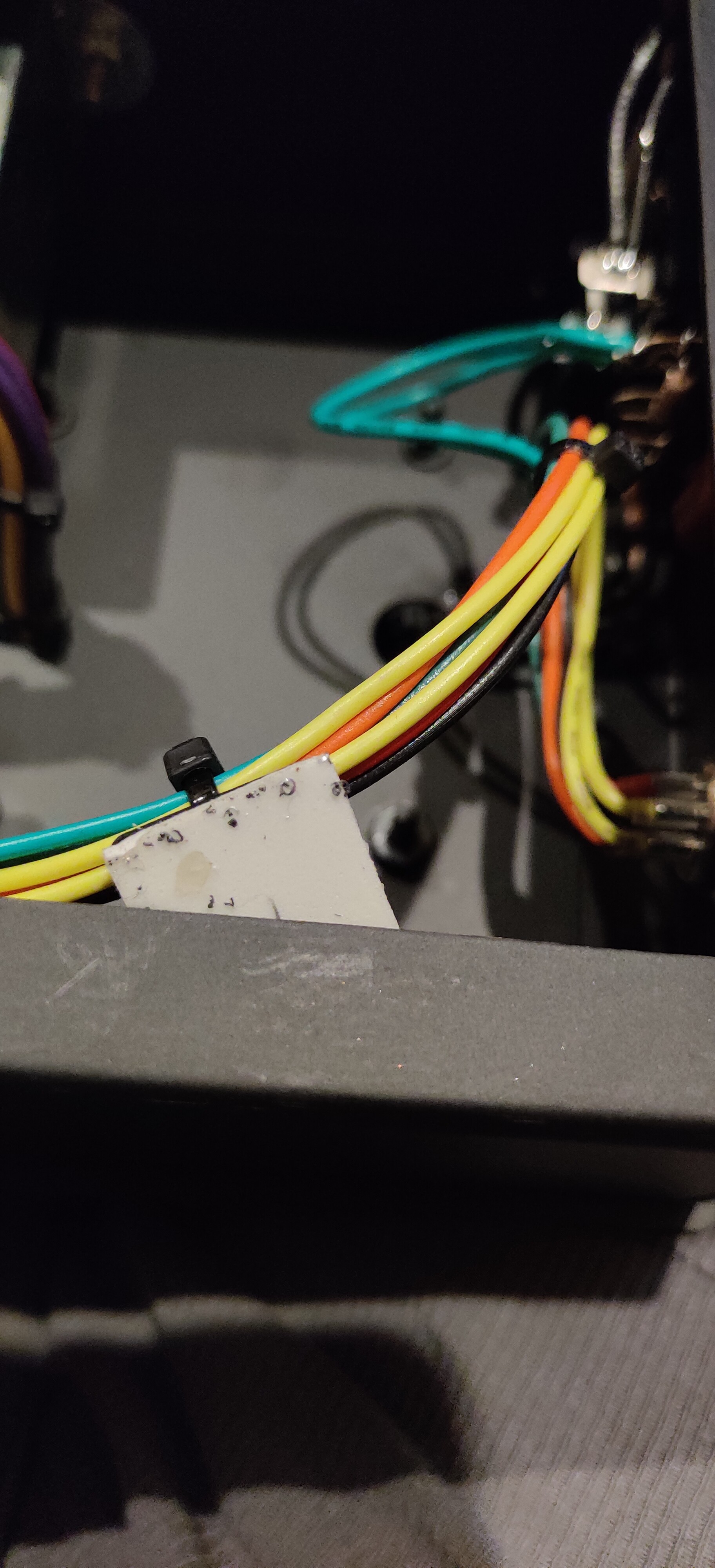

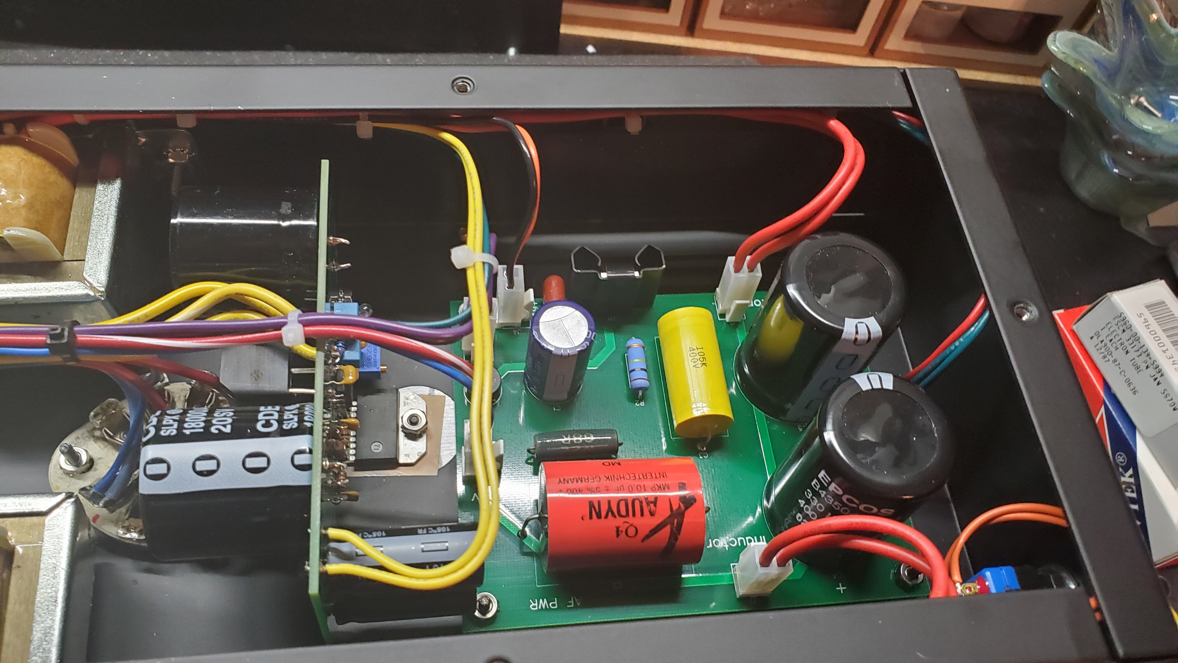

Bad news, that sound of small pieces rattling around was glass. There were a few pebble sized pieces as well as small shards all over the inside. I checked the fuse and that was Ok. Compared to the inside of @Towa 's there are some different caps (not inspiring), but I cant see anything different that may have broken on mine.
There is a dent in the metal lip on the side of the loose choke, but it was packed so well and i do not see any damage to the box. I am not sure where that broken glass is from. It was hard to photograph but the small particles were all glass pieces.

Doesn’t look like anything that makes sound was damaged.

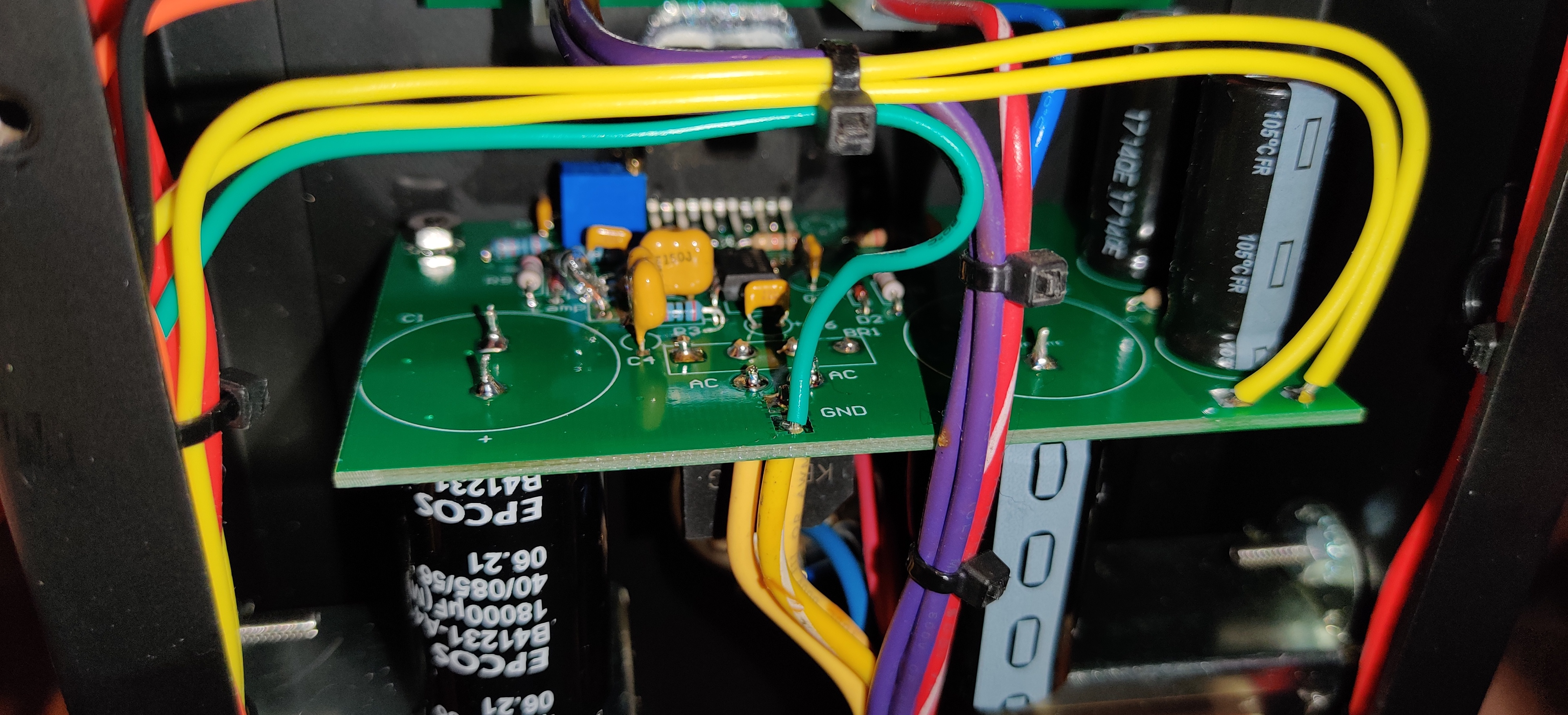

Caps change is interesting, look to be the same manufacturer, same rating, just a different form factor and possibly voltage, but they aren’t in the “audio path” there.
I can’t guess how glass got in there, except through the vents, did the tubes it shipped with arrive intact?
Hanging the chokes off the side of the case like that (and he isn’t the only one to do that) is just not conducive to good shipping experiences, you have a heavy weight acting as a lever against sheet metal, all it takes is a largish drop, no matter how well packaged it is.
Not sure either, tubes were in the other box and are ok, fuse was ok. Maybe jt was some hard resin that cracked off the choke or transformer? Nothing was in the bag it was wrapped in but it fell out the vents once tilted and was all over once i opened it up.

Pieces inside (theyre more transparent/glassy in person):
