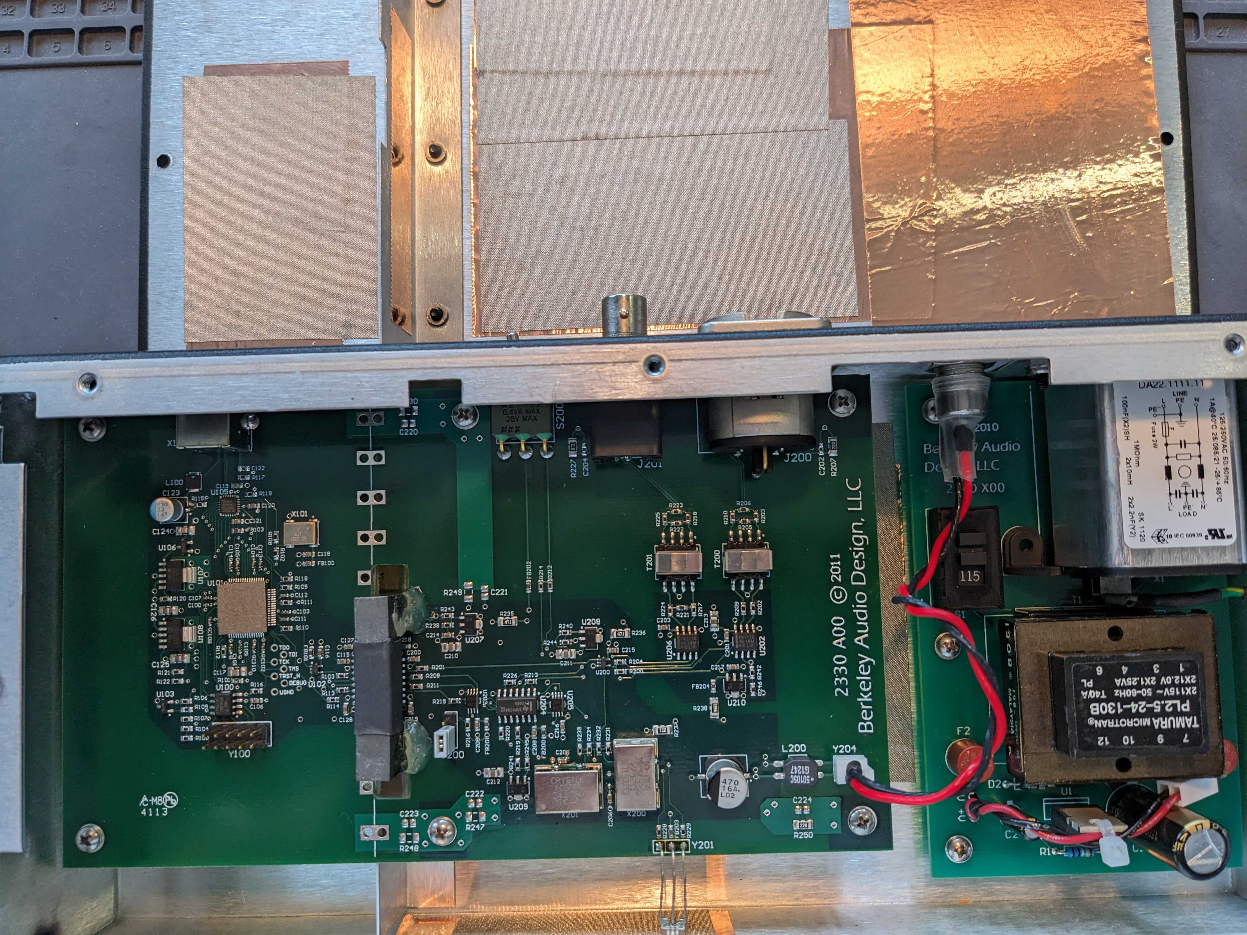

BTW if anyone on the forum is interested in doing the power mod on their Alpha USB let me know.
Includes disconnecting existing internal power supply. Installing a 2.1 mm DC jack with silver plated occ teflon coated internal power cable. Lining the case with a sandwich of layers copper and RFI cloth.
Donation of the parts and labor on me and if you want to you can throw some $ my way but the real spend will be in the form of a super duper high end 9V power supply you’ll need for it.

Is the mod reversible? At least in terms of reconnecting the internal power supply of needed in the future?
What power supplies have you tried or would recommend?
Other than the hole I have to drill for the 2.1 mm DC jack, yeah everything is reversible. I actually posted something a while back on the mod.

I did my first commissioned power conversion of an AlphaUSB for a member of the forum. Looking forward to hearing his impressions of it as I’ll be shipping it out Friday. Basically did everything I did to mine but in a much cleaner better thought out way as mine remains a prototype at heart.
That said. I didn’t take any pics of my most recent mod for it but it’s bordering on crazy. I placed a layer of thick ply plastic sheet over the right side of the unit (where the clocks reside) and then filled that area with about a pounds worth of small ceramic beads to weigh down and dampen vibration inside the housing.
I can’t immediately tell if it made a difference because I haven’t done no critical listening yet but it didn’t hurt anything that’s for sure and the additional heft is nice since the unit is very light and can slide easily on its platform while handling. No more sliding around.

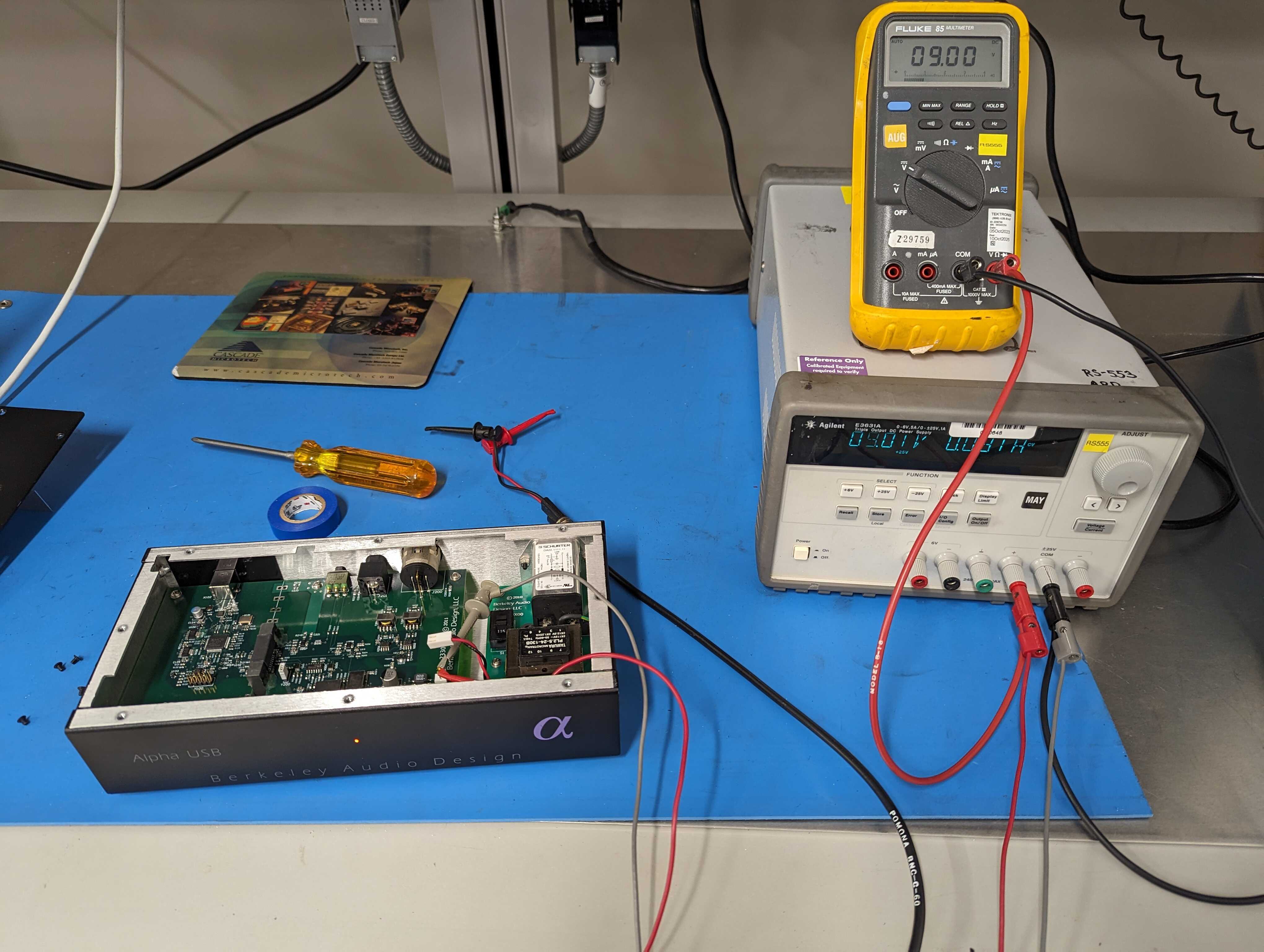

The internal power supply died! ![]()
After a few days of debug it became clear that the issue was only the internal power supply, nothing on the main digital board. It was handy to have an electronics lab at work that I could use for a little debug (shown in above pictures). I contact Berkley with the info from my investigation, and for $200 they would replace it. Not a bad price, especially given I’m far from the original owner.
But why get the stock replacement when you can just get a @dB_Cooper power supply upgrade? ![]()

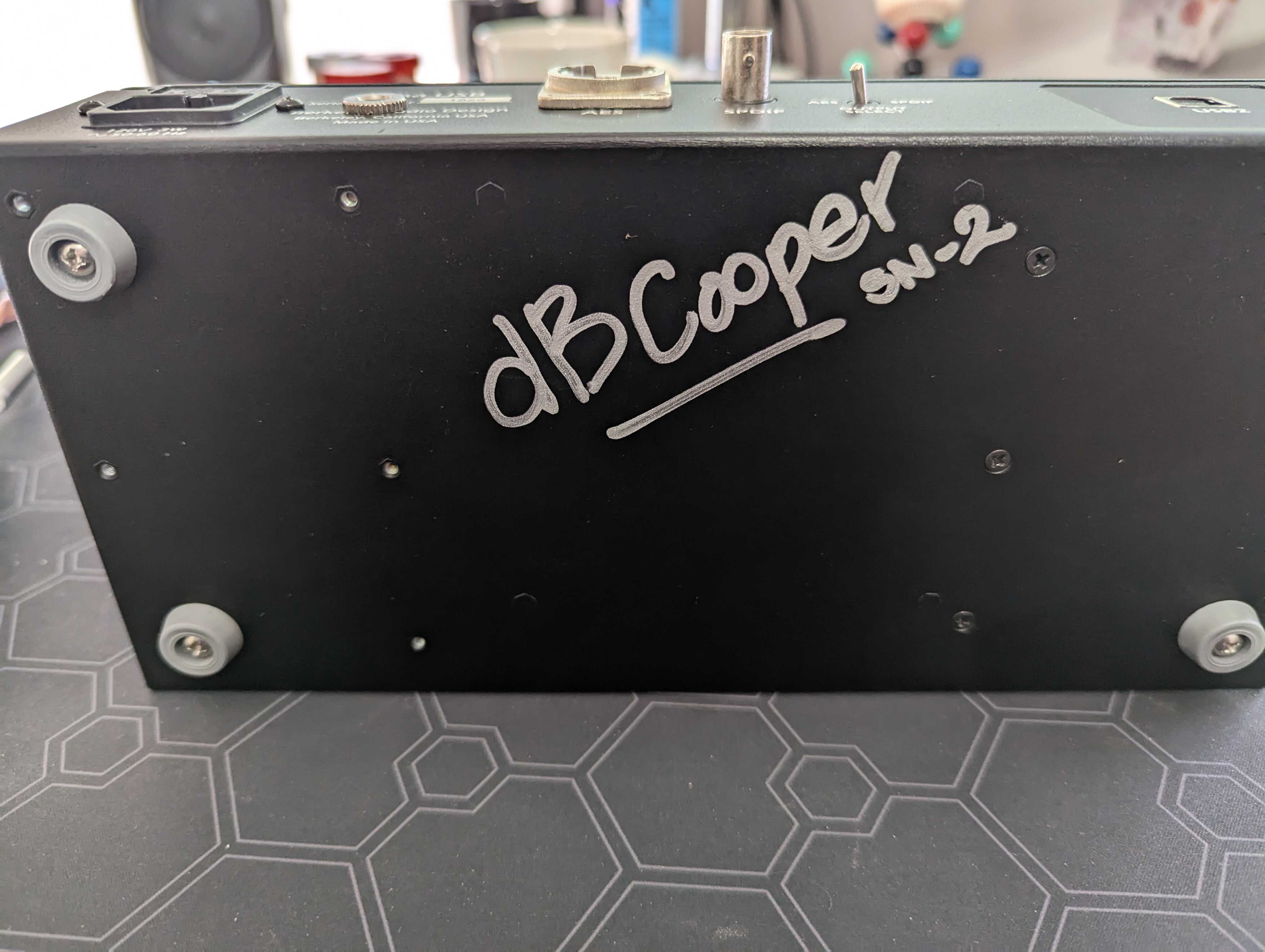

I shipped my Alpha USB off to dB_Cooper, and it came back about a week later better than ever:
With SN-2 I think I have a collectors item on my hands ![]()

this is a good one for @dB_Cooper to chime in on. but big picture, the internal power supply board in the Alpha USB is an AC to 9V DC power supply. and the 9V powers the digital board that performs the DDC function. part of the modification db_cooper made for me is to disconnect the internal AC to 9V DC power supply and run a DC barrel connector out to the back of the unit. This way I can directly supply from an external power supply the required 9V.
the way to think about my setup for the 9V supply is that i’m using the Uptone LPS 1.2 as the 9V supply. But the Uptone LPS 1.2 runs on a DC input, not AC input. You have to provide it a 7V to 24V DC supply. The unit comes with a basic switch-mode 7.5V power supply for this purpose. instead of using that switch-mode supply, i’m using a SGC LPS. So the chain looks like the following
AC Wall Outlet --120Vac–> SGC LPS --7.5Vdc–> Uptone LPS 1.2 --9.0Vdc–> Alpha USB
Couldn’t have explained it better.
All I’ve done is remove the built in Alpha USB linear power supply and allowed the use of a much higher quality ps to power the digital side, or to use Berkley’s own documentation.
The AES/SPDIF digital audio output master clocks and line drivers are now powered by an external isolated power supply of your choosing.
I also use copper and emi/rfi shielding on portions of the case and beef up the lateral division between the USB in and the rest of the board with copper and shielding as well as use EMI/RFI paper over the USB input chip. Basically reduce stray noise where possible.
This sounds like voodoo but a lot of vendors use internal shielding like that. Ben at Mojo, Sonore does this to further separate their opticalRendu from their signatureRendu. I can’t say I noticed a night a dramatic difference but it did help and everything sounded more “correct” to me.
The one thing I did do on mine but it’s too messy and too potentially risky to do for others unless they’re as stupid as me. I filled the empty space over the AES/SPDIF clocking section with ceramic beads. I put a layer of thick ply plastic as a barrier and then filled it with the beads. The idea is to further dissipate vibrations. That added a lot of heft and took it another step.
I’d say that 85% of the improvement however is coming from the better power. It’s always about better power.
