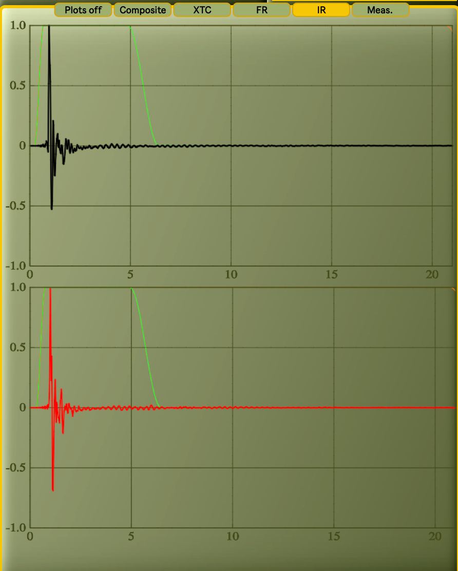

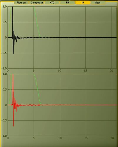

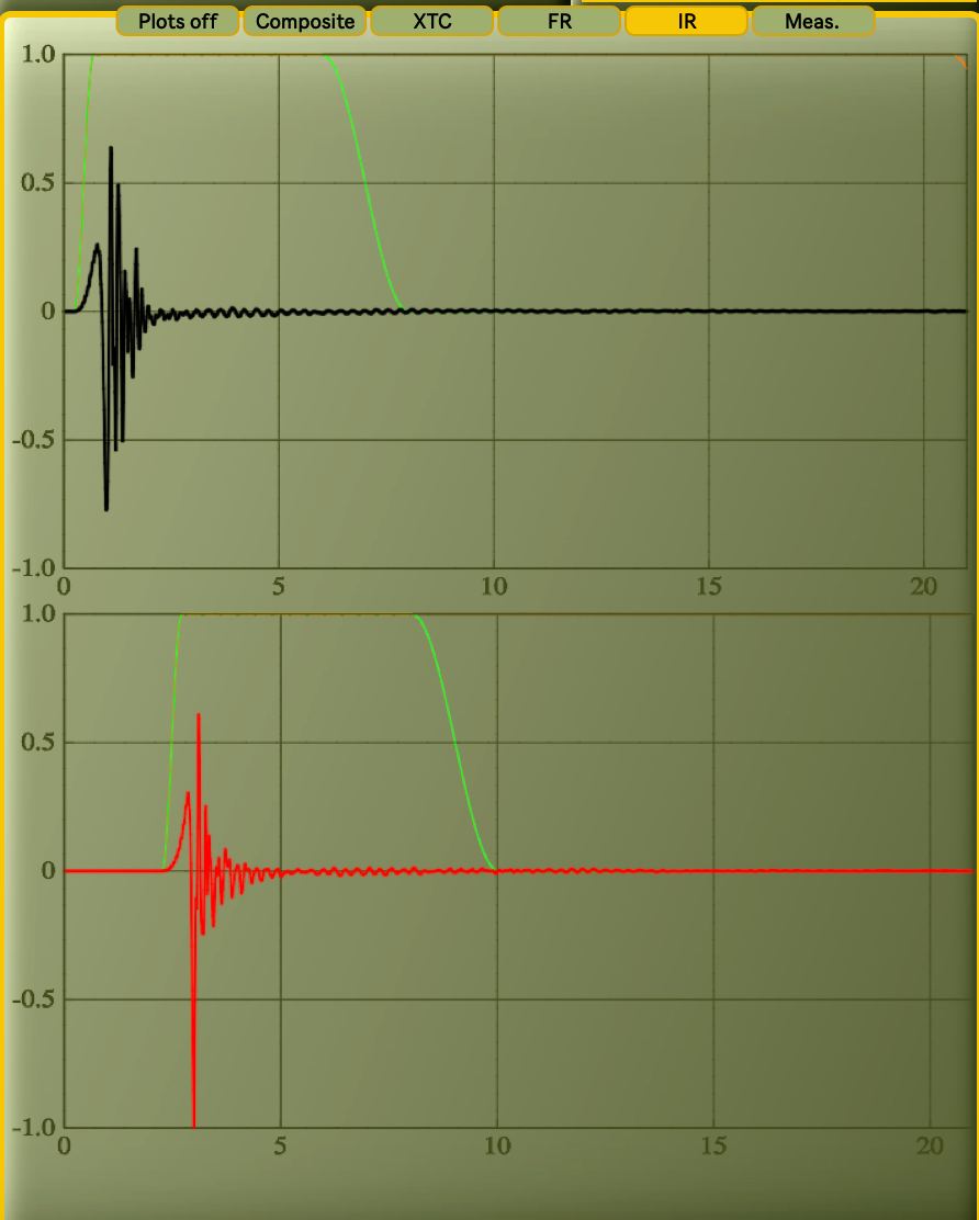

It looks like the alpha usb i was using had a defect where the phase in the right channel was off compared to the left.
This happed with all content what was above 48k.
44.1 and 48k measured just fine.
88.2 and 96, the right channel has a a couple ms delay
44.1 and 48, no delay
Interesting, I wonder if it’s an issue specific to the particular unit or not.
2ms is a long time in audio.
Yea, 2ms is enough to drive me nuts with my raals.
Most of us mere humans would not be able to figure that one out but, you’ve got the right equipment! Thanks for sharing, a lot of conversation around here of late of weirdness in various digital interfaces and the Alpha USB has been named in twice.
It’s difficult to difficult to definitively say without a lot of equipment swapping back and forth to ever point a finger, but just proof that “weird” does happen…
