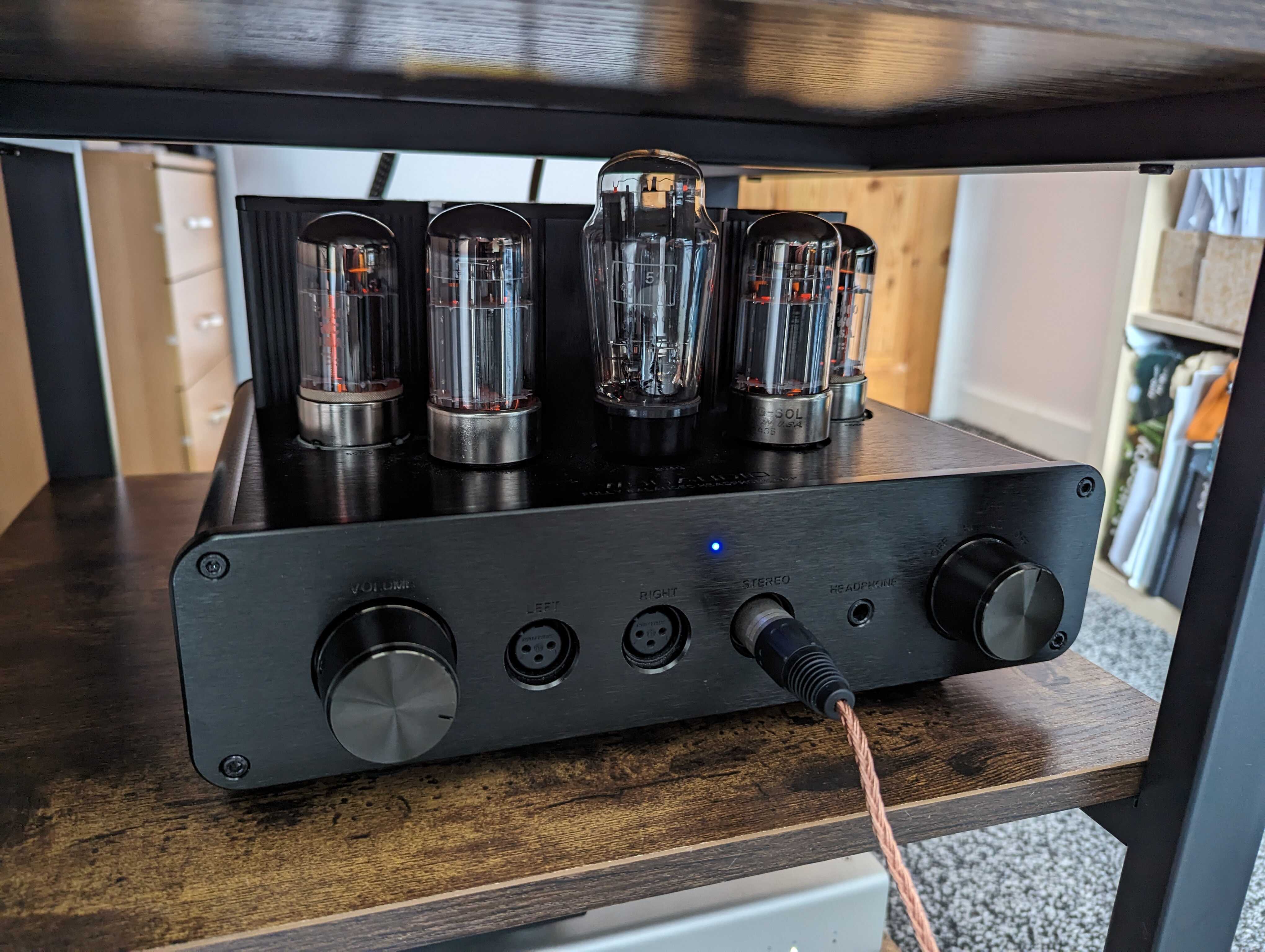

I received the WA23 today and spent a good few hours today cleaning, dusting, reorganizing, and packing things away.
A few first impressions but non of them audio related. Unfortunately there is a loud buzz that comes through at all times. It seems either a tube issue or something with power. Disappointing, but it is being looked into.
Fit, finish, aesthetics though… These point received a lot of attention. The actual amp shape to me is fine and i think it is a pretty sweet low profile look. It is very heft at about the same as the EC at 30lbs total. I am guessing whatever transformers are just built flat and inside the chassis.
But after that it drops off. The big alps pot is bragged about its feel. It is identical feeling to the alps blue velvet in the EC, it just feels like a properly tightened pot. Smooth, decent resistance, hut not though to turn. I know it probably boasts other things like channel balance but the money could of been better elsewhere. I nice stepped unit would be preferable. All other knobs have a satisfying click, but thats all.
There was attention put into the build quality as it does feel extremely solid, but the details are just odd. Where the EC had finishing flaws and ripples here and there. The WA23 feels like it is not coherent to itself. The bottom be el on the amp and power supply ate different, one overbites and the other underbites The whole body has a stipple texture that looks more plastic and i think they should have picked something better, even a brushed look would have been better. The gold parts are a slightly rose gold color, but all screws and jacks are regular yellow gold and are glossy. And theyre on top of each other and dont match at all, not even close! Even the badge on the psu is a different gold color/texture. To make it worse they put cut out rings around the pot and you see it’s brass body under the different gold outer. Then the amp’s power light is a weird orange red around the knob and it matches nothing. Just make it white.
The amp warms up very quick and the tubes give off a hot zone. I do not see any vents on the amp, and i am not sure if the amp body warms up. The EC stayed cool and never had the heat bubble. All the tubes are close so i can see why this happens, but it makes me wonder what is the design decision to put the rectifier tube on the main body and not on the power supply. The power supple is pretty small tbh, much more so than the EC’s. It is kind of awkward as its not big enough for its own space but not small enough to hide. I guess maybe if you can hide it in a drawer or something and run the also not matching light grey umbilical it can look ok.
At this point i just hope the sound lives up to it or its an easy swap back to the EC.
Unfortunately I am going to see if this one can go back. Replacement tubes came in and they are quieter, but there us still a very audible buzz when the knob is up past 12 o’clock, and this is where i questioned if other amps were turned off from being so quiet.
Its a little odd as there is a lot of buzz on switch flip, and it buzzes loud for a moment and fades a little during the 20 second warmup period. Then there is an audible click and it mostly goes away until you turn up the volume. At least that is better than before where it buzzed loud even when at 0.
Nothing will move until monday so maybe ill try to give it a listen while it is here. It is a shame as at least 2 trusted members here boasted about this one.

Had this a week. Not properly sat and listened yet; just had it on while I work …but dang, this is absolutely astonishing. I must caveat my comments by saying that I have never heard an amp of this tier before. But the holographic nature of each image is incredibly satisfying. This pairs really well with my HEkse, too. There’s real heft to kick drums, etc., that really adds to the enjoyment. Will post more coherent impressions, but this amp has won me over easier than any other piece of gear has.
