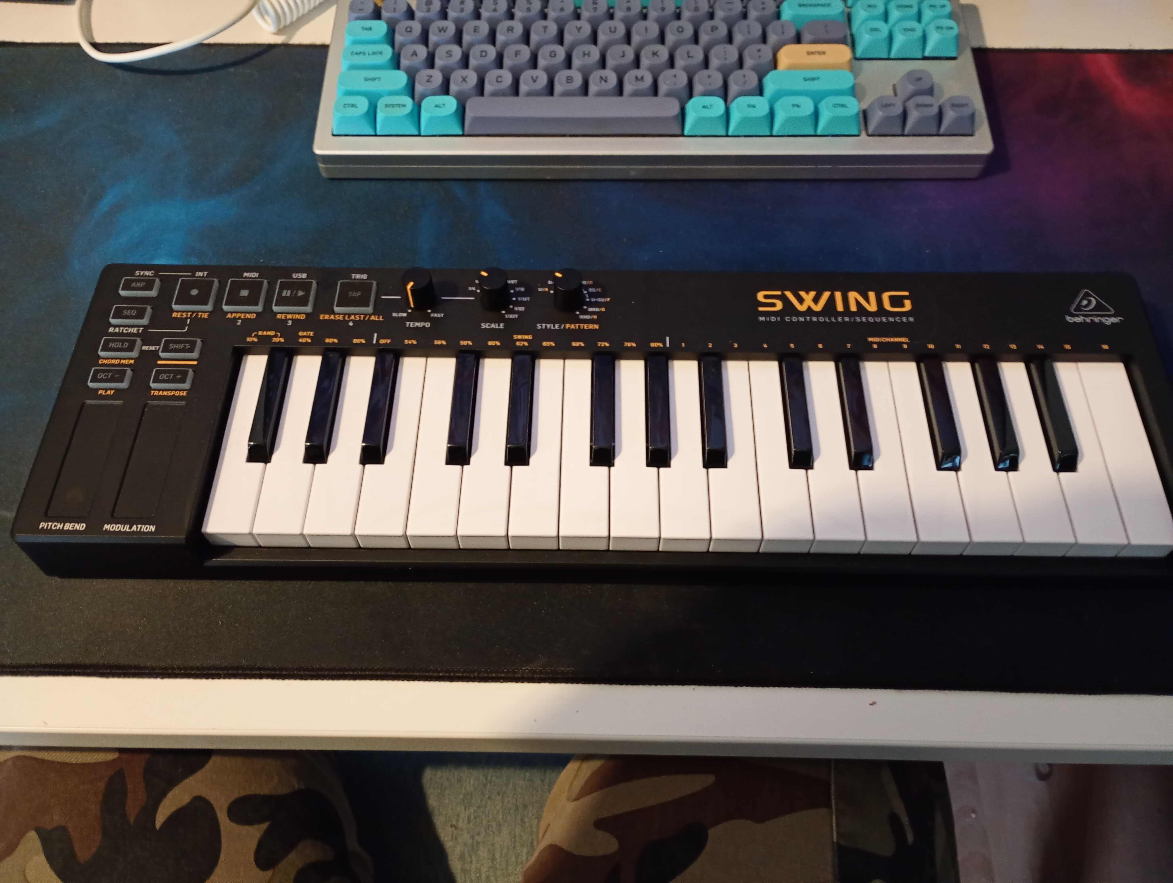

Music related purchase? Behringer Swing midi keyboard. A small present for myself. Two reasons, one to learn a little piano as I have never tried a non string instrument and the other because I mess around with VCV Rack off and on and doing so is super hard without a keyboard.

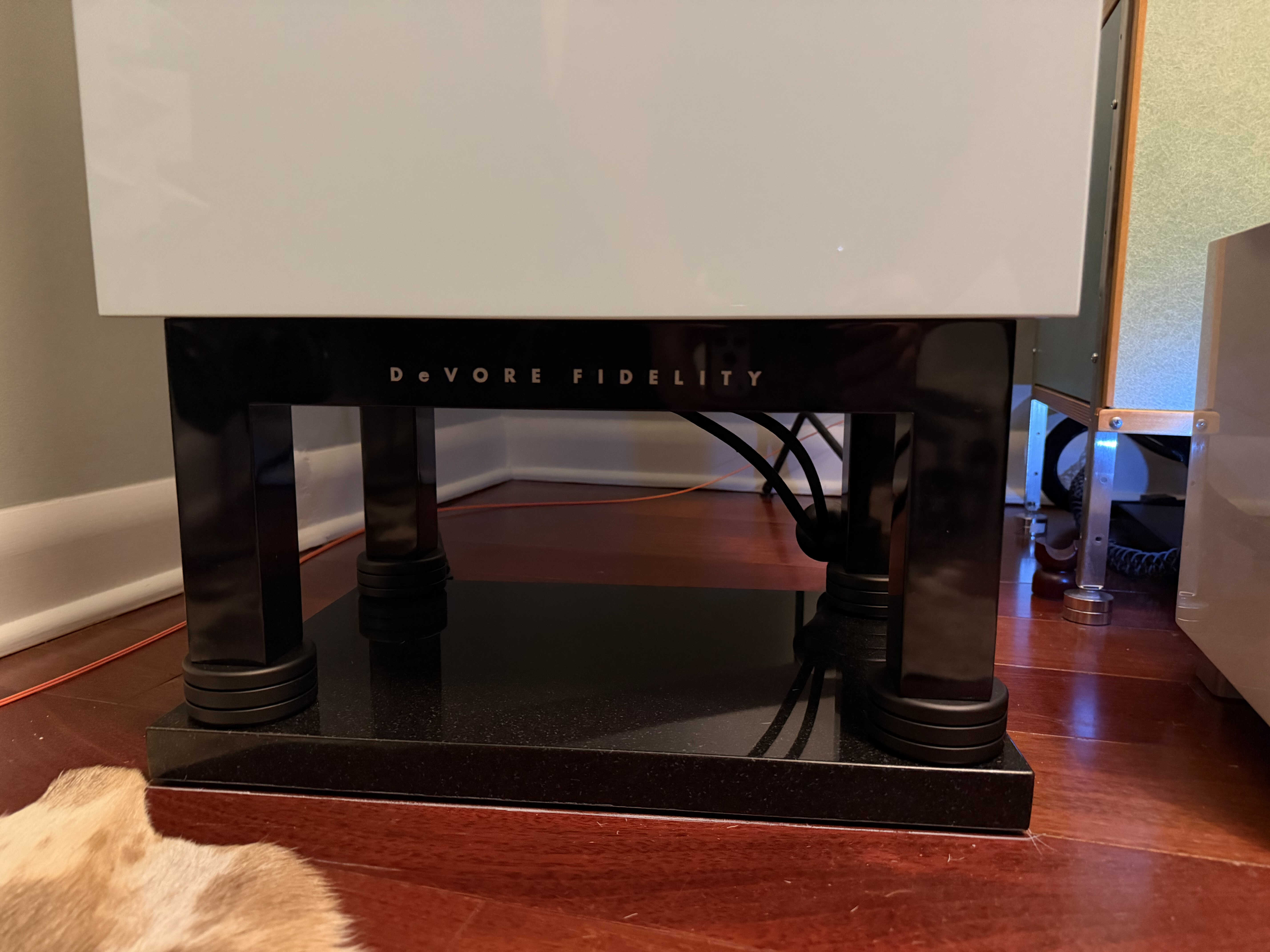

Bought some new shoes for the DeVores. Surprising amount of sound I was leaving on the table without them, I’ll write a bit of my impression on them in the vibration and isolation thread this weekend.

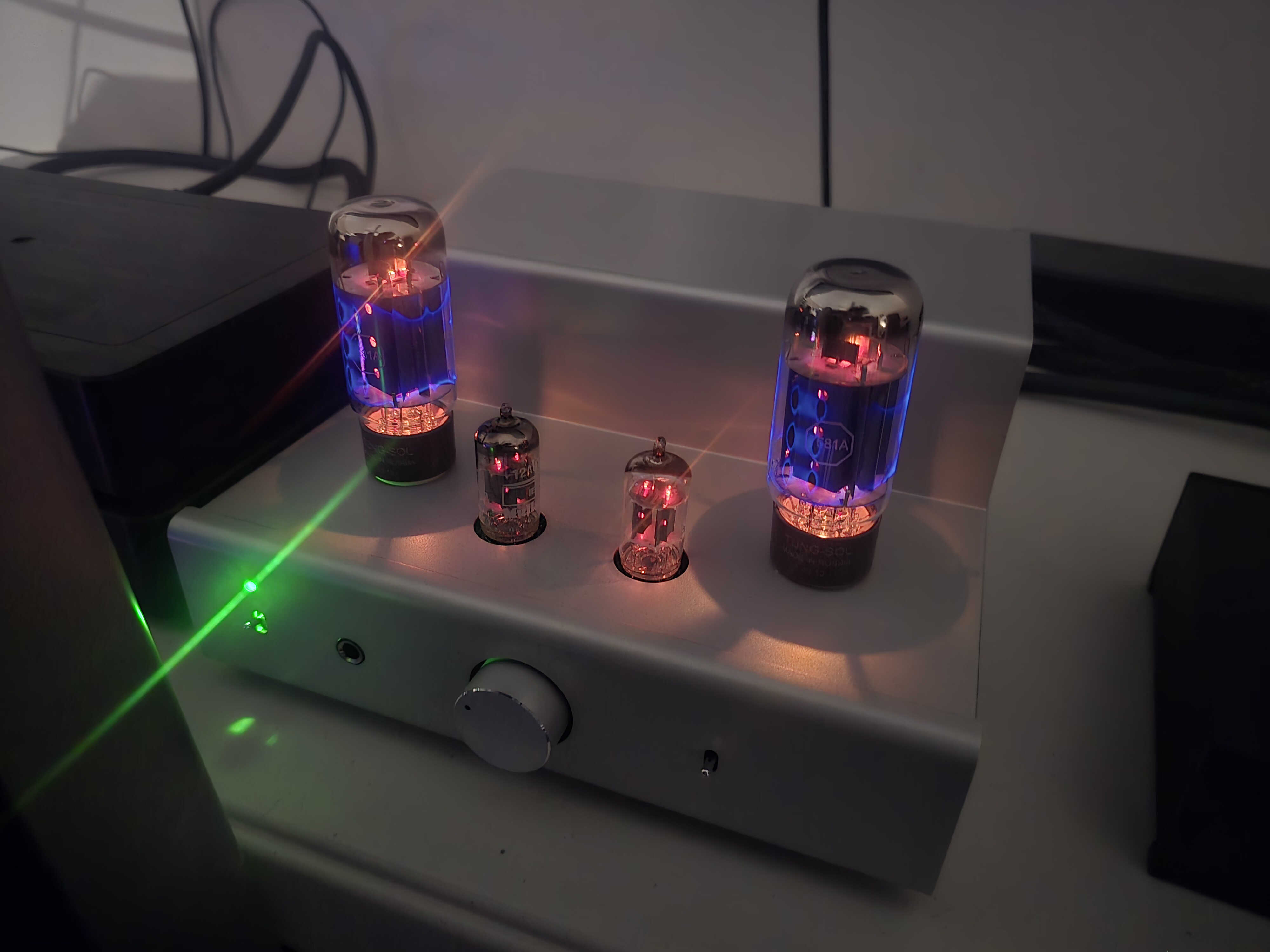

I couldn’t recommend any of their products more, its absolute top notch, from design, to materials, to instructions, and the most important, they sound breathtaking. They make bottlehead kits look like novice stuff.
If you like this kind of project couldn’t recommend more.

Honestly I don’t know that much since im new myself to elekit, but heres what I do know, as brief as possible.
Theres 2 ways to go about Elekit, to get them pre-built as a speaker amp or to buy the kit to build the speaker amp yourself.
Dont get their dacs, cheapear dac/amps, headphone amps, those are meant more as easy to build educational products, they dont sound good at an audiophile level. Also their optional DAC module is not good, just use an external DAC.
Also keep in mind that most of these have headphone jacks, again they put those there because they could, they sound quite bad at an audiophile level, these amps are designed to provide amazing Speaker Sound, preferably with somewhat higher sensitivity speakers, which are relatively common in mid fi, if you have a set of speakers its probably above 87db/mw which should be enough to get great sound out of these amps. (You might need more info on tube amp to speaker pairings if you don’t already know, just ask, rule of thumb is easier to drive speakers get better results, but there’s also some beefy tubes, so it depends).
Tube Depot is their official distributor in the US, I think you might be from Europe, they have several distributors there! Which means you can go either way, build your own, or look on the second hand market to get an amazing sounding tube amp for your speakers for cheap (Elekits really do sound way above their cost, specially if they include you some nice tubes).
The kits are super well made, all of them, the instructions are fool proof, and everything is made with the user being able to make things right in mind… I had the complete opposite experience when first building my BHC+S, the manual said it could be easily be built in an afternoon without any prior experience, bullshit.
Since im not a hobbyist type of guy everything from the painting to the soldering was very stressfull, and it took me like 20 hours without the speedball, it requiered some soldering techniques not for begginers, so I had to learn on the fly but I learned incorrectly because they dont even tell you to use solder paste or flux, nor any advice on cable managing.
Before we continue, Elekit has some sort of educational mission to their brand, so most of their models can be run in several electronic configurations so you can learn and hear the difference for example between triode, pentode and ultra linear connections; of course everything is explained beautifully and its an easy swap, most users would just pick the best sounding one for their model and leave it there.
A bit more of the same goes with the space inside the aluminum boxes, they left enough space in case you wanted to upgrade to larger capacitors, and you can pick between installing a standard transformer or a much higher quality Lundahl one (or two) for upgraded sound.
Now to finish this post with some very useful info, here are the exact models you should look into:
Elekit TU8185, frankly Id skip this one and any other kits bellow this, reason being this is more aimed at beginners getting into DIY Kits, while its possible to get good sound out of this one it would requiere very specific speakers and for just a bit more money you get to the real THICK, ELEGANT, sounding kits.
TU8200R I think this might be the best one to start, its their most popular kit for a reason, its just been very recently discontinued but some dealers may still have some left. It sounds killer for its price, just put it in ultra linear mode and get those JUICY 8WPC, It sounds great with stock tubes, but I put in some mullard cv4003 drivers and Tung Sol EL34, with the right speakers that have high enough sensitivity, they start putting some very expensive speaker amps to shame.
Since these amps have many modes they can work with, they can also accept a wide variety of tubes, and these are precisely the kind of amps that get their sound signature straight from the tubes used. So you can get the signature you want!
(Again you can always ask for help to see which tubes will sound the way you like, and which distributors have them, at least here in America).
Just as the production of the TU8200R ended, so did the great tube preamp with phono stage TU8500 you could stack it with, good thing is both have been upgraded a lot, bad news is theyre quite a bit more expensive.
If youd like to get a really nice phono stage tube preamp, id highly recommend their new version TU8550, if you dont need it or already got a nice phono pre you can skip it, however, the new version of the TU8200R, Called TU8400 is designed work a lot better with a nice preamp.
The TU8400 is a Beast, now compatible with way more tube types, you can get it up to 10WPC using KT170, 8.6WPC using KT88, and like the previous version, 8WPC with EL34.
Like I mentioned before, you can pick a regular transformer for your Elekits, or you can go the Lundahl way, very expensive upgrade, but very good sounding. The matter of fact is that even without the Lundahl you are getting amazing sound and value, and sometimes spending that extra money on tubes can result in better sound. Lundahl is a luxury not a necessity, but be sure to get it if your wallet allows.
To not make this any longer as it already got past what I wanted to say, they have their 3 top of the line models for you to pick, just amazing value for the money.
Elekit TU-8850SE - This is BIG BOY version of the TU8400, as it can reach 16WPC in Ultra Linear mode, and also compatible with the same variety of tubes, with more power.
Elekit TU-8900 - 300B/2A3, this is one of the cheapest 300B and 2A3 tube amps in the market, not to be taken lightly, as it can hang around the big boys no problem.
Elekit TU-8888 Monoblock, yup they do monoblocks too.
Well thats about it, cya.
One more thing, I think its a massive shame that the TU8200R was discontinued since it was SO MUCH cheaper to build than any of the models currently available
I feel like having to put up the money for a TU8400 is gate keepy and I know its not intentional, just the way the market is
Had I never gotten this TU8200 I would have never tried out Elekit since the price of entry is way too high now.
Cant wait to upgrade to the Lundahl TU8400 now that im already initiated
