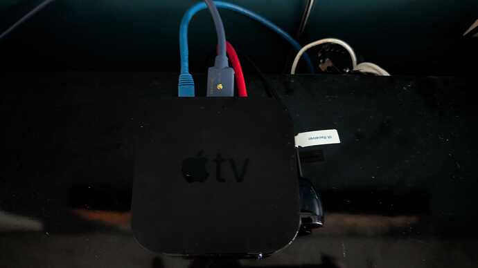

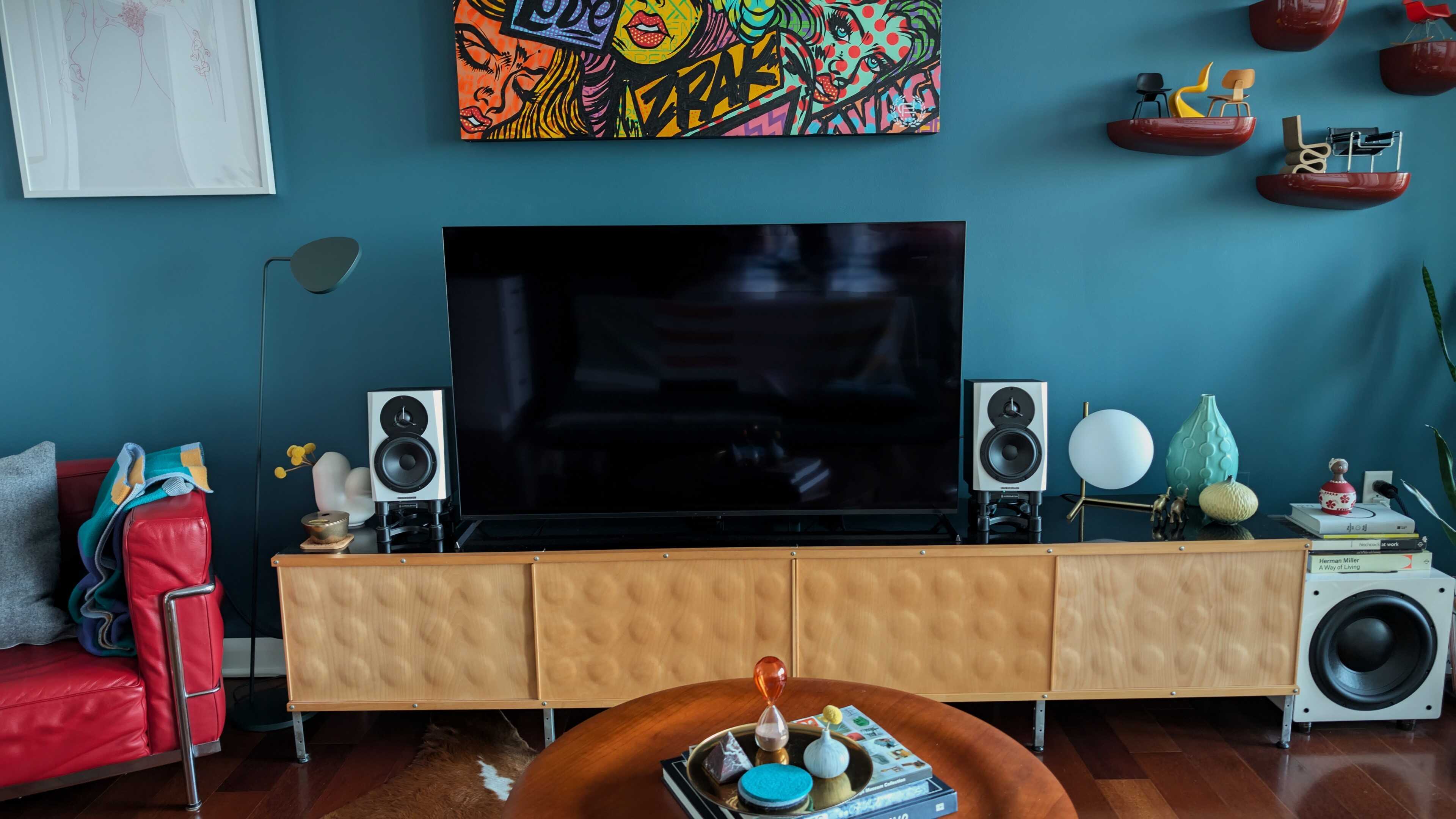

Here’s what I’m working with.
TV: Sony BRAVIA XR 55” A80CL
Video: Apple TV 4k 3rd Gen
Speakers: Dynaudio LYD 5 Monitors
Sub: Rhythmic 12"
DAC: Pontus II
Preamp: Schiit Freya M
Power and Cables, all handmedowns from previous 2-CH system upgrades
Relatively happy with things originally but as I’ve had the TV for over a year now, I started upgrading power, and installing IFI AC Purifiers and using decent cables left over from my 2-CH upgrades. I started to notice meaningful improvement in picture quality and detail. Thus, a new rabit hole where I’m going to upgrade the Apple TV to a modded unit removing the built in switched power supply and will use an external LPS. Also since @elementze mocked my “dirty bits” since I’m pulling audio via TosLink from the TV right into the DAC, I just picked up a Wired4Sound optical reclocker. Everything configured as 2.1 stereo.
The Pontus II DAC was a big improvement over the previous Topping D70 I was using. The staging, placing of dialogue and sound that tracks within the image is so much improved.
The DAC and Preamp are inside the cabinet, one thing I had to do for the volume on the preamp, was get one of those USB IR remote repeaters where one end is visible (stuck it on the side of the Apple TV) and the other end I stuck it on the IR receiver of the preamp. Really low cost solution and worked like a charm.
Power for all of the “little boxes” is currently coming from either IFI power supplies or a LIPO Battery backup unit that I’m power up with a IFI power supply. So trying to keep power and cabling clean, neat and tidy.
Applaud your efforts to eke out and keep things tidy, I envy your eye sight to pick up on the improved picture too.
I understand what you’re try to do here, however this is still optimized for 2 channel rather than 5.1/7.1 HT, the center channel will be getting a direct feed , as will the other supporting speakers vs. requiring a mixdown into 2.0.
This is by no means a knock, only you are leaving a lot left on the table for the 5.1/7.1 channel mix. In this situation you would be better served using a soundbar for movie/tv entertainment and the 2.0 for music.
As @Polygonhell indicated “ movies and music is just different
No, the Apple TV audio output is set to Stereo and thus all I’m getting is 2.1, so no center channel or anything like that. The TV is basically spitting out what it gets from the Apple TV. So this is a legit 2 channel stereo output with the sub channel coming from a spare out on the preamp.
If one is willing to give up multi channel set up for TV, you’d be surprised how good just a regular stereo output can sound! I just don’t have the space for anything more.
Anyway, despite the setup, 90% of the time it’s just my wife using her bluetooth earbuds on it anyway! lol
At the end of the day, this is the only thing which matters!

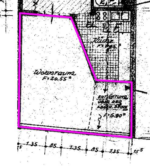

Project Slowburn
State of Things
  • I have a living room to work with, it is… shaped…
    Good news: Non-horrible audio wise :+1:
    Bad news: Only suitable image-device is projector and screen :smiling_face_with_horns:
Goals
  • Socially acceptable Living Room with a Dinning table in a corner
  • At least 6.0 speaker setup
  • Biggest screen I can fit

Bringing this up before its too late. But do any of the living room outlets share/not share an electrical circuit with the kitchen fridge? Fridges seem to be noise makers both physically and electrically.
I think the entire kitchen is on its own circuits, would have to double check though.
The fridge is from last year and pretty quiet.
Checked, Kitchen outlets are on their own circuit.
@Polygonhell
Yeah I’m fortunate enough to have well thought out electrical layout and the kitchen is on its own circuit which I know is a big help.
Another thing to consider in a living room environment is lighting. Anything with a ballast, anything with a dimmer and anything with a transformer is inherently WAY noisy. So avoid altogether or turn off when not in use; and certainly don’t use that type of lighting as accent lighting.

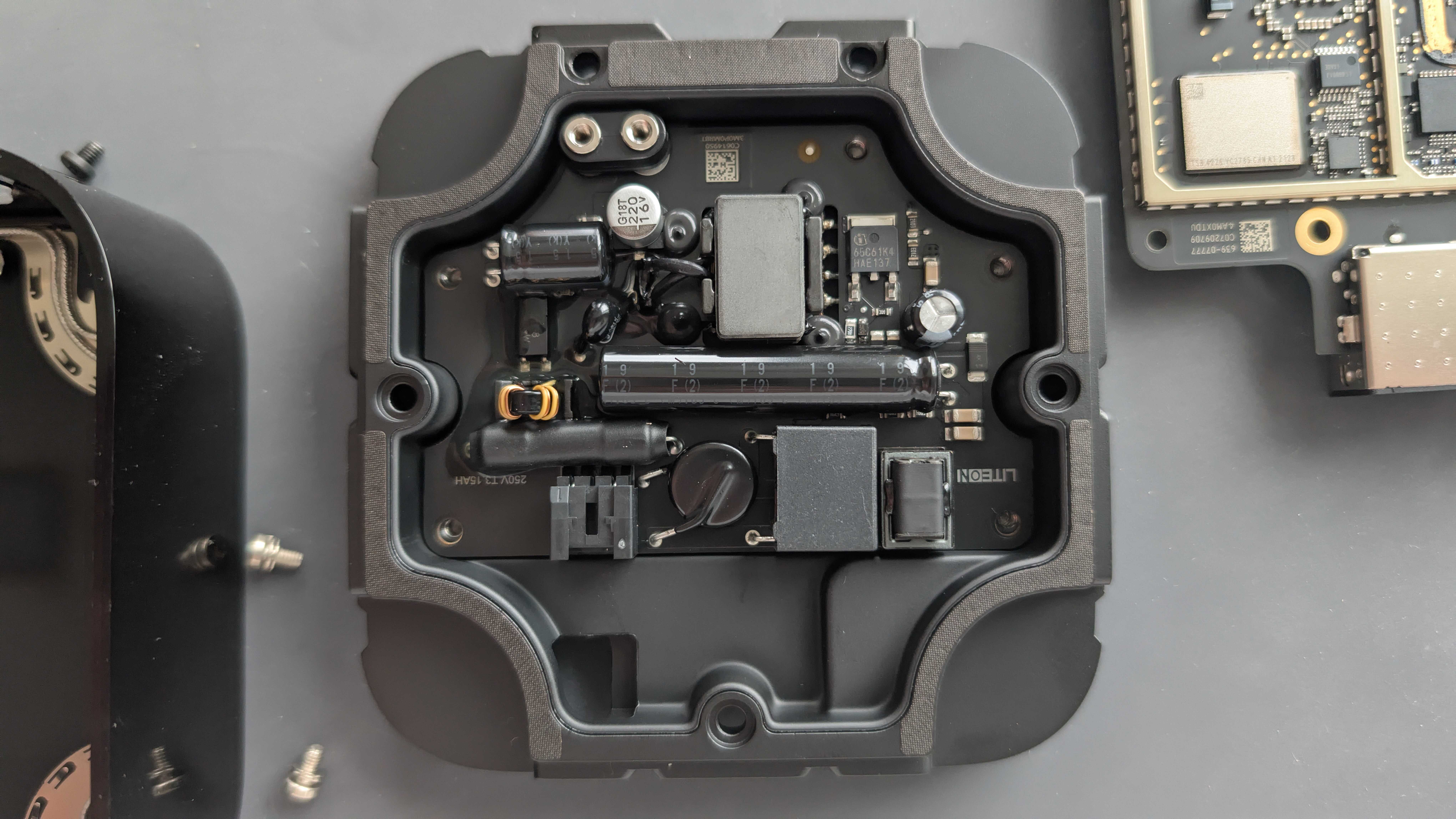

Well, I said I’d document it, so here it is.

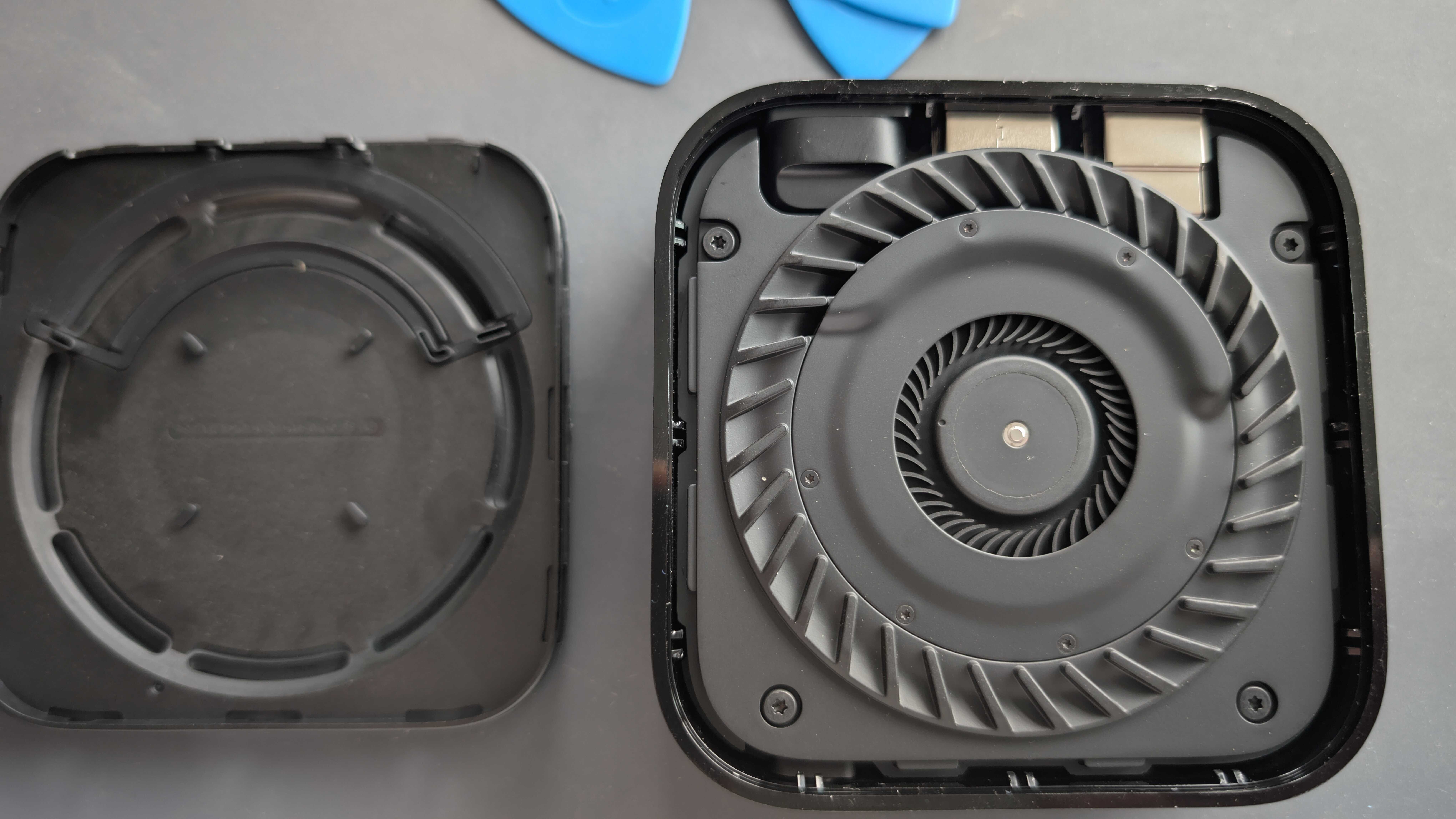

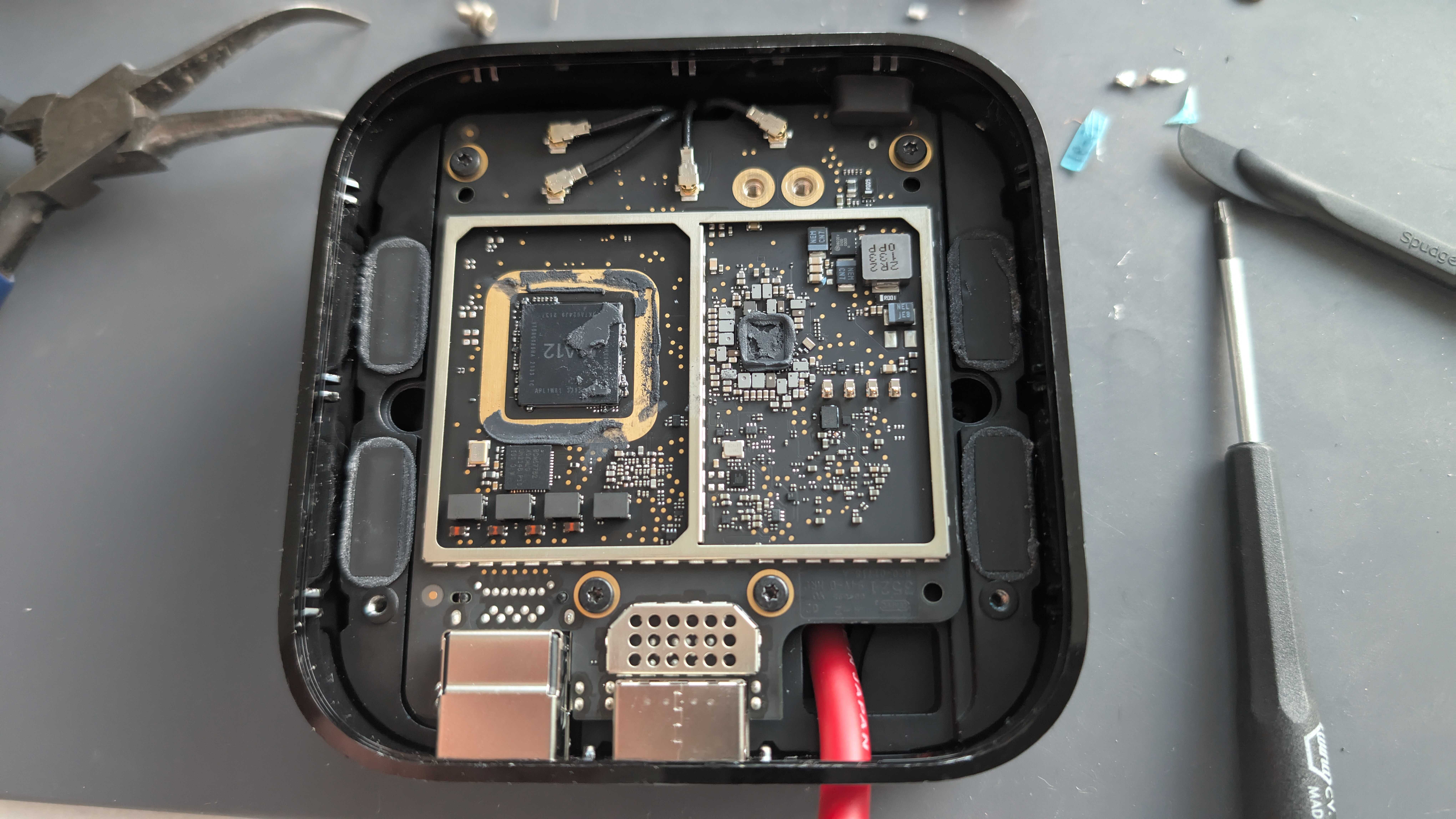

Apple TV 4K 2nd Gen. (A2169 64GB) A number of posts and clips on YouTube on disassembly and why it’s a superior build to the new Gen 3.
Bottom removed and the first thing you see is the fan assembly. Yes this version has a fan because it’s got a lot of HW that is completely sealed in an aluminum clam shell assembly.

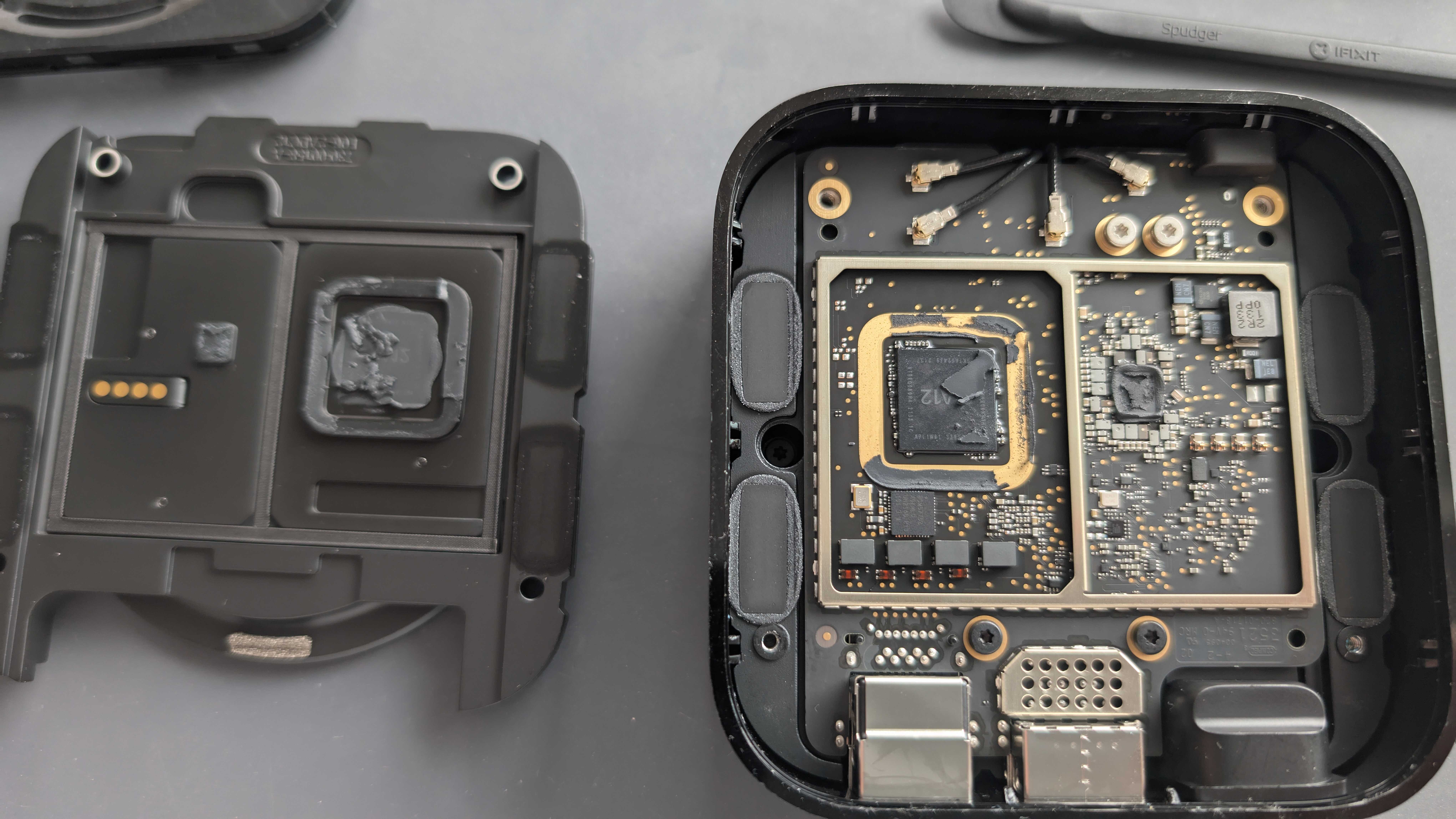

Fan assembly removed and that’s the logic section with the A12 processor on the left, note the hefty clock on the bottom left near it and all of the seals with heatsink paste for the processor and the aluminum shells as well. Everything is isolated and very well sealed. Also note that the noisy antenna connectors are outside the sealed areas. As Tuco Salamanca would say, tight tight tight design.

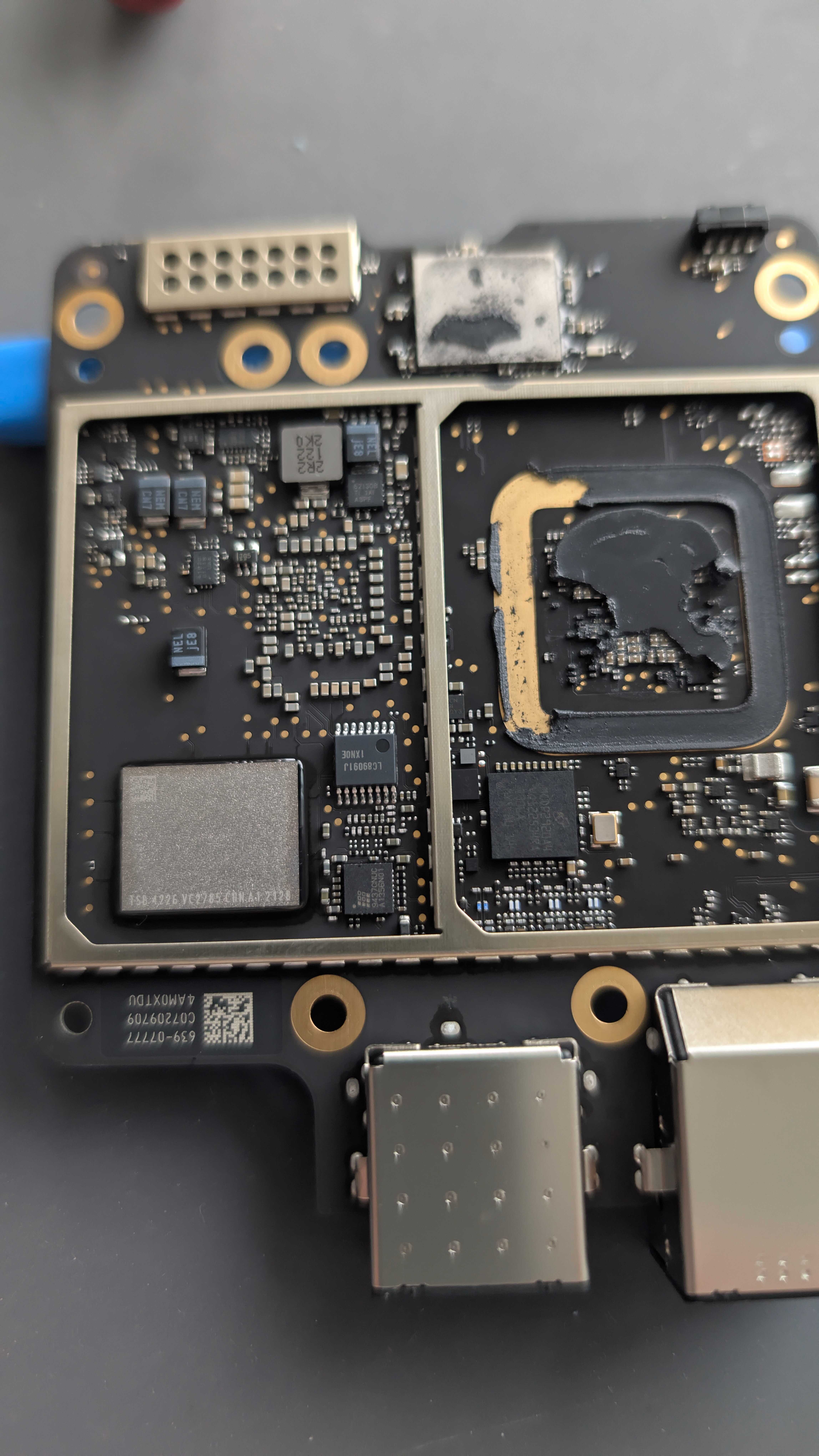

The bottom side of the same board, a log of stuff there, the HDMI connector and Ethernet jack. Note the RFI coating applied to the processor on the left side and again, everything isolated an sealed tight. All the screws had blue Locktite applied.
And underneath that board is the other half of the machined aluminum clam shell, five bolts again all with blue locktite. And then the bottom, which is actually the top when built, is the switched power supply.
Interesting design choice to keep the noisy board completely isolated from the rest of the system. The only connection is the two silver threaded tubes that “pass through” to the other board, so again very tidy design.

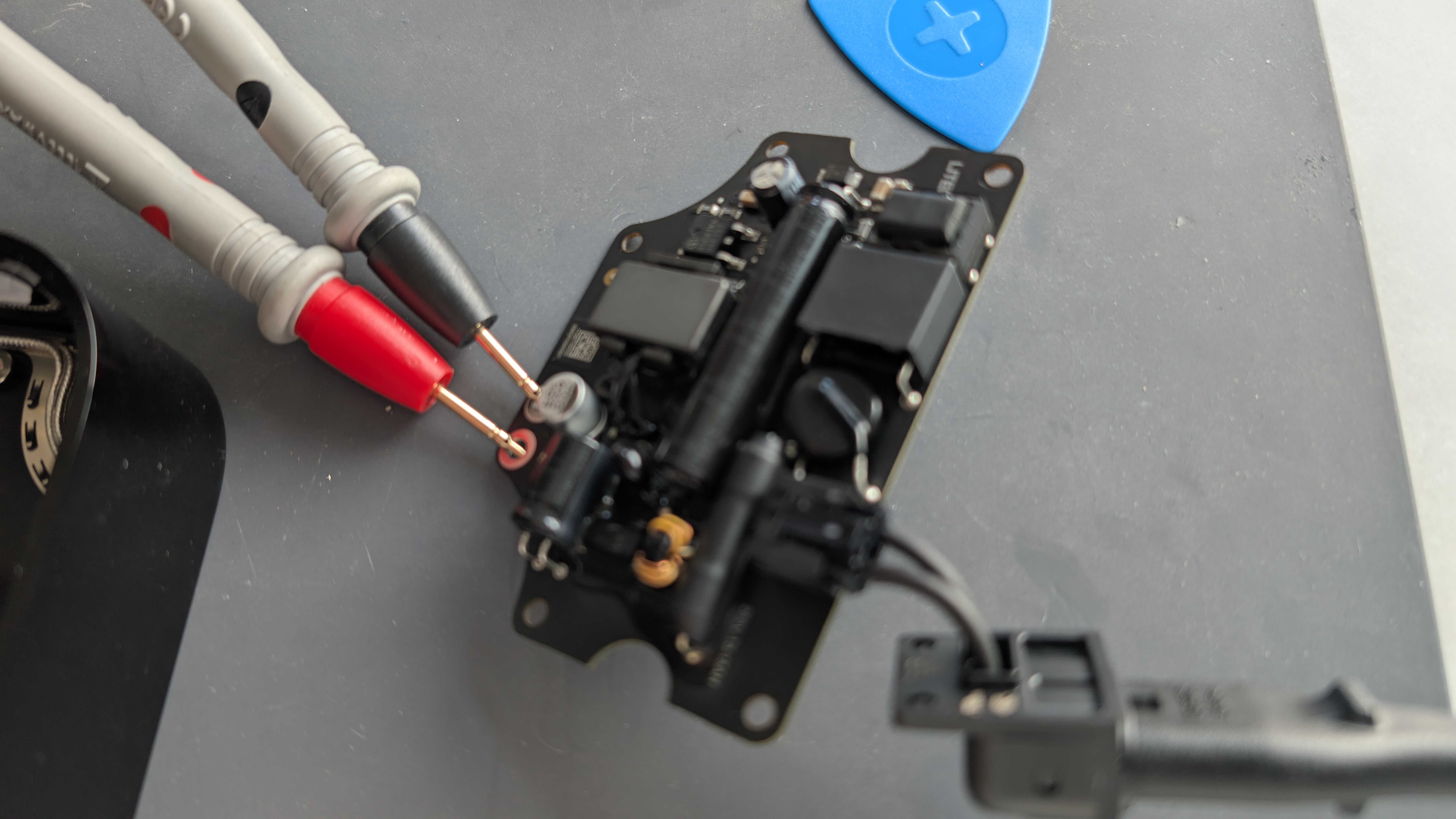

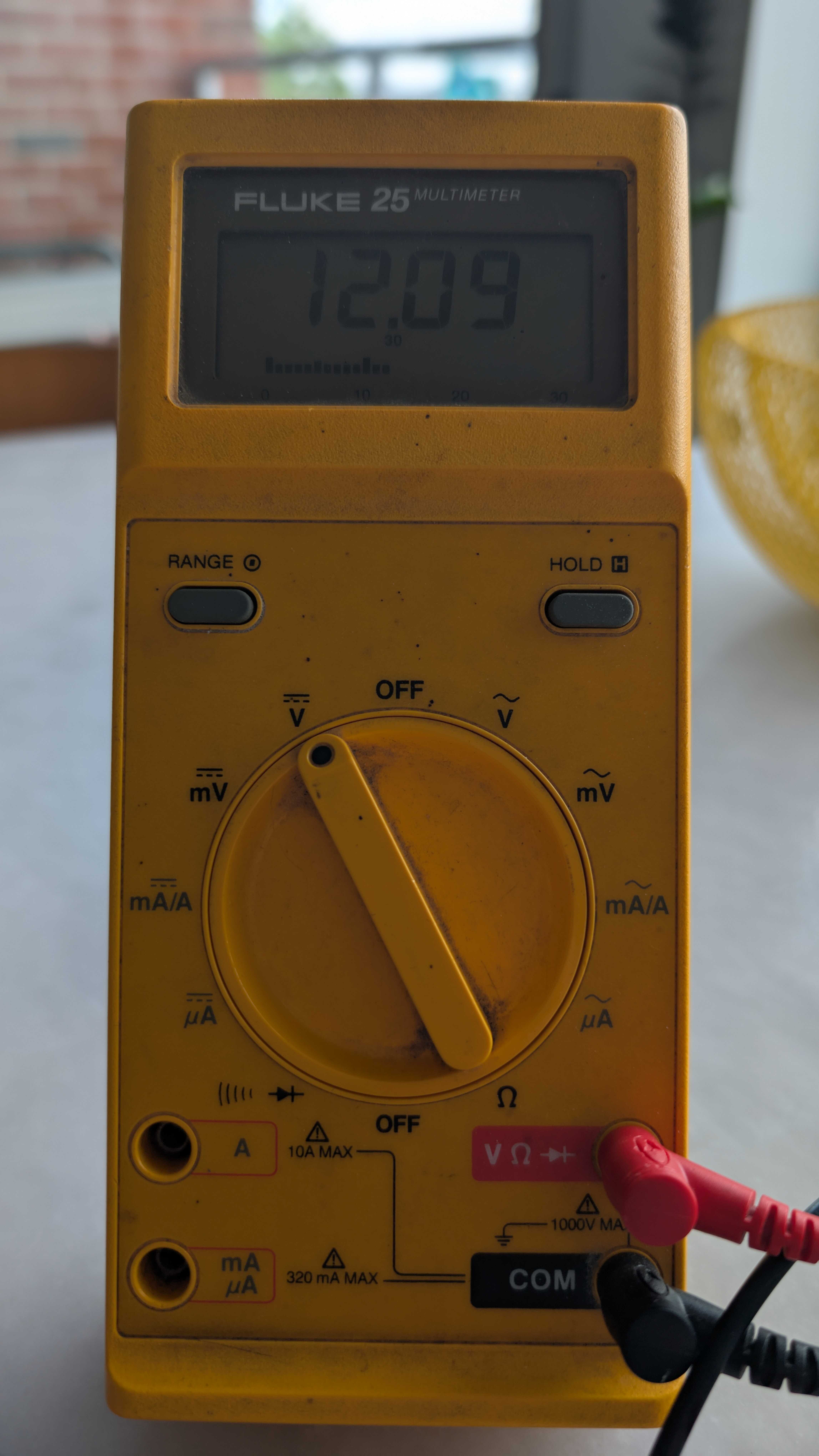

Here I’m just making a note of the + and - sides of the power feed through as nothing is labeled.
Confirmed voltage and polarity. It’s actually a LiteOn switched power supply.
BTW, fun fact. I’ve had this Fluke multi meter since 1990 and it’s still kicking!

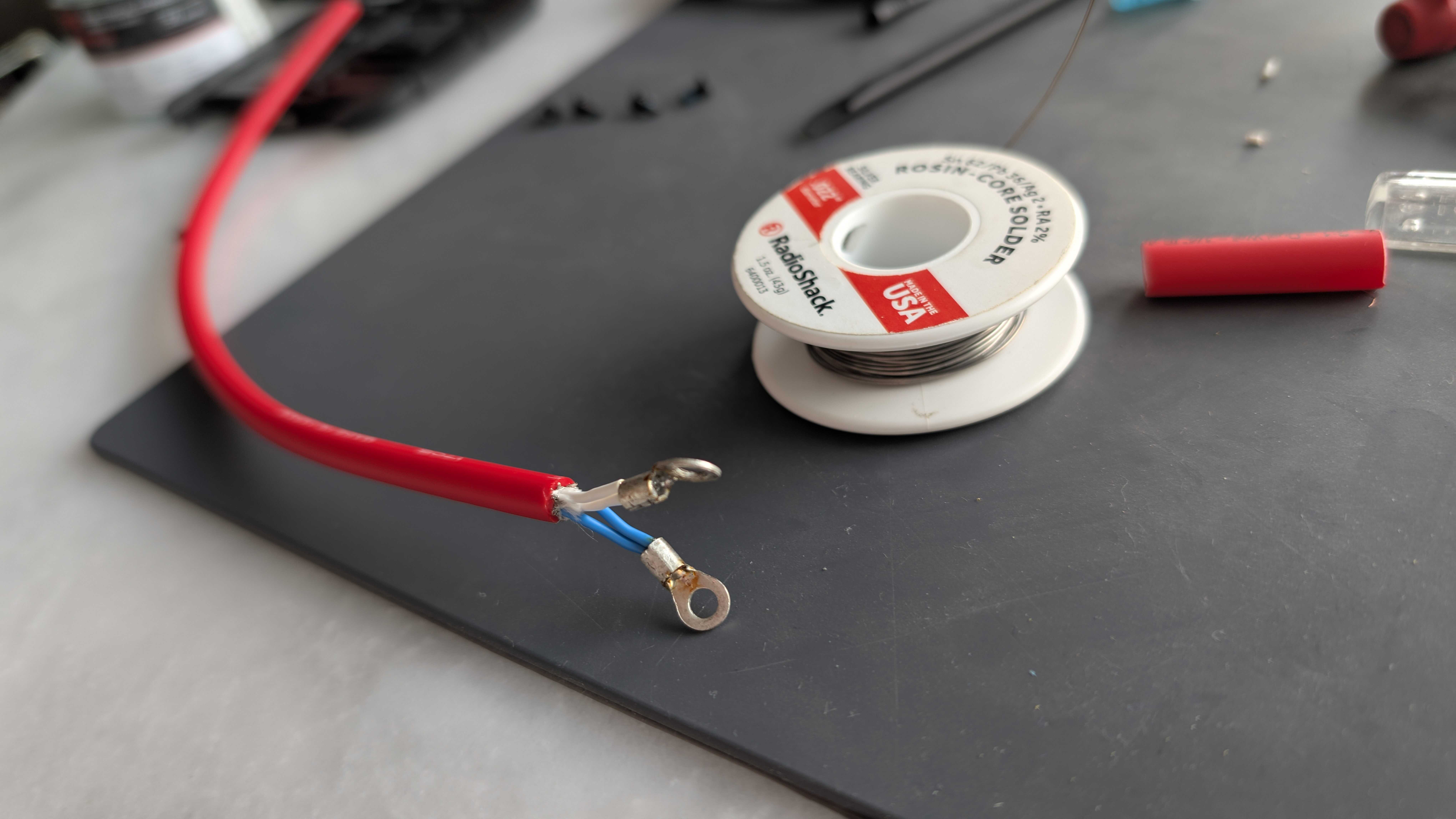

I built myself a cable with some Canare quad star cable I had and soldered ring terminals on it and used the screws to bolt them down in place of the power supply. The whole point of the project was to remove the power supply so I could use a quality external PS.
I was freaking out at this point since when I went to put it together the ring terminals were a fraction of a millimeter from the casing and I was so afraid of shorting things, spent about an hour thinking of how I would connect the cable until I realized that the metal half of this clam shell had pressed in plastic shell, maybe ABS or some other type of polymer. Anyway, once I realized that it was lined with plastic and I wouldn’t short it accidentally, it was a big sigh of relief. I was scared that any expansion with heat could short it but freakout averted. :slight_smile:
…anyway, at this point it was getting late and I needed to pick up the wife, so I rushed the assembly and forgot to take pics of the reassembly process. A lot of screws with only the five bolts for the power board left over.

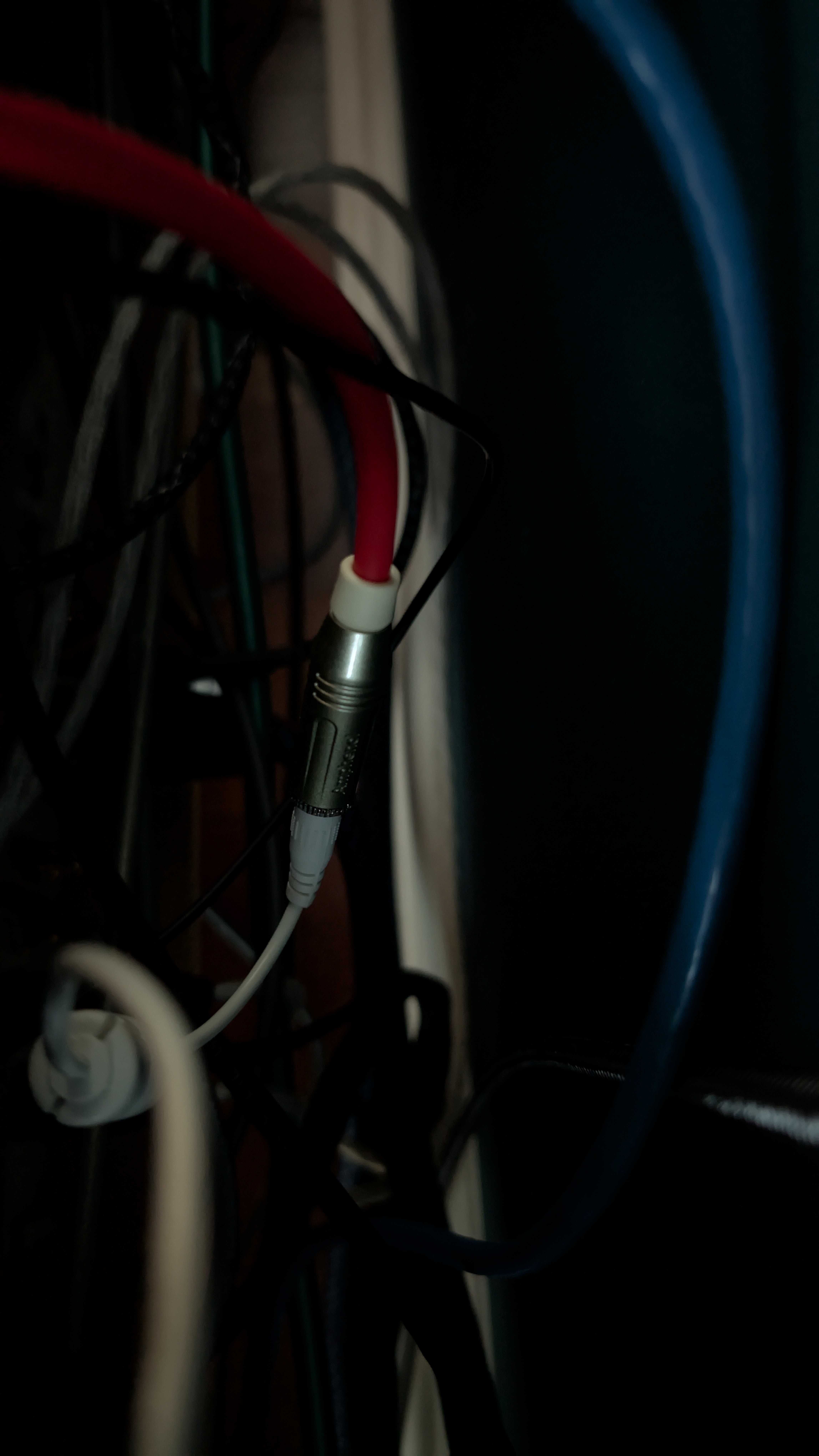

Here it is all back together.
Last pic, never miss an opportunity to score on style points. The power cable I terminated externally with a 2.1 DC connector which by a stroke of luck happened to have the same thread size as an Amphenol RCA connector barrel. So I used it as a means to make it all nice and neat and again, help with noise right? not the greatest pic here but it illustrates the point.

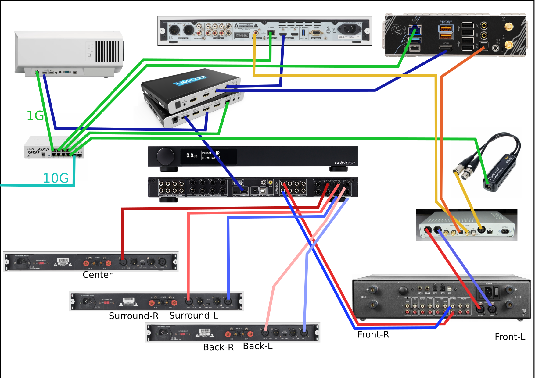

Project Slowburn
Madness #1
Multiple thoughts/questions:
  1. Having found both my measurement mic and analyzer again, I did some tests. I may be able to get away without a subwoofer, IF (big if) I give the center and surround speakers part of the job. This means 7.0 setup and a DSP or speaker management device.
    DBX DriveRacks would be way overkill, MiniDSP seems more like it.
    Dali Opticon LCR and Dali Rubikore have the specs, am yet to phone up dealers to see if anyone has some for a demo.
  2. Local home theater shop had the projector I desire up for show, hot damn that was a crisp image at 3 meter diagonal (= 118 inch)!
  3. Having looked into the hoops I need to jump through to avoid “not my price range”-equipment, I need to hook 2 different HDMI sources up to the projector, a control-monitor and something to deal with audio. Some searching turned up the HDFury VRROOM. Anyone got experience with any HDFury gear?
With all that said, this is where I will aim for:
If I find a deal on a JBL SDP-55 or SDP-58, I will replace all the HDMI-fluff with just that.

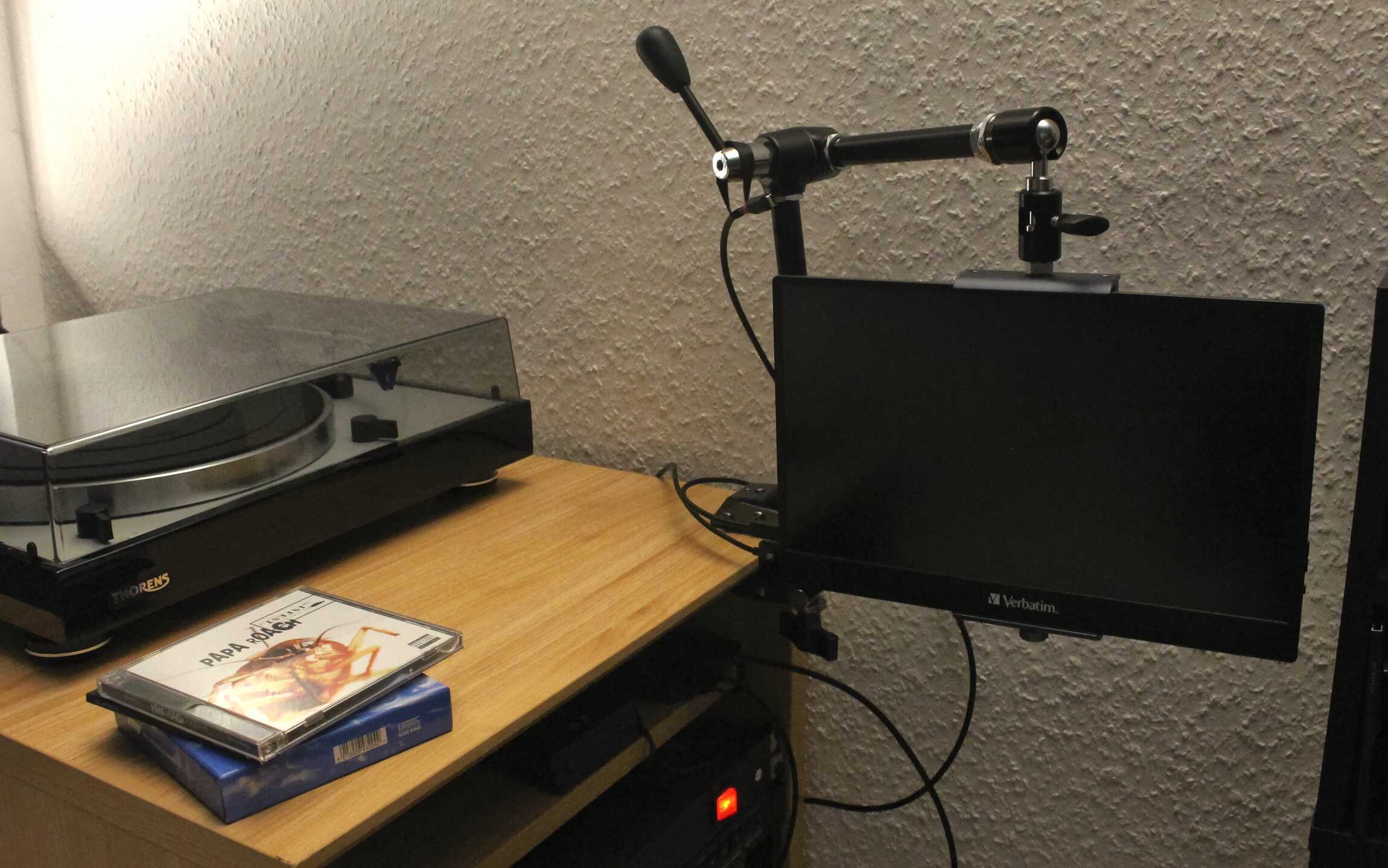

Why the monitor you ask?
Well, imagine having to wind down the screen, warm up the projector and then undo all of that for selecting a different source or even just change from USB-drive to CD. I did imagine that, and I want none of it.
There is a similar monitor available to the one I have, in 4k, for 220€
For 300€, I can get a 2x2 matrix scaler, which is more expensive, but means the projector is set-and-forget.
The monitor is one of those portable ones, means no VESA. But since it is essentially a laptop/tablet size, it fits in tablet mounts. Add a Magic-Arm and universal clamp, mounted!

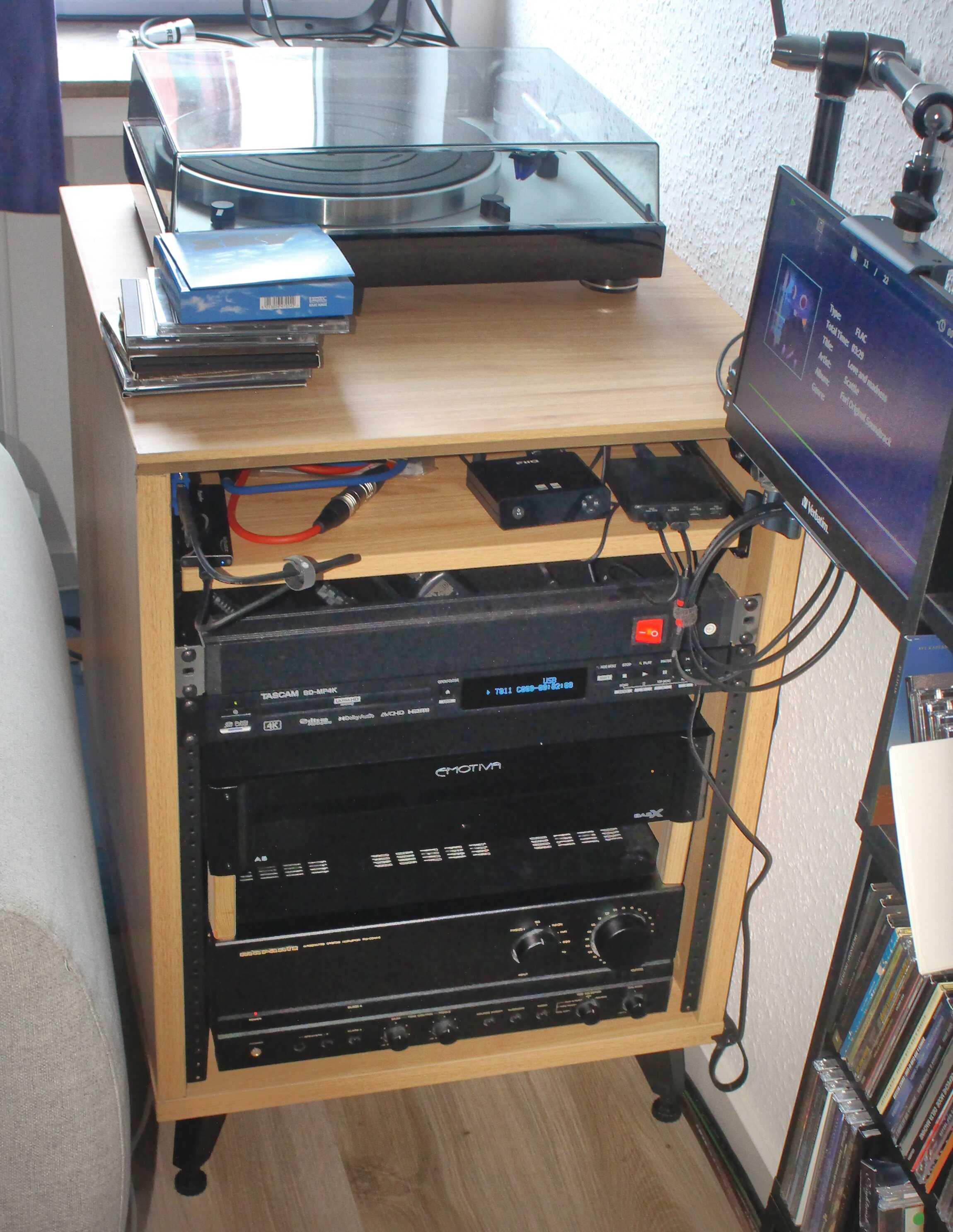

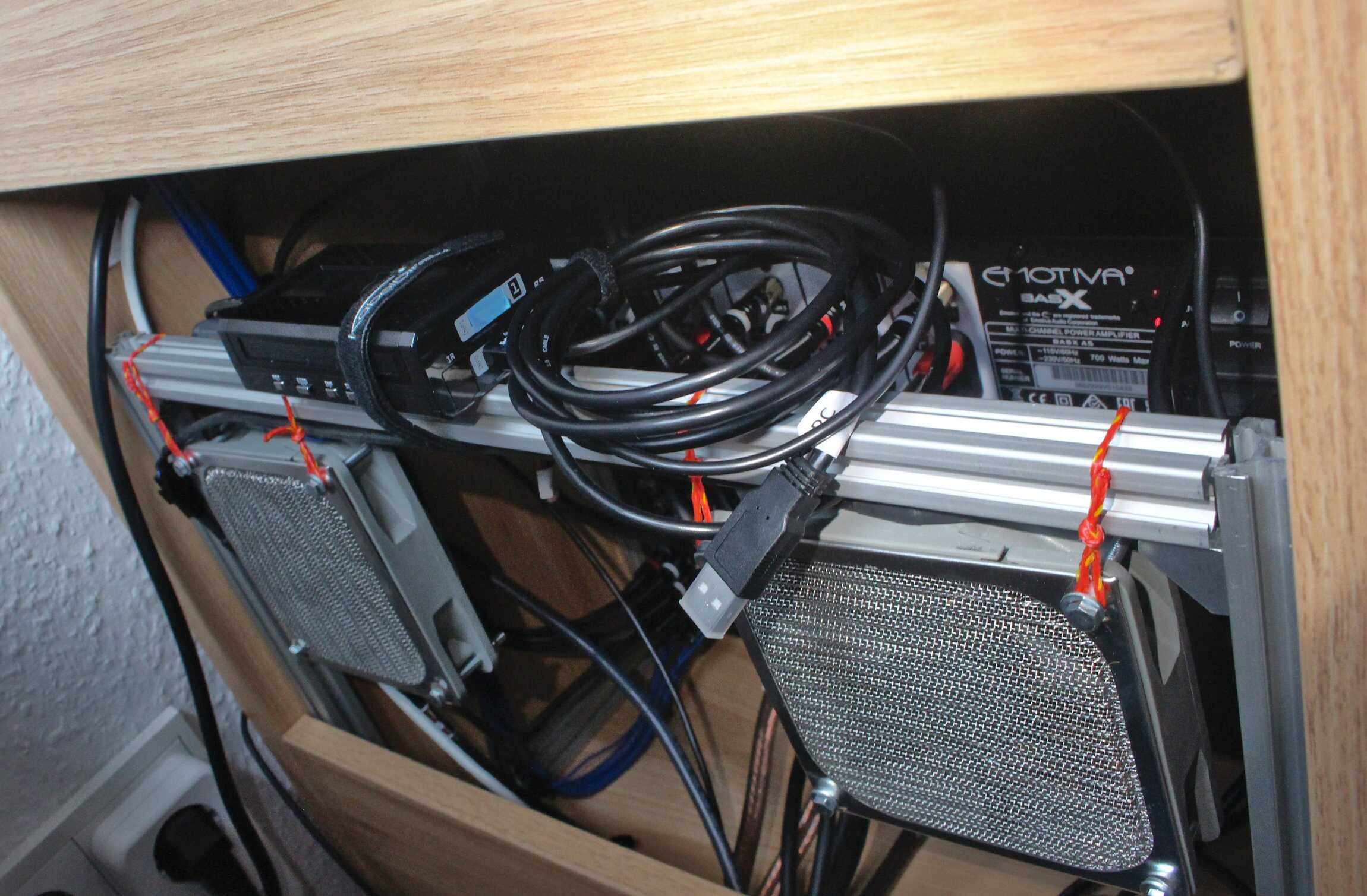

State of the Rack:
I need the 2U Rackmounts for the Emotiva, for now, two wooden blocks have to stand in.
The fans are yet to be hooked up to anything, eventually the trigger-out from the Emotiva will start them up at low speed.

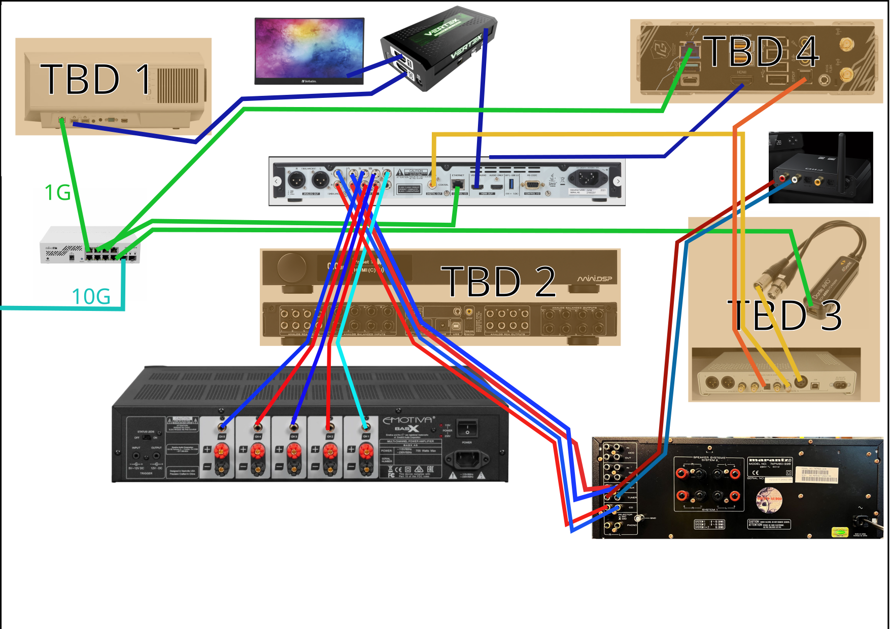

Wiring diagramm and next steps:
TBD 1:
I am now technically prepared to take the plunge and shell out 5-kilo-bucks for the cheapest true 4k projector on the market, because pixel-shift is for cowards!
TBD 2:
DSP is scheduled after I get the first real movie watches in. Fixing terrible audio-mastering in post probably needs to happen, can wait though.
TBD 3:
DAC and DANTE will be acquired some time later this year.
TBD 4:
Thanks to Sam Altman and Gang, the HTPC-project is on hold until 32GB RAM cost less than the rest of the computer again :fu:
