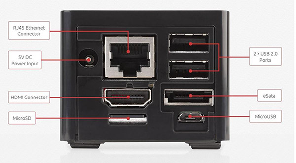

I have been digging around and the streamer board looks to be based off a Cubox which fits the metal enclosure on the left side of this pic:
And the I/O is the same except upside down:
Cubox:
Not familiar with this, imagine it is something like a Rpi, obviously there is more to the overall build than just this box like software and other components used to run the streamer functionality, might explain why there is a need to use a USB cable on the exterior to connect?
There probably isnāt that much more to it. Thatās a full blown PC not a Pi and the shield and external USB is to minimize noise inside. The second best way to keep noise from getting inside is to shield the hell out of it if it needs to be inside. Looking at that pic, thatās 90% reclocker and 10% streamer!
