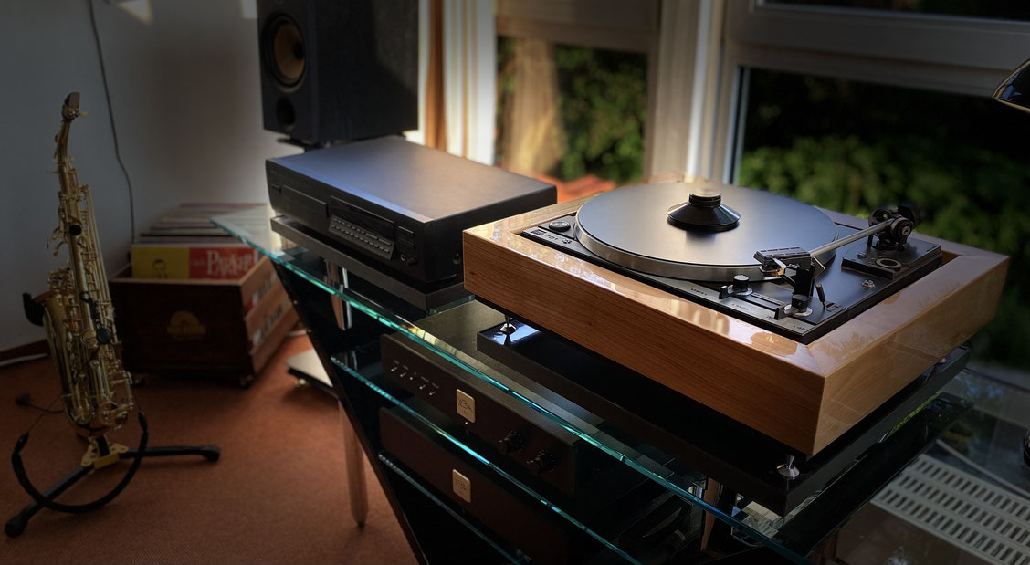

I was looking at making a plinth to replace the stock plastic n’ fake veneer one. After a bunch of mental gymnastics I decidee the style that suits me best is the one pictured below from the site @Deleeh posted.
Doing a little research on the best way to build a plinth is a prime example of why its called a rabbit hole and it offers a peek at just how far fetched and deep vinyl goes. Tons of DIY, math I dont understand, resonance and transfer charts, forum threads starting from 2009, and totally opposite viewpoints with “calculations and evidence” backed findings. To be honest, a lot of impressive stuff, but as soon as one person says something there is another with a counter point. Statements such as “You want your plinth to be as dampened as possible, no such thing as too dampened its scientifically not possible!” Follow by “i dampened my table to the max and now it sounds dead and flat. I undid some and now its great!” All mass! No mass! Even for materials there are long lists of plys, composite, sandwich techniques people swear by. Ever hear of panzerholz? I didnt until yesterday.
To keep my sanity I chose a design and materials that should be pretty decent, following some universally “agreed” upon concepts. It should be decently dampened and with a lot more added mass, but nothing crazy.
It will be 4 sides of chunky chunk flamed cherry with a channel cut on the inside faces. This channel will allow me to insert the mounting plate that the main turntable chassis sits on. This plate will be a premade sandwich of richlight and birch ply. The richlight is said to be pretty dead and the birch ply has been a standard for a long time. The main chassis then sits on top of this via 4 springs that probably mostly nullify the plinth anyway. I will have to see if leaving the bottom open is viable, ill have to see what feet to use.
But that is my plan unless it turns out this part of audio is not for me.
