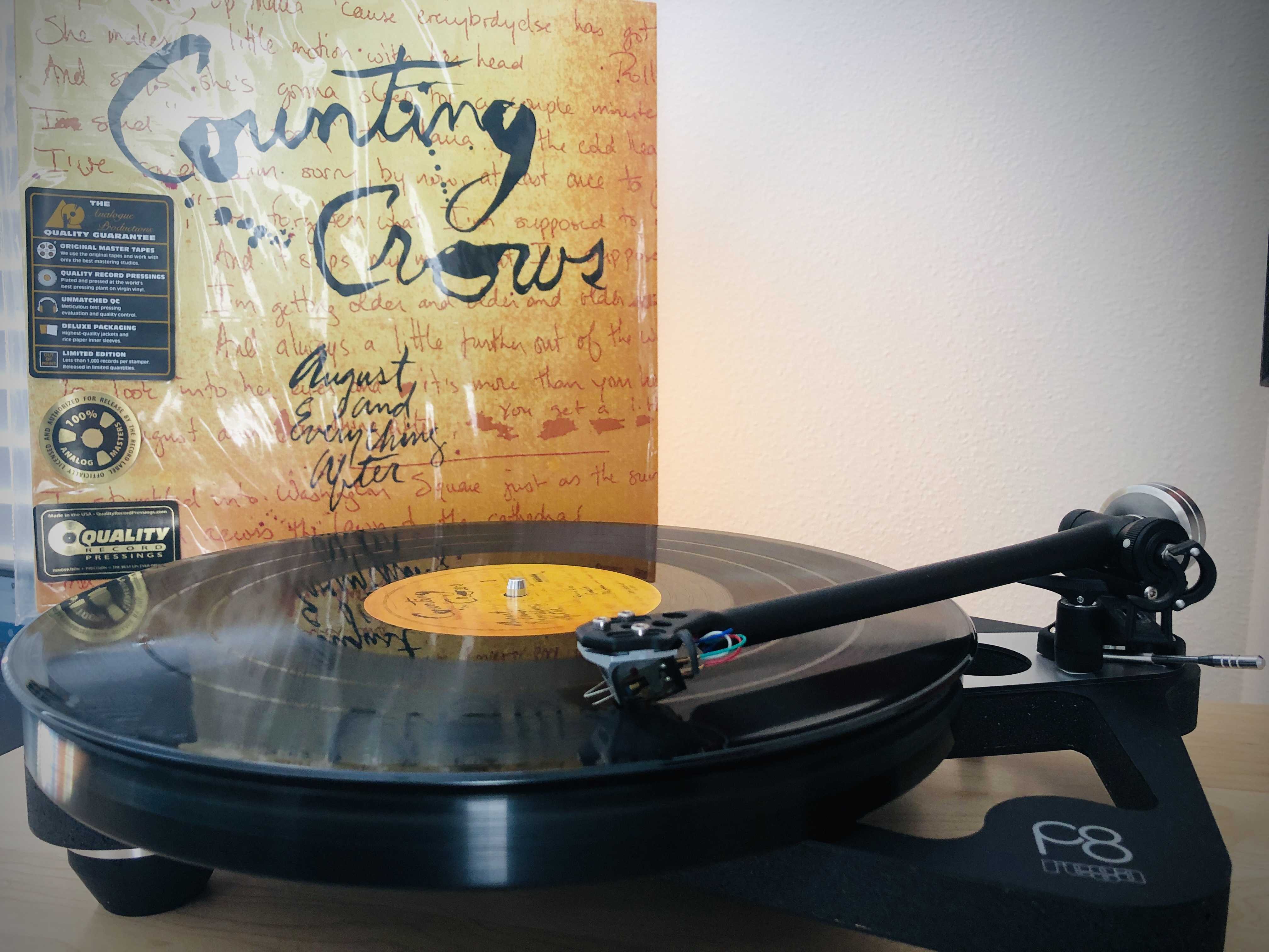

This is what I use. It’s turnkey so easy for me, but I haven’t invested enough into vinyl to know how much better it can get. The biggest issue is that currently I’m headphones only, and vinyl on headphones is just a little odd to me. The pops/clicks are a bit too prominent despite record cleaning.

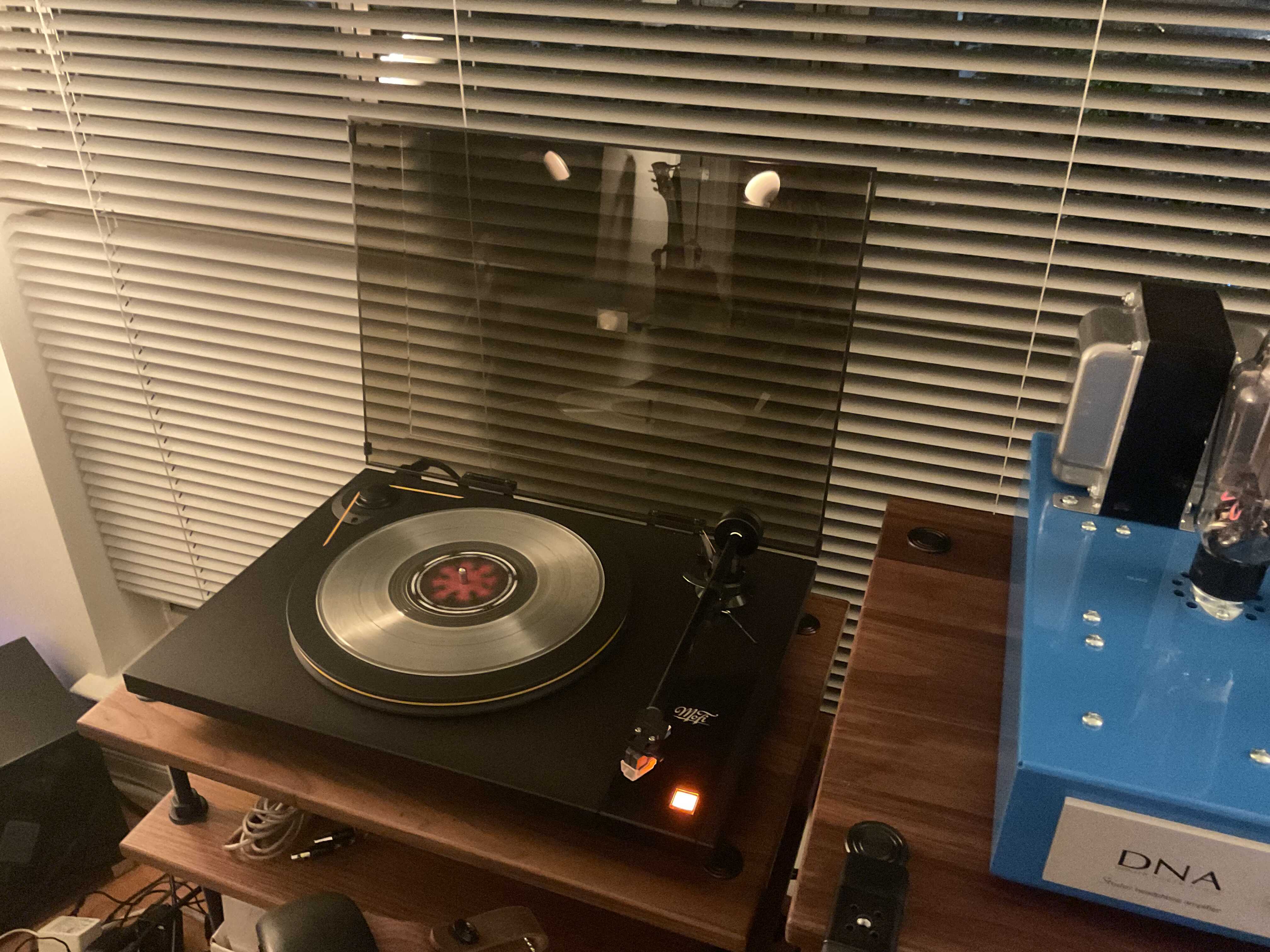

This has been my second go with a turntable set up, my first was on 2008 and I failed miserably at not understanding some basic keys to turntable set up. Putting too much money into a table without regard to cart, tone-arm, and phono stage matching was the death of me along with applying a mindset where I attributed the wrong noise as problematic.
This is a MoFi StudioDeck upgraded with their MasterTracker cartridge, phono stage is a Musical Fidelity X-LPS V3 which can handle both MM and MC carts. Why did I go for this table and cart combo? Ease of use, flexibility in matching with phono stages, and dead simple set up in regards to VTA, VTF, and Anti-Skate. Dead simple!
