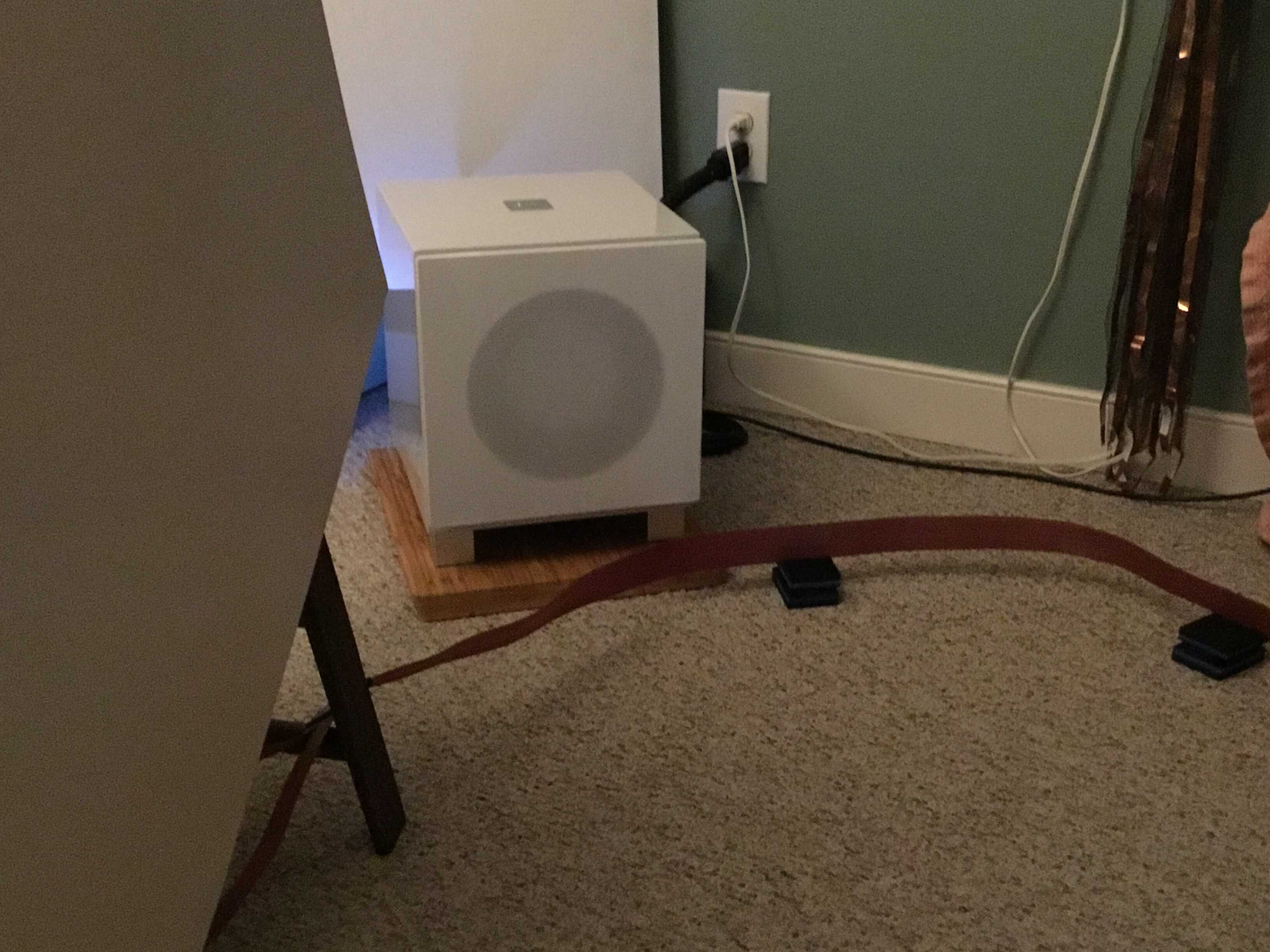

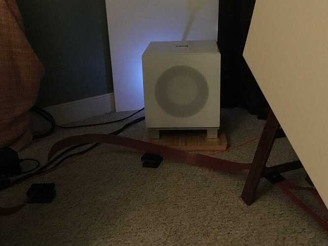

I’ve gone back and forth with my REL subwoofers in my smaller room often, taking the wooden blocks off and running them straight on the carpet. My subs in the main room went onto subwoofer stands and have been preferred that way since, same w/my sub that brings in the bottom end on my desktop set-up, massive butcher block under it and i honestly prefer how it hits that way.
My smaller room w/ its thick berber rug though i have found myself going back and forth. This room has different resonance from the other rooms and i like the slightly softer bass output the subs seem to have coupled directly to the floor. The bass feels a bit tighter using the large butcher blocks under the subwoofers, which by the way have passive radiators under them. Sometimes i prefer the tighter bass, sometimes i get in the mood for the “thicker” sound without the butcher blocks. :person_shrugging: It’s a thing though, don’t take my word for it try it yourselves. No need to spend big money on butcher blocks, order a pair from IKEA, they do the job…

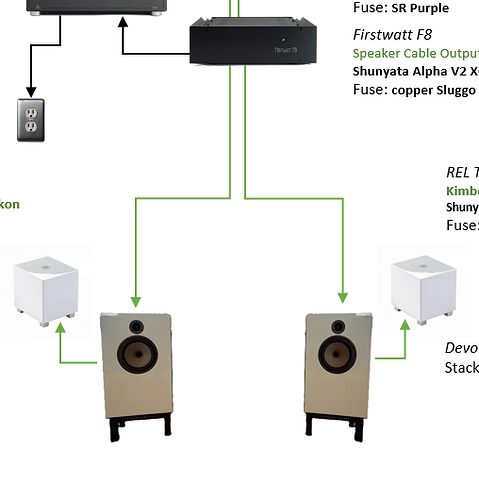

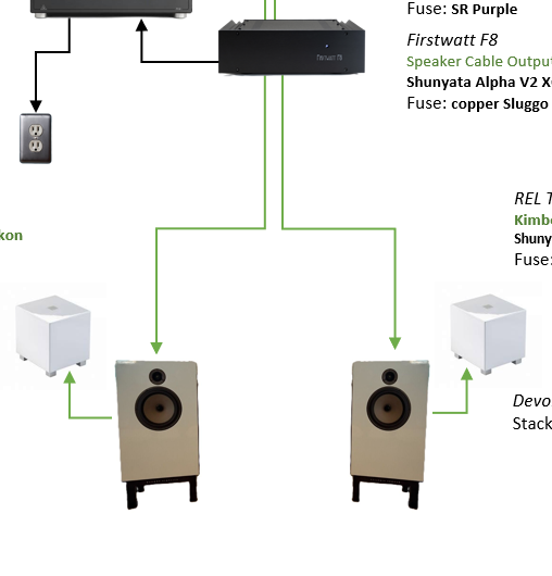

If you have dual subs and you use high level signal input for them, wire them thus:
I hadn’t bothered to because my previous speakers simply wouldn’t have been a straight forward wiring thing but it is a recommended best practice from Rel. There’s plenty of room in my new speakers and the WBT terminal easily accommodated the wiring. What an immediate improvement, it’s as if the sub inherited the characteristic of the speaker cables. Perhaps the most impactful low dollar change I’ve ever done.
This is best implemented with dual subs as a single sub would be a bit cloodgy to wire.
