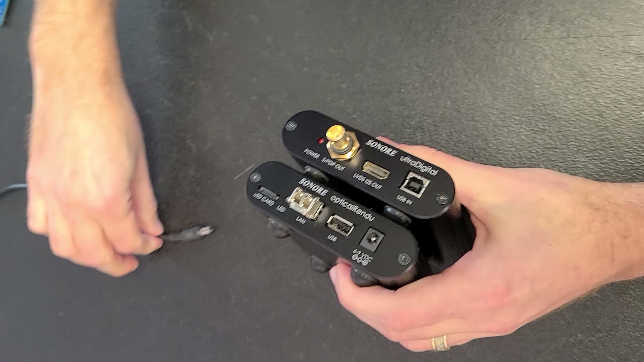

Nice view of the internals of the Sonore ultraDigital DDC.
XMOS USB, 2 clocks, what looks to be a small FPGA, voltage regulation, and a few things I can’t identify from that angle.
I bought one so will take a close up photo when it arrives next week
I’m mostly interested in what the Xilinx part is, I’d assume it’s one of the FPGA’s with an embedded ARM part, and what the line of parts in the middle at the back is.
FWIW if they are really doing all the digital conversion with that FPGA, and it’s well implemented it’s likely going to be quite good.
Can’t read the part number on the Xilinx part well enough to identify it.
The Xilinx part is a CPLD (which is like a small FPGA without the RAM cells), so it’s basically hard coded logic to convert the output from the XMOS chip.
The larger chips in the middle are galvanic isolators, the smaller ones above are opto isolators.
The one at the bottom above the HDMI port is just a driver IC.
With my zero understanding it looks like a clean design with minimal waste, no?
Short version, the XMOS chip probably does most of everything, it’s the USB interface, but it’s also a CPU, it’s what the vast majority of DAC’s use for USB input.
There is a lot of isolation, looks to be mostly between the XMOS chip and the CPLD, hard to tell where the optical isolation is used from this side of the board.
The dip switches basically pull IO pins on the CPLD hi/lo and that changes the logic that’s used to output the I2Sto the DVI port.
2 clocks on the CPLD, those, will be audio clocks one for 44.1 and the other for 48 derived frequencies.
Driver chip just effectively makes the voltage correct, and guarantees there is enough current to drive the output load.
But yes looks well engineered to me.
