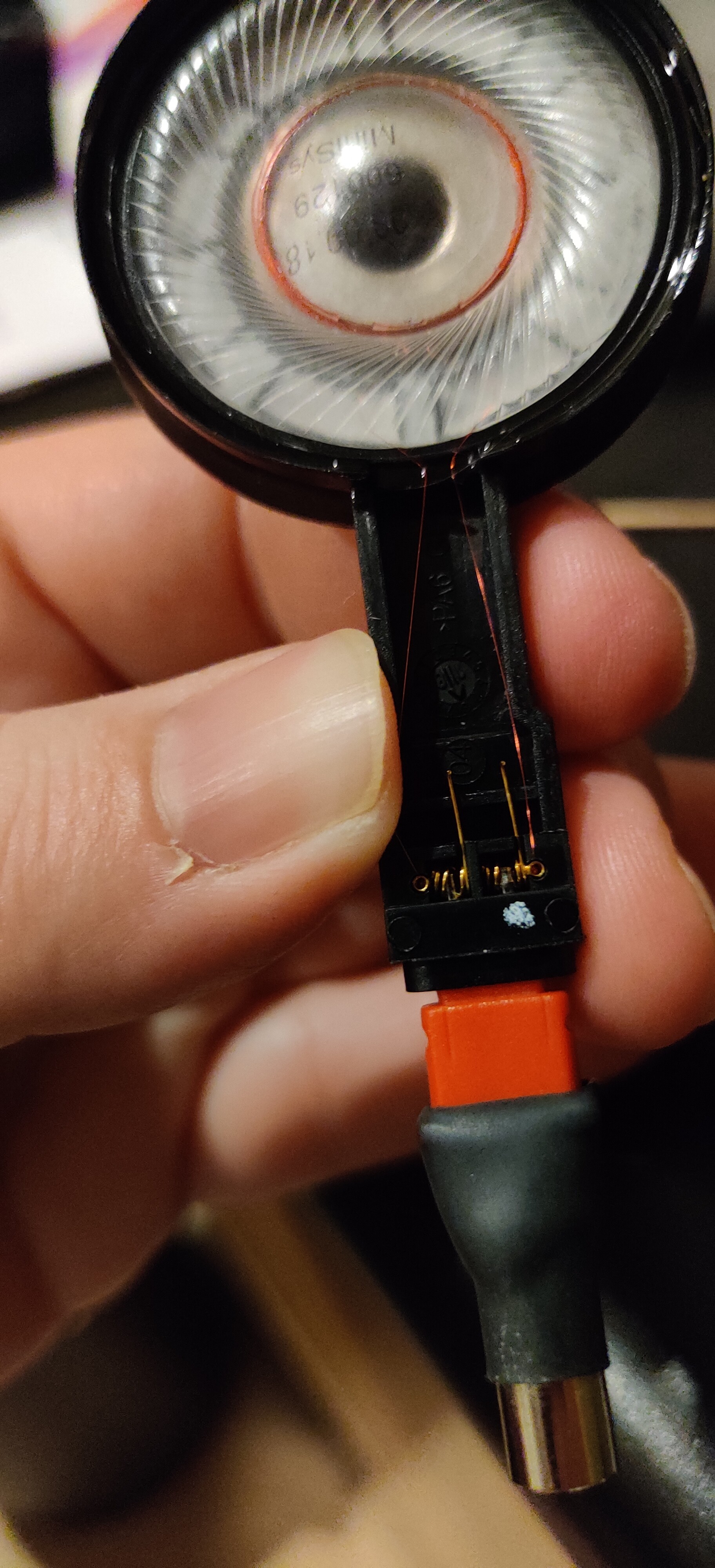

I will need to check the connections as they were staticy and cut out if moved or touched with the bulkier adapters and cable, the stock cable worked perfect.

Anyone have experience with disassembling the headphone and rebending the cable pins into shape? It looks like there is an innerfidelity video from the old days but seeing if anyone has done it first hand.
I used the Tyll video and was able to pop off the driver lollipop assembly, the 4 clasps golding it on can be a pia so i only dis the left side.
Pictured above you can see how the springs inside make contact with the plug. They got bent wide enough to not be making great contact so i used tiny flat head screw driver and pushed them together a few times and held each side for a minute. Got to be careful around those red leads as theyre delicate and cannot be repaired. The springs also like to want to pop out.
But in the end it seems that was the fix needed. Left side no longer cuts in and out or has any static. The adapters either had enough weight or leverage to make a bad connection.
