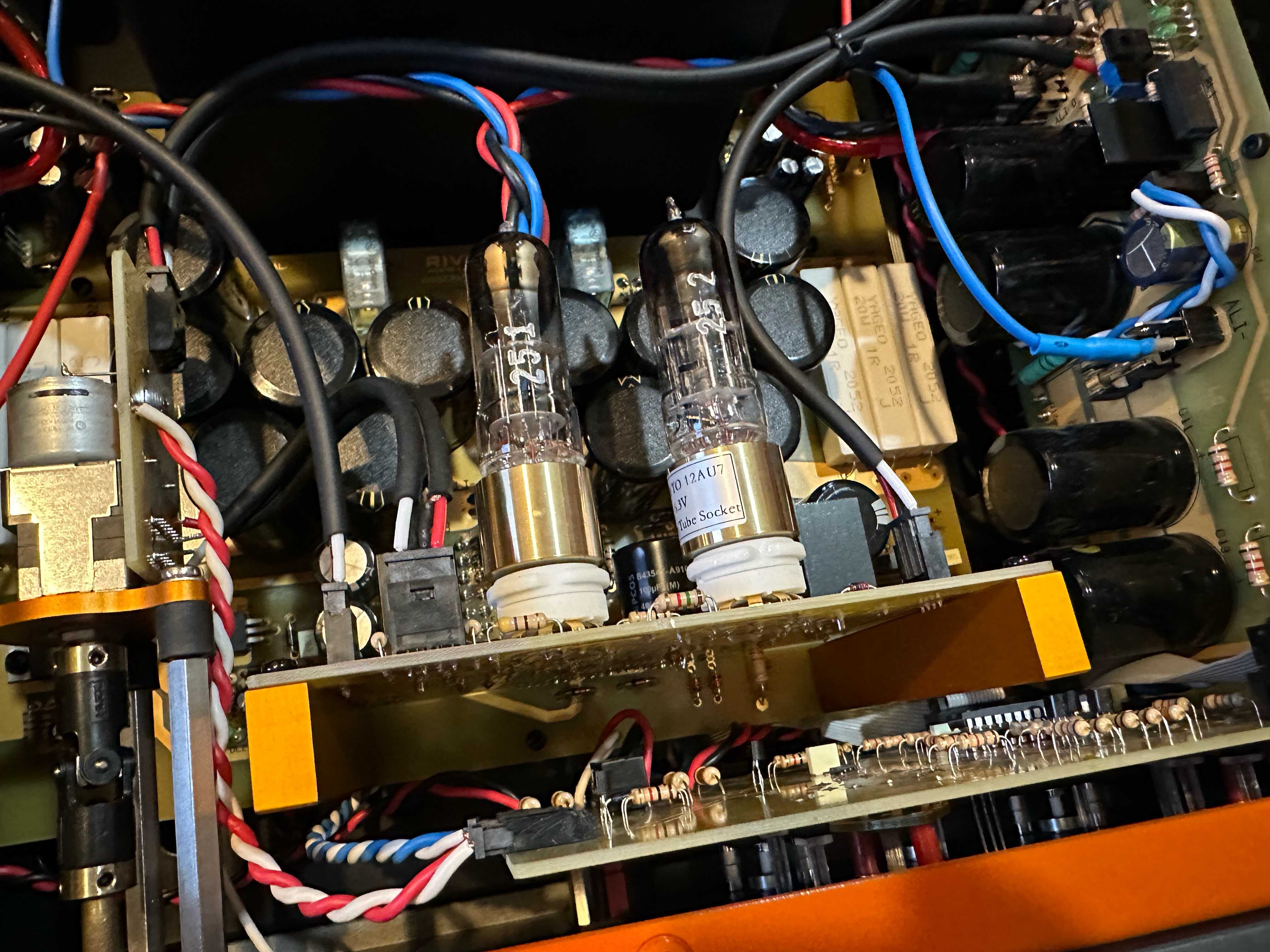

Photo from lampi hq
Interesting I know the Pentode based Lampizators have a different volume control design that alleviates at least some of the issue.

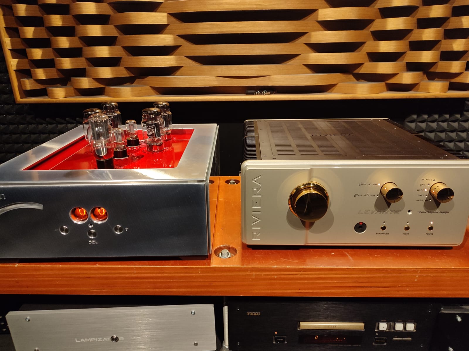

Got to hear Levante at @orrman place this weekend and directly compare it to AIC-10 with the same tubes, cables, and everything and figured I would post some impressions.
The Chain:
%%{init: {"flowchart": {"htmlLabels": false}} }%% graph LR K50[Antipodes K50] Lampi["Lampizator Poseidon<br> RCA 5u4g"] Levante["Riviera Levante<br> Dual G73r"] AIC["Riviera AIC-10-Bal<br> G73r"] Sus[Susvara] K50-->|FTA Sinope| Lampi Lampi-->|DHC Chimera XLR| Levante & AIC Levante & AIC -->|DHC Prion 4 Speaker adapter<br> -> DHC Chimera HP Cable| Sus
Everything was powered by Niagara 5000 with the only difference between AIC and Levante being Levante used a Riviera Power cable while the AIC used generic hospital grade one.
The Comparison
All of these notes are talking about on sus since we didnt use any other amps on the speakers to compare against. I would say the absolutely dominating trait of levante is “ease”. No matter what it does and what’s being ask of it, it sounds utterly effortless above the level of just having good flow or liquidity. I would call it a little relaxed as a result, but its in the absolute best way possible.
Compared to AIC (everything the same except for amp power chord from Niagara), clarity is a step up and stage is clearer as well. I am mixed on if stage was larger or not on an ultimate scale tbh, but I will say that levante utilized its stage more commonly. I do think that levante is a bit more relaxed than AIC, but in a way that feels like a direct step up from AIC, not in a bad way. AIC felt more likely to compress music slightly in comparison which gave some better slam and incision at certain times, but felt less true to what the music wanted.
Ultimately, same price for same price, levante is the very clear winner to me. I’m not exactly sure how much more I think the levante needs to be to not justify it for sus, but my gut check is if its more than 15-20% that would feel like pushing the limits for me. Obviously in terms of speakers its not the same math though.
