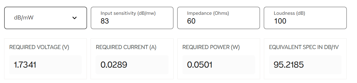

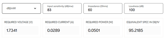

It probably has plenty, despite internet discussions that claim the Susvara needs Watts of power, if you do the math 1W is lots more than it needs, you can run one off a Schiit Magni, with plenty of volume, and no clipping (I’ve done it). It doesn’t sound particularly great of the Magni, but that’s not a function of power.
While I will admit that generally more powerful amps tend to work better with the Susvara, that isn’t at least directly a function of power or current for that matter, you can do the math and determine that
The argument will degenerate into headroom, with people claiming they need 20dB headroom and the numbers do start to get into Watts with that but it’s just not true 20dB of headroom would be 10x louder peaks than the average. 3 or 4x is is a lot more likely.
But at 120dB’s you do really need 5W while going deaf.
If you instead say only need 110dB’s which would still be way more than you probably want, you still only need 1/2W.
Exactly why some amps perform better with the Susvara, I don’t honestly know, but it’s not specifically power or current delivery as a lot of the internet would suggest, at least not in any obvious way.
It may be just that more powerful amps will have different distortion profiles, when outputting a fraction of there designed power, or it may be that amps with more gain have higher slew rates, and perhaps that has some impact, or perhaps the nature of the ultrasonic ringing on an amps output is different when signals are small.

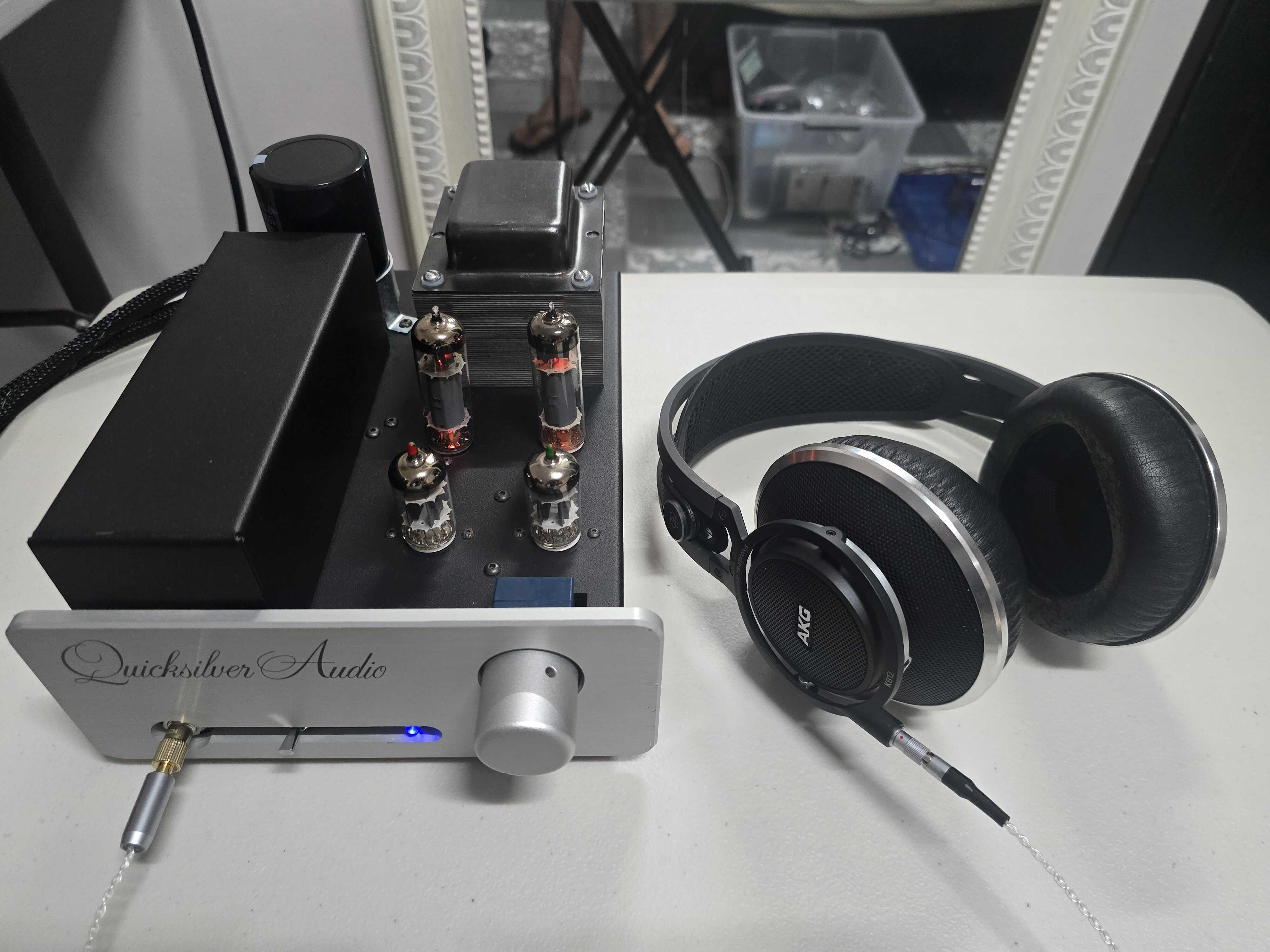

I have finally found my favorite pairing so far with my QSHA, Synergy is truly a thing of beauty. And still got some more to test!
The amp is way more transparent and detailed than I could ever imagine.
6BQ5 - Telefunken pair
12ax7 - RCA Branded 60’s amperex pair (I think)
