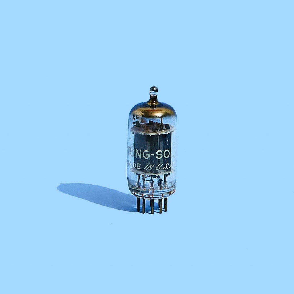

this seems good right but they say it can have any logo?
yes is the Nos Tungsol,good find.The price is crazy good.
It was common for manufacturers to provide other manufacturers with tubes, that would be rebranded.
So you’ll see various names on various tubes. For example pretty much every 7F7 tube ever made was made by Sylvania, but they were often rebranded by manufacturers who didn’t make them.
Some manufacturers etched markings into the glass. so you can easily determine who made it where and when. But often you have to go by the construction of the tube.
Some tubes are now rare enough that people will grind off the original markings, and fake them, so if your buying from random sellers, it’s worth knowing what to look for.
I’ve got a bunch of nice EL84s for sale over on Head-Fi. They’re my leftovers from when I had a Quicksilver. Let me know if any of you are interested in any of them, and I’ll give you a better deal. Here’s the link:
the logo should be irrelevant then right?
I’ve seen speculation that there is some quality variation in say an Ei branded Mullard tubes vs the ones Mullard themselves sold for example, but in practice yes all you care about is the construction of the tube ad secondarily where it was made. Not who’s name it was sold under.
