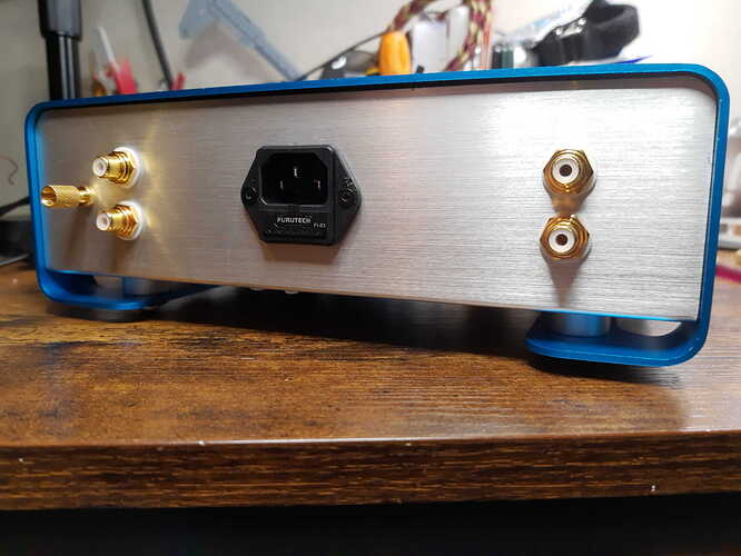

Further to this subject, I completed my phono preamp build this week. I went with the Emerald.
A relatively straight forward build with discrete channel each with two single channel opamps, presently OPA27 although I may experiment with that later once it has settled in.
Some build pictures:
One channel:
All components mounted in chassis and wired up. PSU is a 25VDC toroidal transformer. The rectification circuits are on the pcbs:
Chassis rear:
Completed preamp:
I picked this preamp for two main reasons: the near full channel separation and the simplicity. I feel that it is easy to over complicate a phono preamp and that fewer components of higher quality is a better option.
Initial impressions are good. Sound is full bodied and seems well balanced. Sounds good on speakers. The quality is good enough to show up flaws in a couple of my headphones that I generally only notice with flac digital recordings.
I shall enjoy it for a while before I consider upgrading the opamps. Excluding the chassis the total build cost came in at around 150 Euros - I saved a great deal by having my own pcbs printed. I reckon this is an absolute steal.
