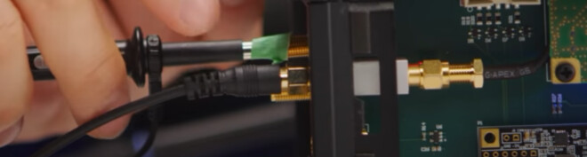

For fuck sake! Buy a BNC cable and the correct adapter!
This is LTT. It’s not them unless they’re doing something inappropriate with expensive tech people want but only they have exclusive access to
With great power comes great responsibility.
It is the little things that stick with people resulting in half-assed everything.
