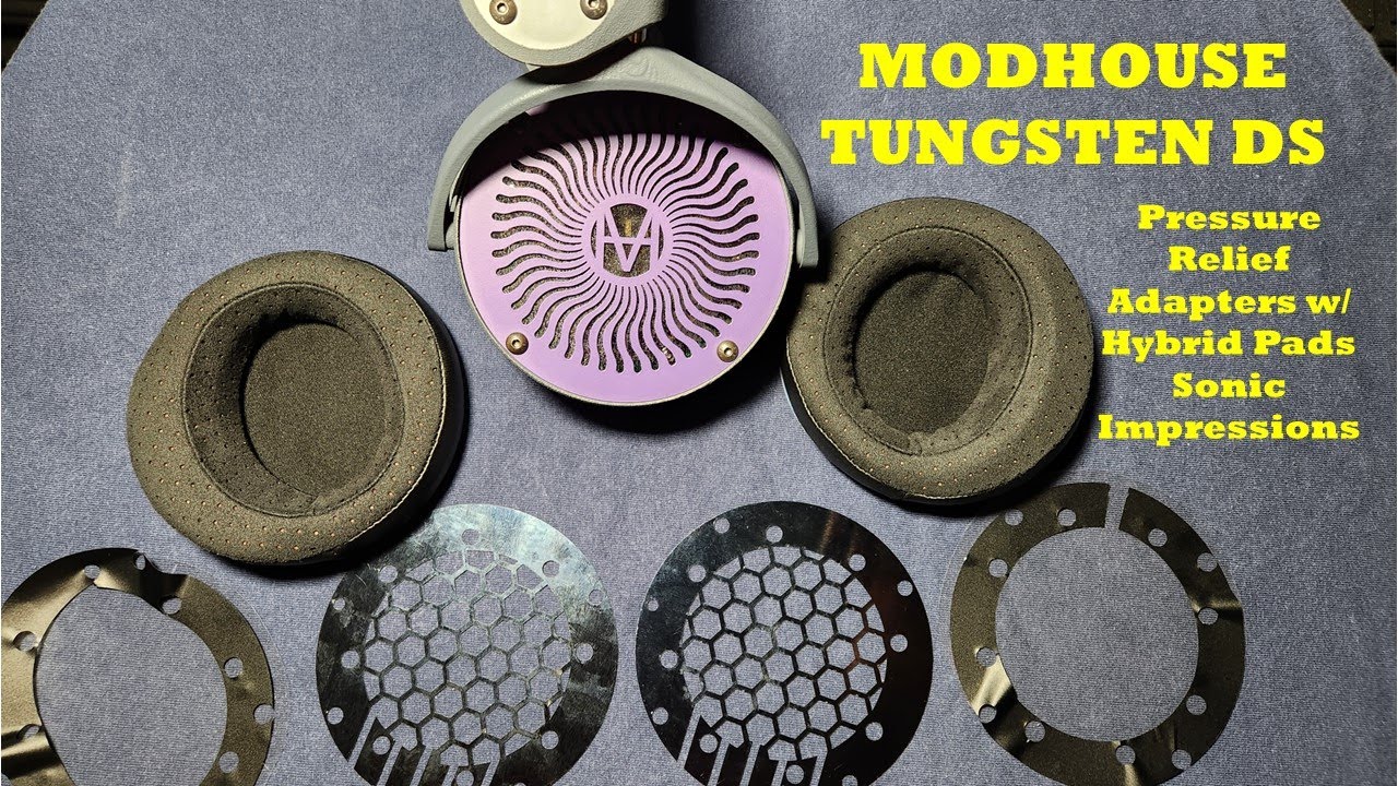

There are some other tweaks that help vent the driver. Ryan offers one which is a metal piece that sits between the driver and the pad, it just attaches with magnets. This was my preferred method of venting until recently when there’s been a 3d printed variant that vents just a lower corner of the driver. I find this effect produces a more balanced bass improvement without rolling off the sub bass or over emphasizing the mid bass. It does make the vocals sound a little recessed though. You can also just rotate the pads so that they aren’t resting around the screws but on top of them, this has the most dramatic effect but it can be too much at times. I find rotating the pads is most similar to 1266 bass with a big air gap.
Metal venting adapter:
3d printed vent adapter (photo from DHC):

This is interesting, looks like the reason why WaveTheory had some issues with the Tungsten was related to the seal, look at his impressions with the metal adapter:
