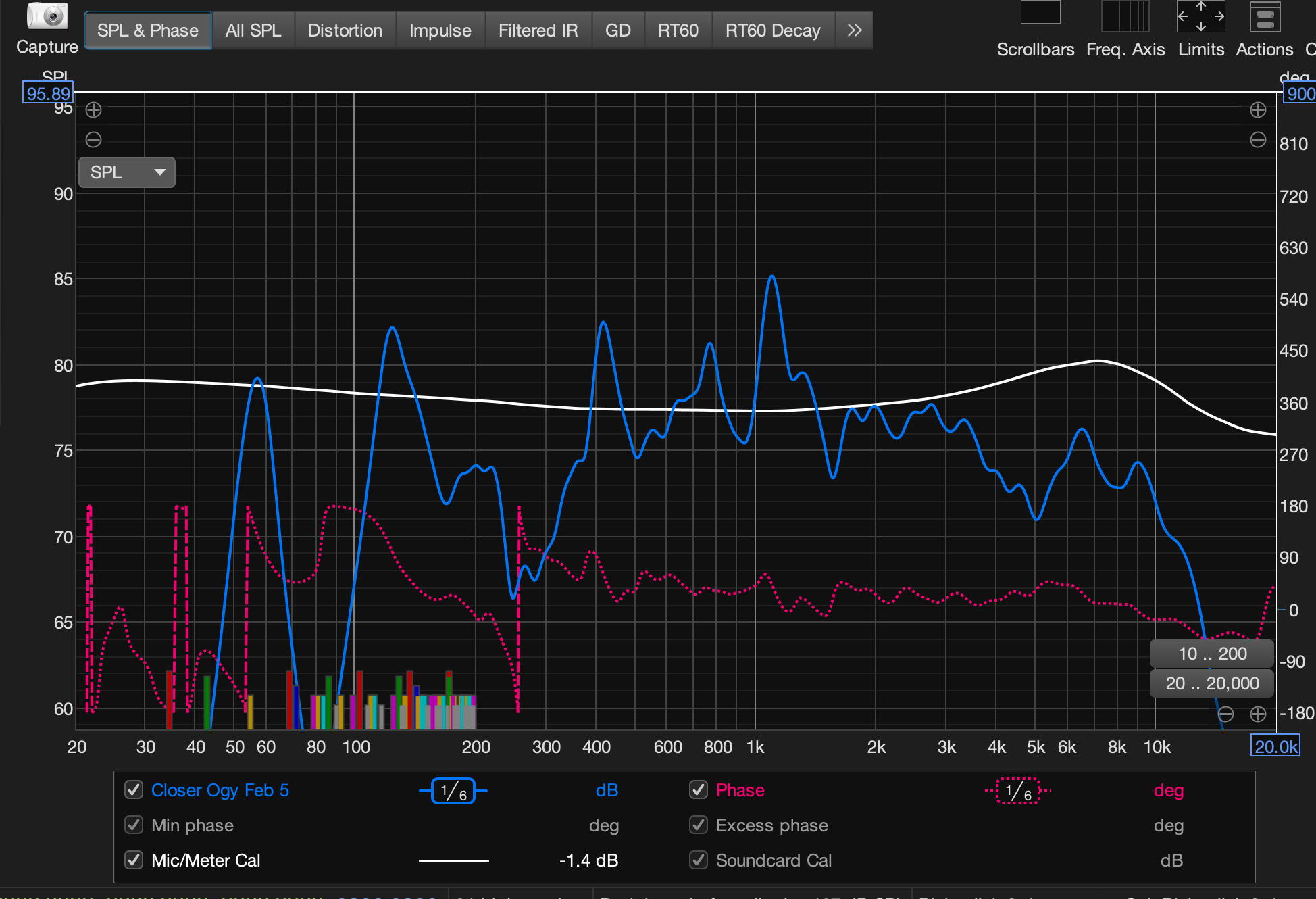

The one time I tried a full range speaker, the problem I had with it was some wonkiness in the upper mids and treble (as well as a weirdly nasal effect from a spike at 1k) that I think had something to do with cone breakup. I’m intrigued by the tube tots because I wonder if two full-range drivers might help compensate for that kind of thing. (I don’t mind not having so much air and treble extension, but wonkiness in the treble is bothersome). But I don’t know if my curiosity is enough to try them over the perfectly excellent all-rounder two-way speakers I use now.

These were the measurements I made of them in my space (with REW)

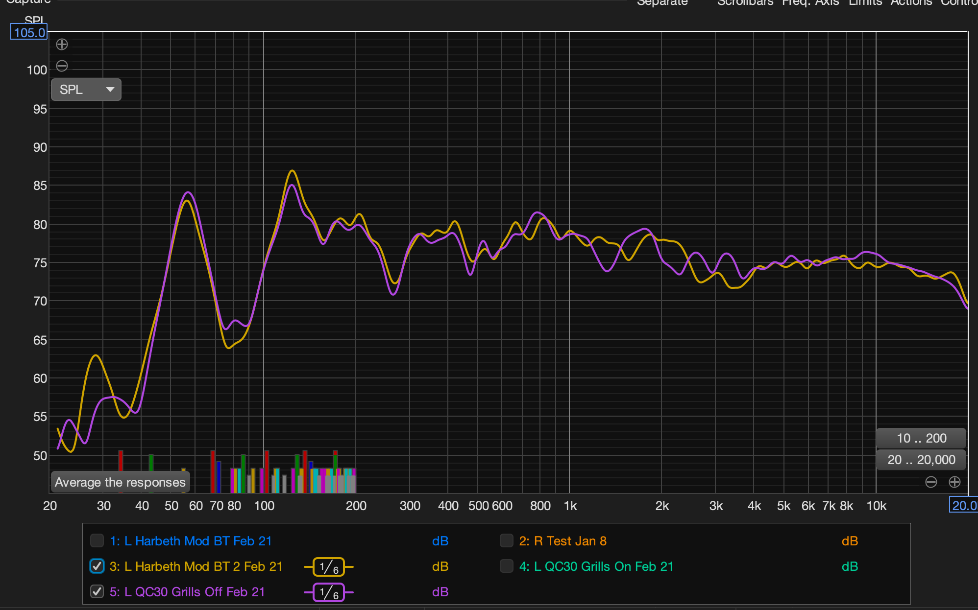

For comparison, here’s the measurements I made of the P3ESR and the QC30s in the same space:
While my space clearly has some acoustic issues, you can see how wonky the Ogy is in comparison.

Your REW measurements are of the speaker or what you are hearing in the room? There are different methods for measuring, if the former it will be not be indicative of the actual speaker measurement given it’s not a controlled space.
Assuming the latter, your issue is not treble spikes, but rather bass/room pressure. It’s more about the room interaction vs, the speaker capability.
Hi, I put the microphone where I sit and measured.
The bass stuff is absolutely an issue and there’s room modes and whatnot involved. I put a little treatment in there, and use EQ, but that’s a whole other conversation.
For the Ogy though the point was to look at the difference in how it measured compared to the other two speakers, which is to say the 1k spike and the unevenness throughout the treble. What you see w/ the QC30s and the Harbeths are the issues with the room, but with the Ogy you can see major differences that indicate issues with the speakers (at least in my system, in my room).
Yeah that’s placement for measuring your room, sure it will show you how the speakers react to the room. It’s not a speaker measurement.
In terms of the differences you are seeing are not necessarily an issue of single driver full range speakers. You’re applying the room acoustic measurements as a control for the speaker measurements.
Another issue is you’re comparing multi-driver speakers with extensive crossovers to ensure their linearity does not fluctuate as much, single driver may look chaotic under these graphs as they are simply more raw in the output with nothing in the path. That could also be an amping mix-match, which is the biggest takeaway I’ve learned in recent years as I’ve been able to borrow gear to switch in and out.
An example, for a while I thought my speakers were my biggest pain point, all the while it was the amplifiers I had initially used that was the issue. Trying out some other amps and experimenting showed me the speakers were not the issue, the mismatch of amps was the issue.
Either way it’s a moot point, you don’t like how the OGY sound. All I’m trying to say is don’t necessarily write off all full range single driver designs like the Omegas or others who design similar speakers. It’s more like a recipe and tossing in the usual ingredients may work to get by, but definitely does not make it Michelin rated.
This is a very interesting sentence and I’m not sure I understand it right. What does it mean that single drivers are more “raw” in the output? Or you saying they look more “chaotic” in these graphs because their linearity (which is to say, how they sound) is inconsistent and changes from moment to moment? That seems like a problem, doesn’t it?
