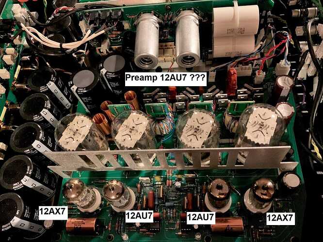

@dB_Cooper or other LTA or tube experts, can you please help figure out where the preamp 12au7’s are in my Ultralinear+ and how I can remove them?
The power amp 12au7 and 12ax7 tubes are easy to spot but I can’t find the pre tubes. If you look at the picture below, there are 2 grey cylinders at the top, with what looks like tubes inside. Is that them? In which case, can you please explain how I get them out?
Edit: I found an old email from LTA that described them as “the shielded, horizontal pair that look like two silver cans” so it must be them. But LTA didn’t tell me how to get them out. Do I pull the cylinders, twist them, unscrew them? I’ve never seen anything like this before.
Those are shields that if you look at their end have a twisting mechanism that you twist and then you’ll be able to pull out to expose the tube. Then it’s just a normal pull out replace with whatever you have and get it back on.
Thanks, I appreciate it. I’ve never seen a tube shield before and was hesitant to pull or twist anything.
I’ll try it later as the amp is on right now, testing some other tubes. I just took out the stock Ei (Telefunken clone) 12ax7’s and put in some Sylvainia grey plate triple mica 5751’s to try out.
Good luck! Tube rolling can be fun and sometimes daunting… depending on the tube the shield might not fit on it just fyi
Everything that @orrman said! Just don’t move the preamp board too much the shield should twist off and if they don’t they may be a little cock eyed, straighten it and then try again. I would even support the board with one hand to limit any movement.
I wouldn’t fool around with the power amp tubes, because I’ve only seen GE or RCA of those so there’s not much variety and they’re going to be much harder to take out so rolling them might put a lot of stress on the board.
You may need to push down towards the board a little then twist. Youll see near the base there should be a “track”, think of it like a safety lock on a medicine bottle. Hold on as there is a spring to keep tension and it can pop off.
These are extremely common on guitar amps, worst comes to worst google changing tubes on a guitar amp and im sure there will be a video of it.
Thanks everyone for the tips on the tube shields. As you all intimated, the were pretty easy to get off: a gentle push and twist. Unfortunately the first tube I rolled in the preamp section is a Sylvania 12bh7, which is much longer than a regular 12au7, so I couldn’t get the shields back on. I’ve left them off for now and there doesn’t appear to be any negative consequences.
