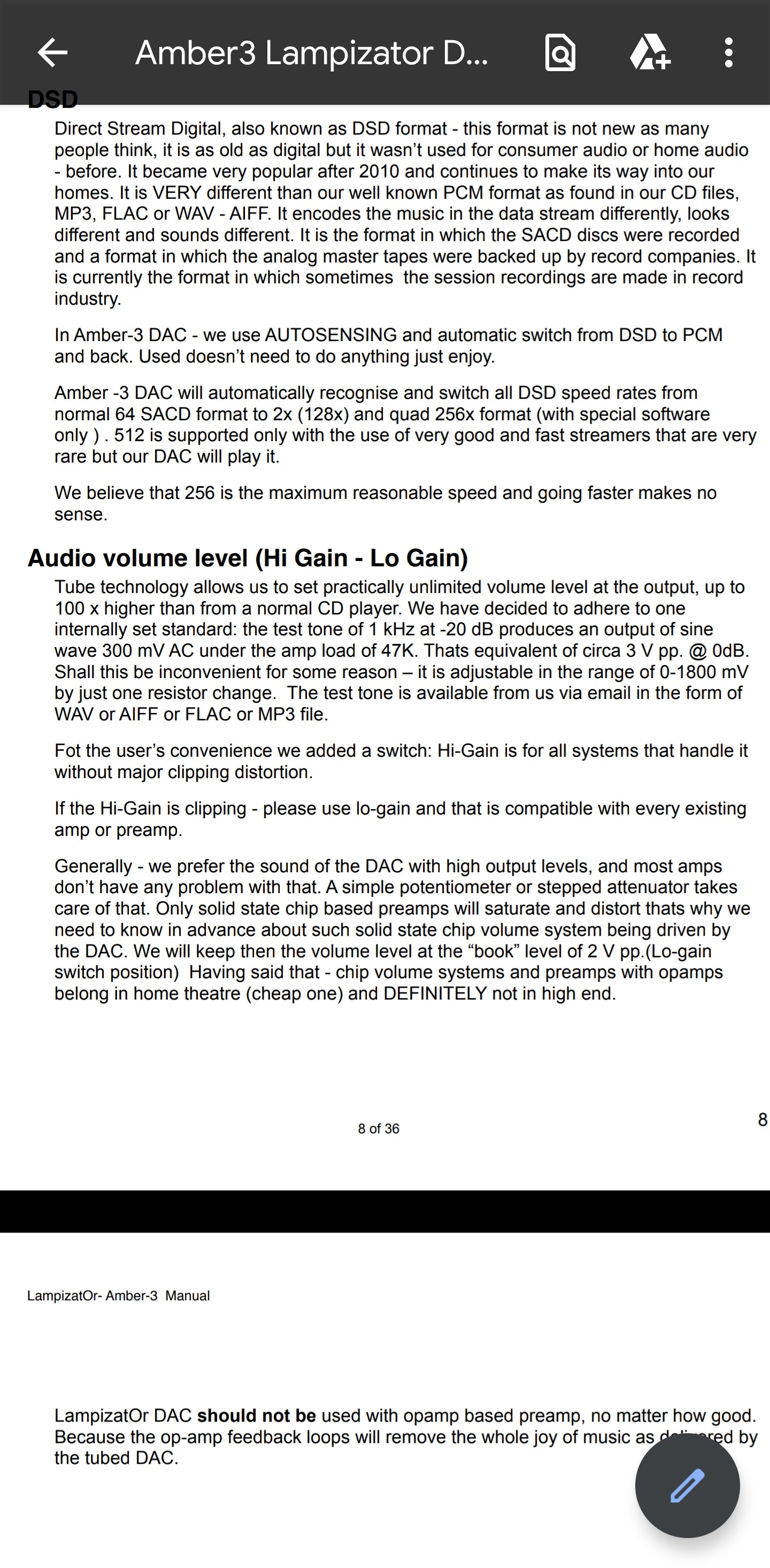

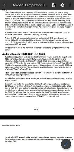

Here is what lampi has to say on the matter if you’re curious.
I personally think it sounds better in hi gain as well, but unfortunately it’s a little too hot on my headphone amps for me to use without a preamp of some sort… I refuse to use digital volume lol
Thanks guys. I think im going to to make this simple for myself and just keep using low gain. When I’m in a certain critical listening mood I may set it to high gain and fine tune the volume by hand. I figure the gain switch does a better job than an external passive would do to reduce signal.

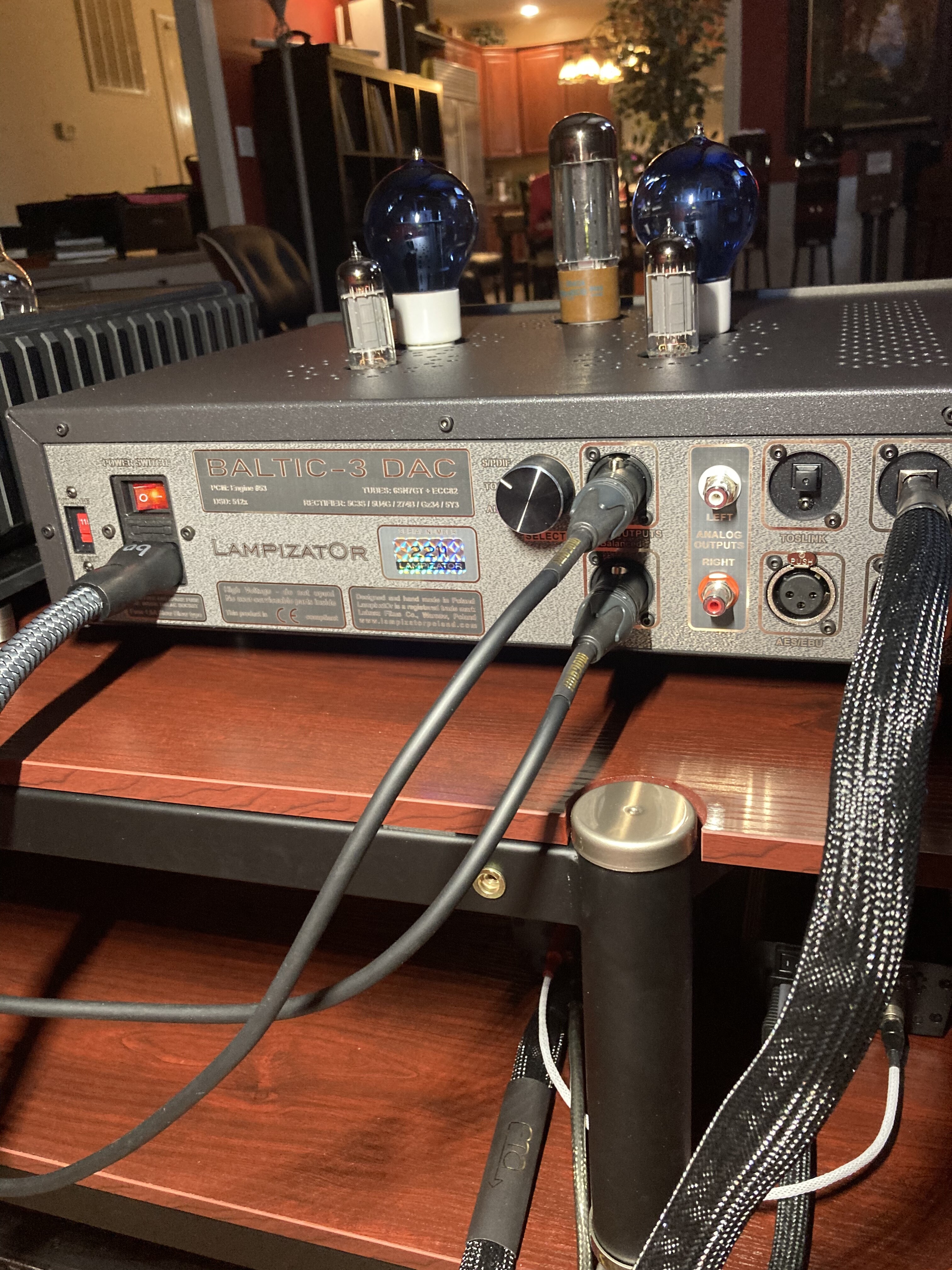

Last update on my New Baltic 3. For some reason there is no High Low gain switch. I emailed Lampizator to ask if it is now hidden or internal but I don’t have a switch for my DAC. This is a problem for me I need the damn switch because of the variety of ways I planned on using the DAC. I do not understand if the new models for some reason the choice was taken off but now I’m pissed and really annoyed. The switch allowed for much better control of my very low power set-ups which I can’t do like I wanted to now. This may be the fastest flip of a new device ever in my possession. I want the damned switch :face_with_symbols_over_mouth::face_with_symbols_over_mouth::face_with_symbols_over_mouth:
Wait really there’s no switch? It should be on the back under where the selector to change digital input is. I’m almost positive the baltic I heard had it there
You see a switch? I don’t see a damned switch. Fucking Rob @ Lampi North never mentioned that as an option or anything other than standard and Lampi Poland shows it as standard. Where’s my fucking switch? What’s the catch I don’t get? Did he make an improvement in the DAC the lasts few months and forget to tell us all about it?
There’s nothing under the box, on the sides or in the back like it’s supposed to be. I bought the damned thing new so I would have no issues and I’m now working myself into a frenzy over a stupid switch. :rage:
Huh yeah that’s really weird, surely something like that wouldn’t be an option right? Cause that would be really stupid if it suddenly became an option, and there’s no real reason to take it away? I wonder if they just made the xlr outs hot and the rca lower gain instead but that also wouldn’t make much sense? I really don’t know, that’s just strange it’s not there at all
On the lampizator site, it’s clearly there too, I don’t know what would change to have that go away
I knew there was a problem this morning, I had my volume down at 5 and it was still louder than I wanted and the low volume control I’m used to was off. I went to flip the switch to low gain and bam, I was like WTF?
It’s not necessary but it allows me to gain more control at very low volume and also helps attenuate noise on very high sensitivity set ups. Again, it’s not necessary but was really useful to me
Yeah, No idea what happened? The only custom option I asked for was a BNC plug on the S/PDIF because i like how BNC locks and an upgraded EML Rectifier to be added? That’s it…Like I mentioned, I now have emails out to both the distributor and Lampi asking for an explanation. I’m trying to chill, it’s really not a big deal, but now i WANT to know what output voltage he set the unit at.

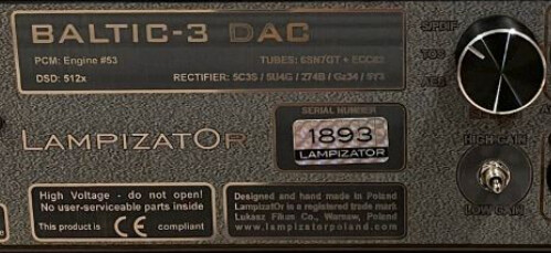

Here is the answer I just got back from Rob at Lampi North America. My question to him back was what output voltage are we at now? 2,4, or 6 volt.
Hi Nick,
That’s how they are built now.
The switch is a sound quality compromise because it uses resistors to drop down in output. If the output is lowered, the sound gets neutered. (so to speak)
Best,
Rob
So I can see that, but they should really note that, and offer to give you the option to choose the fixed voltage. Without a doubt imo the dac does sound better in high gain, and I can see how omitting that would improve sound quality, but I think offering that as an option should still be a thing. I guess their answer would likely just be to buy one with a volume control option which would be better, if it didn’t add so much extra to the price
Rob from Lampi North will come back with an answer as to the current voltage output setting.
