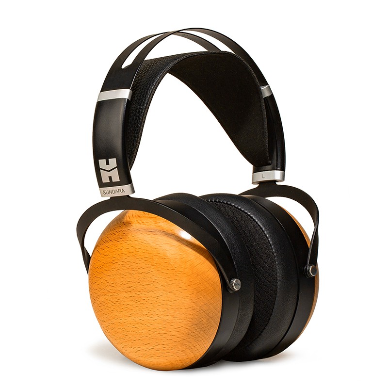

Closed-back Sundara!
Edit: Added pic
It dosent look bad at all. But it does look weird. Lol. The beautiful aluminum paired with the light wood cups just looks off.

Gotta agree there, if anything would like to see a dark wood instead there.
Reminds me of Jaffa Cakes.

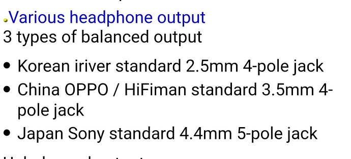

New headphone amp from a company with a funny name, tried one of their older headphone amps while I was in japan and it was great for the price, this looks pretty cool for 200 bucks, wonder how it fares
Pretty interesting how they market this
Might just be because that’s what they’re known as over there. iriver/astell and kern really popularized the use of 2.5mm for balanced in the portable market, hifiman popularized the 3.5mm balanced jack in portables (later ifi), and sony was the creator for the 4.4mm jack. So it makes sense, but yes looks a bit strange
