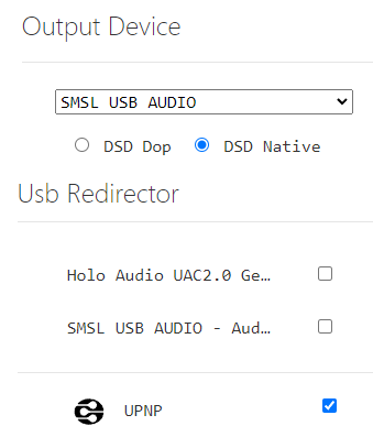

Hell in a box arrived - Holo Red. No idea what all the possible setup configs are, or what ports are ins or outs. Garbage manual. I thought this was a DAC or DDC, but apparently it’s only a DDC with digital outs… :-1: The only software I’ve gotten it to work with so far, as a streamer, is Media Monkey. It works fine via USB/Eth In, then coax out, but I can’t get USB Out to do anything but silence or static with BP DAC.
PC → USB/Eth → Red → Coax → SMSL DAC = works (Redirector off) (Holo USB Output)
PC → USB/Eth → Red → USB → BP DAC = silence (Redirector off) (Holo USB Output)
PC → Eth → Red → USB → SMSL DAC = silence (Redirector off) (Holo USB Output)
  • DAC display = “d-8” (DSD, apparently)
PC → Eth → Red → USB → SMSL DAC = works (Redirector off) (SMSL USB Output)
  • Was able to see/select SMSL as output device in Holo web page config. Is this DSD mode, or just regular USB whatever? DAC display now says “44”, not “d-8”.
    Red_SMSL
PC → Eth → Red → USB → BP DAC = 95% static, 5% music (Redirector off) (USB2.0 High-Speed Output)
PC → Eth → Red → USB → BP DAC = silence (Redirector off) (Holo Audio UAC2.0 Output)
PC → Eth → Red → USB → BP DAC = silence (Redirector: C-MEDIA) (Holo Audio UAC2.0 Output)
PC → Eth → Red → USB → BP DAC = 95% static, 5% music (Redirector: Holo UAC2) (USB2.0 High-Speed Output)
Is this BP DAC just incompatible, because it doesn’t have plug & play USB?
I have no idea what “BP dac” is referring to, but USB out I’m fairly sure only works with ethernet in. AFAIK, you need to select the USB redirector for the output to work, but it can’t stream so I can’t confirm on mine. As for native dsd VS dop, that depends on the dac you are going into, not the streamer.
As for software to see it as a streamer, you need to select what protocol you want it to use in the configuration and then set your software to the same thing
Also, you may want to test using cheap cables for now. If your USB doesn’t have 5v that can throw things off some times
Border Patrol. Only has USB input, sadly.
I will see if my USB dongle is recognized and works from Red’s USB Out tonight. I suspect the issue is just BP’s USB being so dated, that it isn’t recognized.
I would say, for sure, my sound from speakers is now obviously more natural/non-digital, smooth and liquid-like, with more resolution, than without the Red. Gets an A+ from me, sound-wise! Right out of the PC with USB.
Hahaha. Well I’m glad it sounds good at least. Hopefully you get it fully working on all outputs eventually
It needs to send signal at 44.1 or 96khz only and below. Whatever setting you have somewhere along the line is well pst that and the BP DAC doesn’t play output beyond the 96 khz. I had messed up a setting in my computer audio output one time and the same thing happened to me. Or at least i think i’m prettyclose to your issue based on my own experiences snd minimal technical knowledge :man_shrugging: I’m sorry I wish i was more technically capable to ne able to help.
Haha, no worries. Pretty sure the BP just doesn’t have the plug & play brains to work in a setup like this. Pretty sure I had to download special drivers just to get it working with direct USB by itself. Oh well, no biggie. :+1:

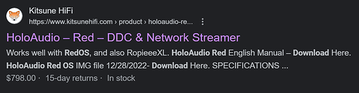

Also, a few weeks ago I was curious about reinstalling Red OS onto my Red since I switched to Ropieee and didn’t think to use a separate SD card to keep the stock OS. Then I discovered that there aren’t any easily accessible/“official” links to download Red OS. The only link I could easily find was the Red’s user manual on KitsuneHiFi. So at that point I gave up and resigned myself to only using 3rd party OS images for the Red… Until Today!
I tried my search once more and noticed that when I typed “holo red os download” into the Google that Kitsune Hifi had a very interesting link description…
There it is! “HoloAudio Red OS IMG file 12/28/2022- Download Here.”
But when you go onto the page that download is nowhere to be found. So I decided to go the inspect element route, searched the elements of the page and viola! The link which was in a DIV with “display: none; visibility: hidden;” CSS style tags. This DIV also was hiding an additional link to the user manual for some reason. I have no clue why both of those links were hidden but still baked into the page itself. I’m just happy I was able to find it so I can reinstall the stock OS.
Anyways, here’s the link if anyone else finds themselves in a similar predicament with their Red.
