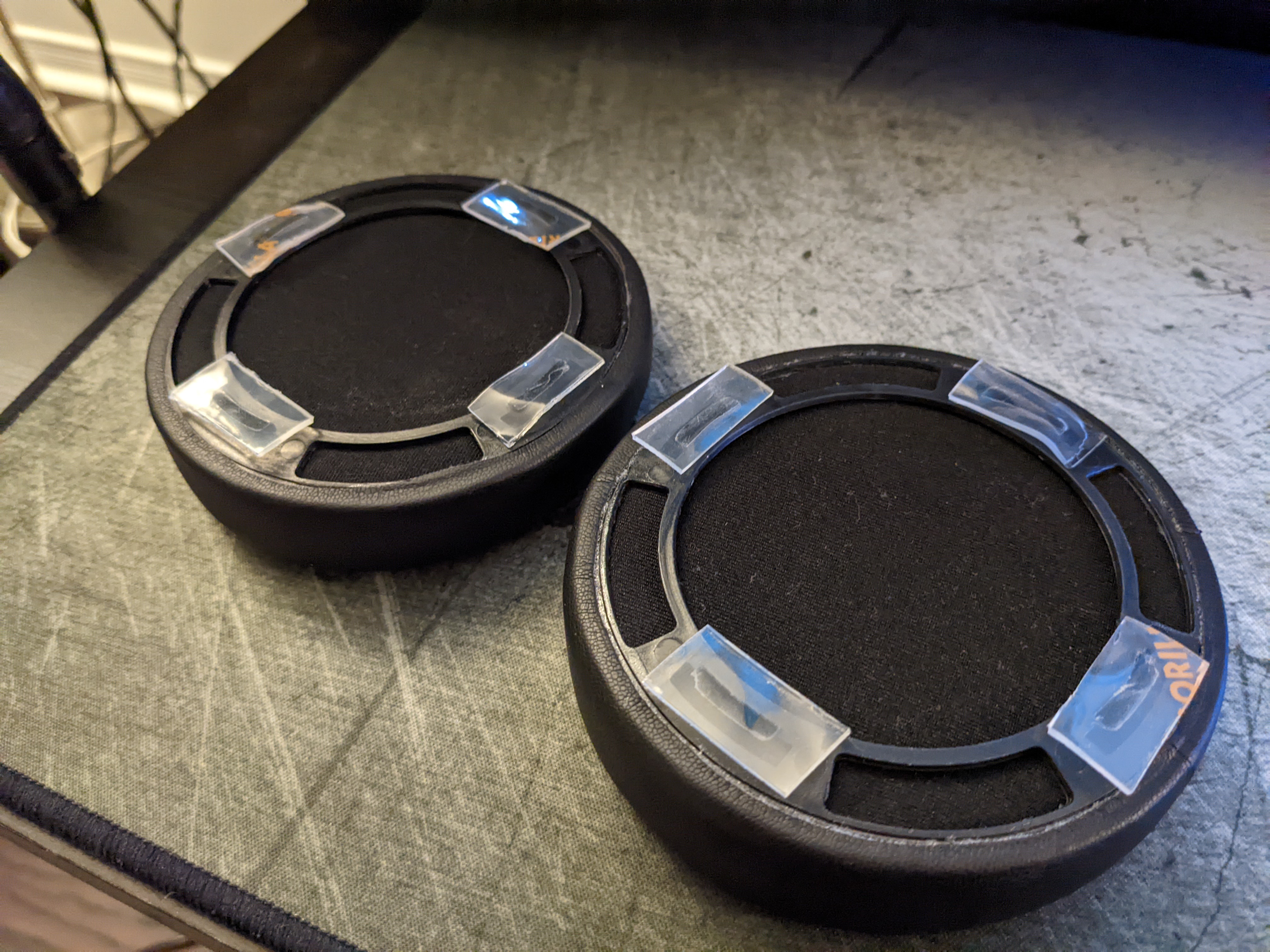

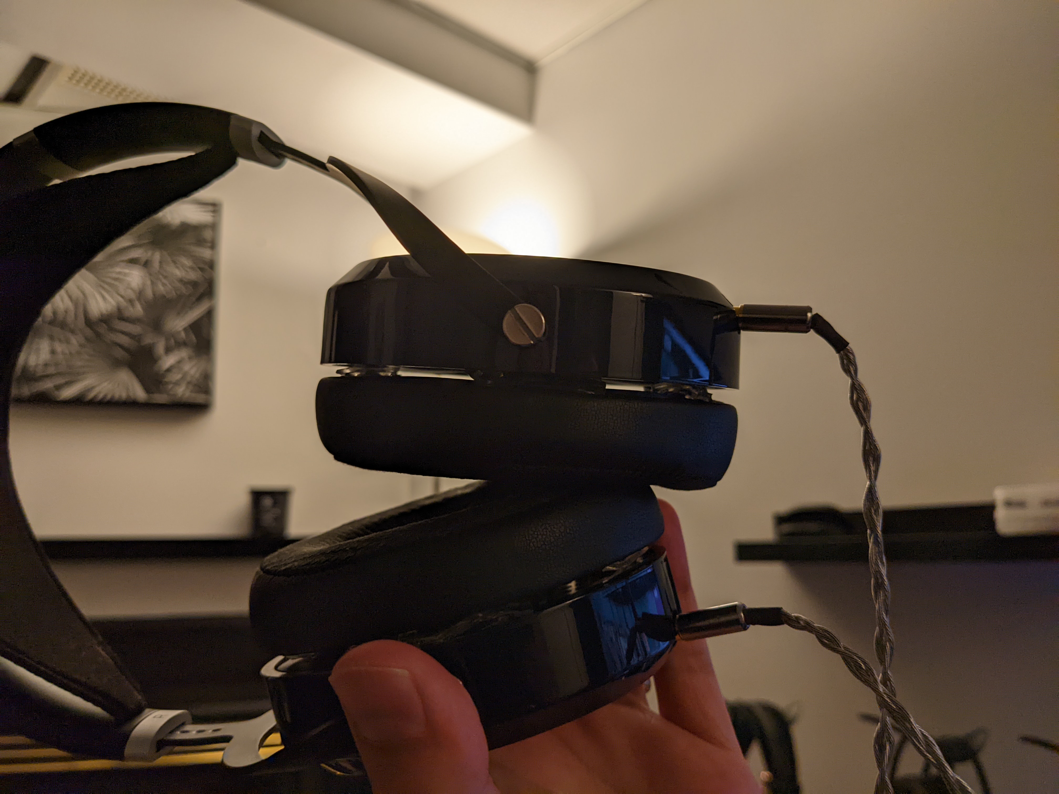

I need to share this here, just tried a bass port mod on the HE6se v2 and i am blown away by the results. Took me 5 minutes to complete the mod, just remove the pads, apply 2 layers of a thick double sided tape (i used gorilla’s) on top of the hooks and attach the pads back on using only the double sided tape glue.
This mod creates a gap between the cups and the pads allowing the membranes to move without the resistance from a seal, it is similar to what the Abyss 1266 does, not all planars have a resonance peak in the low end like these two but for the 1266 and the HE6 this works like a charm!
For real, if you like bass slam just try this! The bass on my HE6 now is only second to the 1266. Keep in mind this causes a big rolloff on subbass, so there is a tradeoff but i am happy to pay that price myself, it will depend on the style of music you listen to.

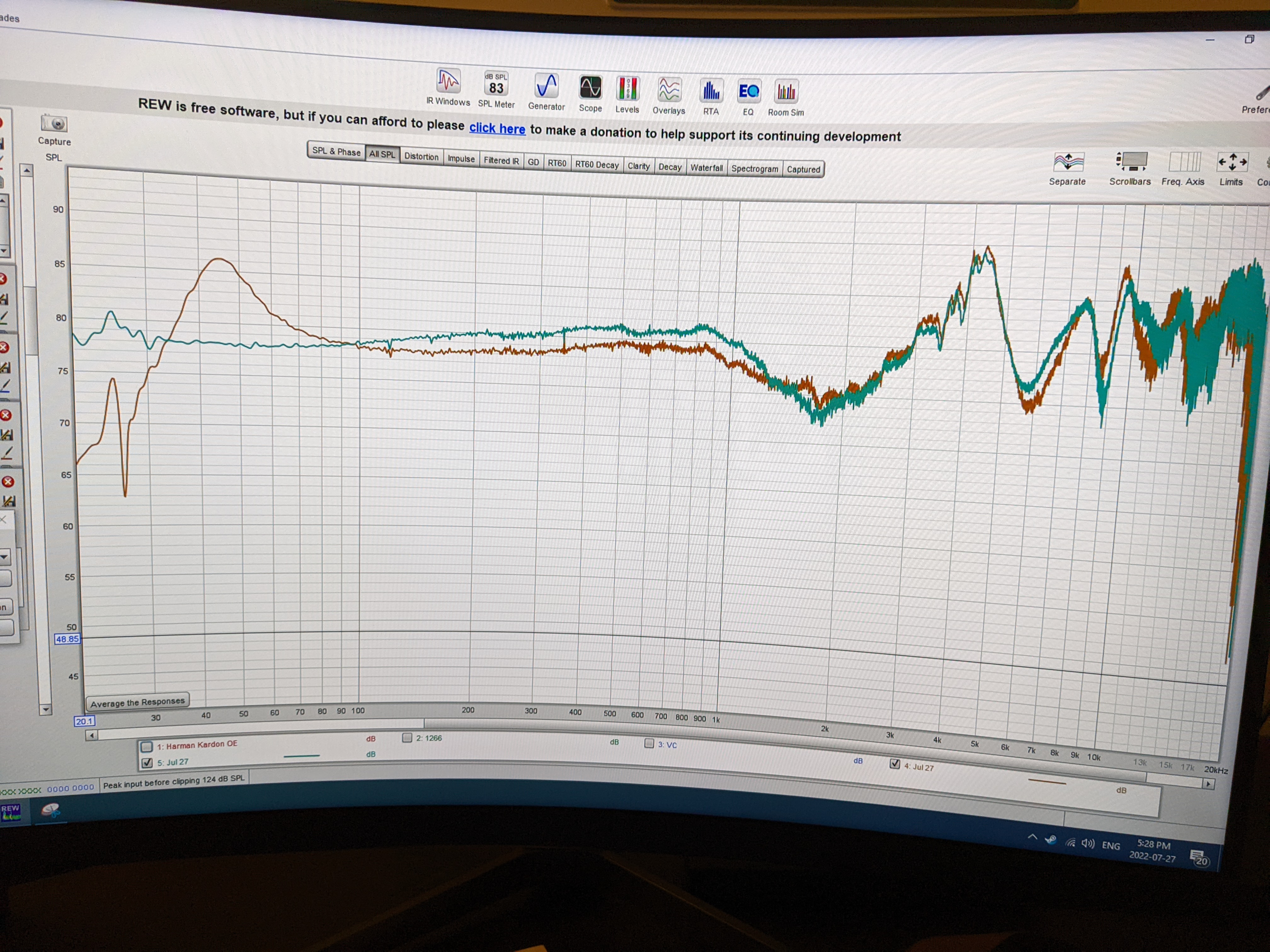

In case anyone is interested in what the mod does to the frequency response, here is the result. It is pretty similar to what breaking the seal on the Abyss 1266 does.
