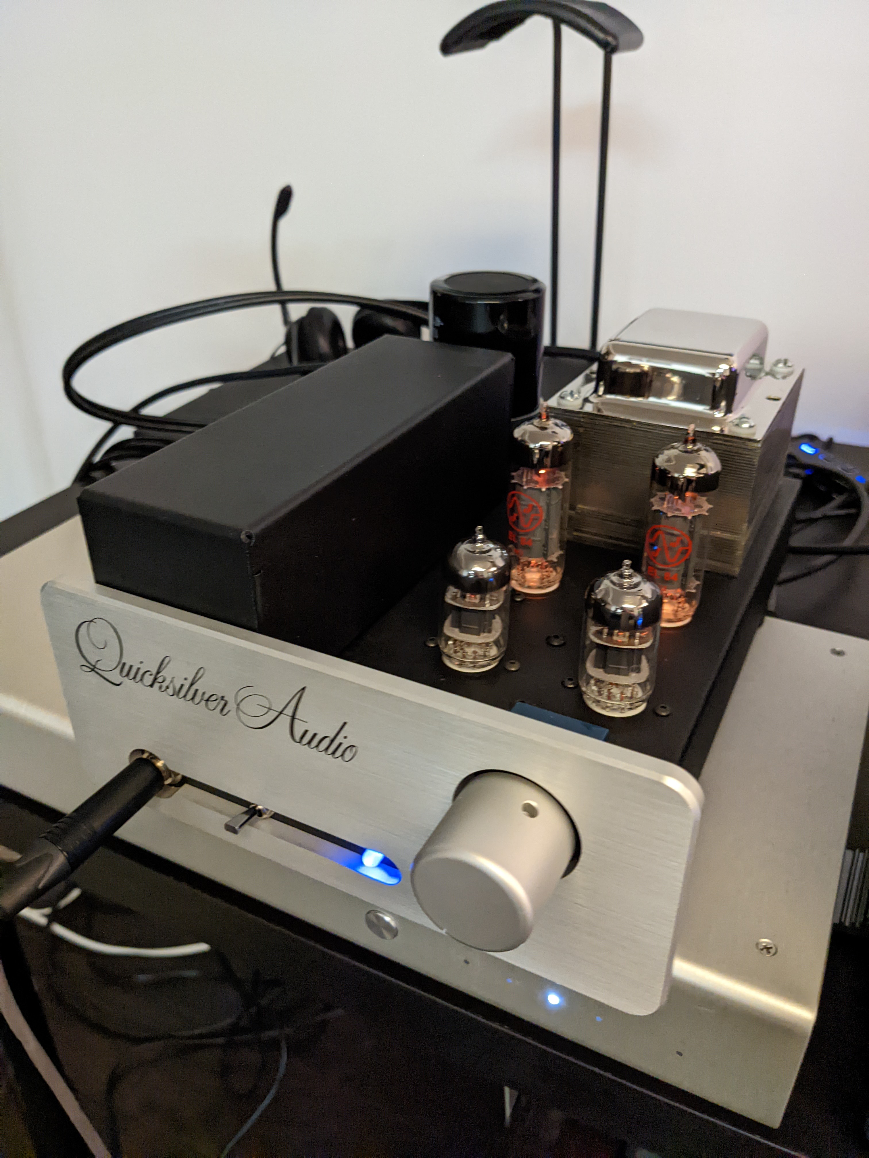

Just received the Quicksilver, only listened to a few tracks on it but i can already tell it is something special, i freaking love its sound with the VC. I canāt describe it yet but everything i like seems to be there and then something more going on with the soundstage, i have no idea what it is lol.
Thanks for the help guys, i will report back once i can say something more useful about them ![]()
Youāre in for a treat. The Quicksilver/VC combo is really great. That was my setup for over a year, and I never felt like I needed to upgrade my amp. I got the tube-rolling bug for a while, but the Quicksilver was never in jeopardy of going anywhere.
Woot! Congrats, I still have my Quicksilver basically permanently connected to my Eikon. The Quicksilver/ZMF pairing is a good one, I hope you love it! ![]()
Niceeeeeee! So jelly! Makes me want one bad lol. Maybe eventually. I bet that it really must be a great pairing with the VC!

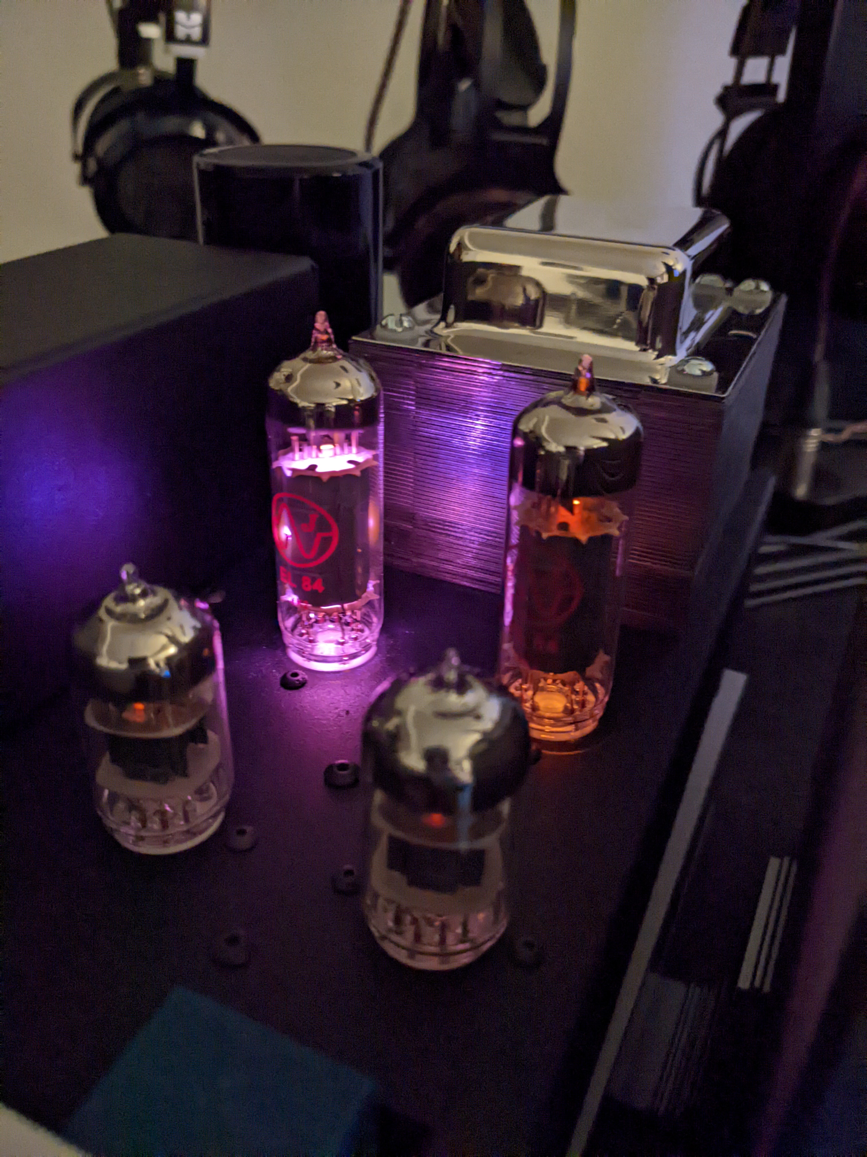

Ok, looks like i have a small problem, lol.
What the hell just happened here? Sorry, i am new to tubes so no idea other than āthis is badā. I smell something burningā¦
It turned purple before the lights show started:
Looks like the tube was damaged or leaking and its going super heated

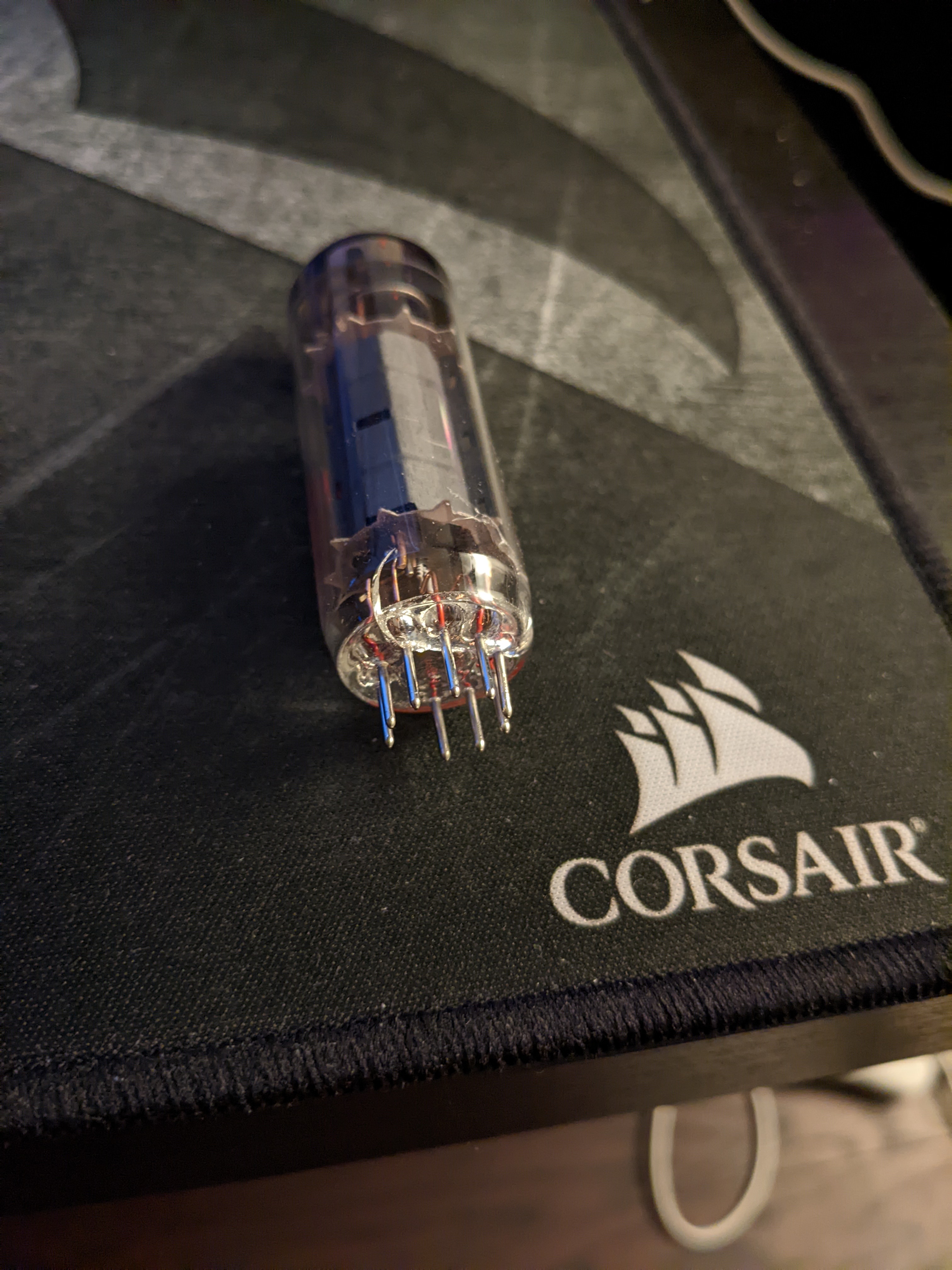

What is the best approach here? Buy a single new tube? Does it have to be a matched pair so both channels sound the same?
Also, the tube is a JJ 84 and there is a small 4k2 written on it, but the ones i find online donāt have the 4k2.
Probably not, i had cracked glass due to bad shipping on a guitar amp. It would work but i would stop it before 30 seconds as you could hear the distortion crank up as that tube overdrove itself.
Was it cracked in shipping? Any chance of getting money back for it? JJs are ok new production but this could be your chance to grab a nice matching tube outfit.
Tha tubes were fine for days, looks like it cracked by itself, not sure if that is possibleā¦
Looks like synergy with the VC was just off the charts that it couldnāt handle it. Lol
But your amp is likely fine. As explained to me when I first went into tubes, treat tubes like light bulbs. If oneās busted, just simply replace. Once a tube fails, it will be just like having an open circuit.
I wonder what would have happened if i was not there, like if i left it on while doing something else in another room. Could it catch on fire or something like that?
Generally speaking donāt keep tube amps connected and on without you being around for long times. Recipe for disaster.
It may have been a weak spot and cracked with the recent heat cycles.
They usually just self destruct, in they end they are just like light bulbs, thereās a heating element and without the vacuum, it just consumes itself.
The glass was probably stressed during shipping.
