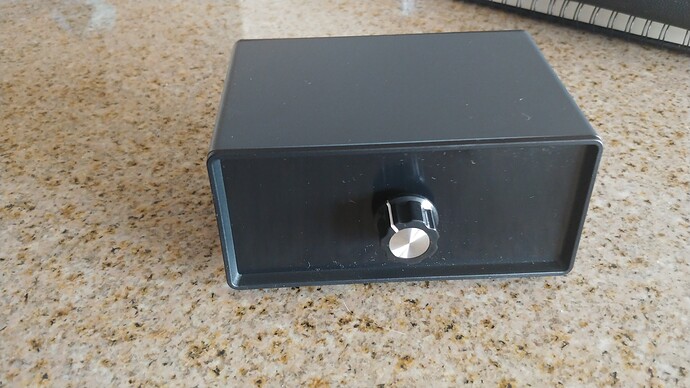

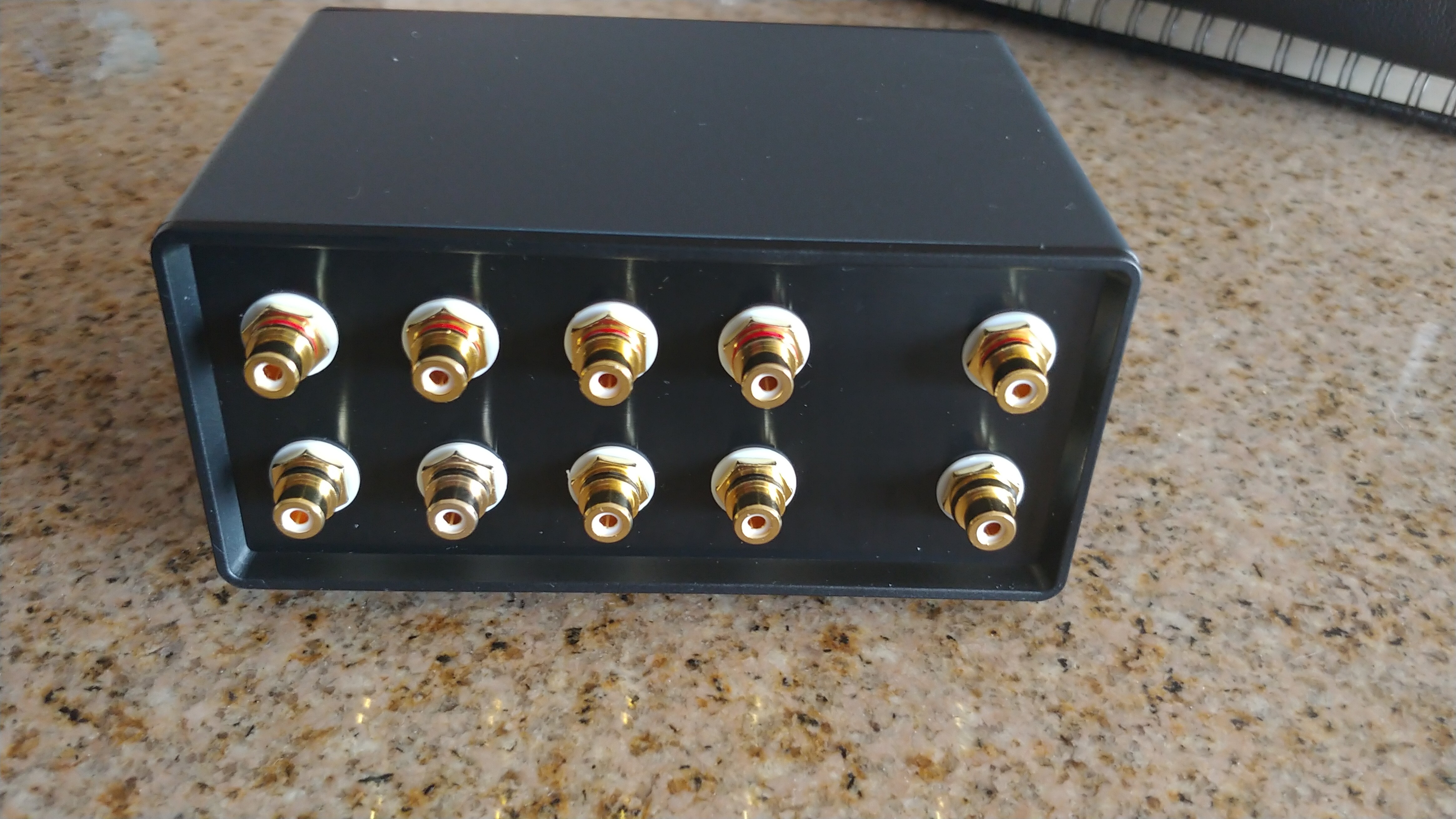

I use the second model and also an XLR box.
Not that it is needed but I have the RCA switcher and also a couple of the XLR as @Shane. They work well for the money and I’ve never noticed any issues with them.
