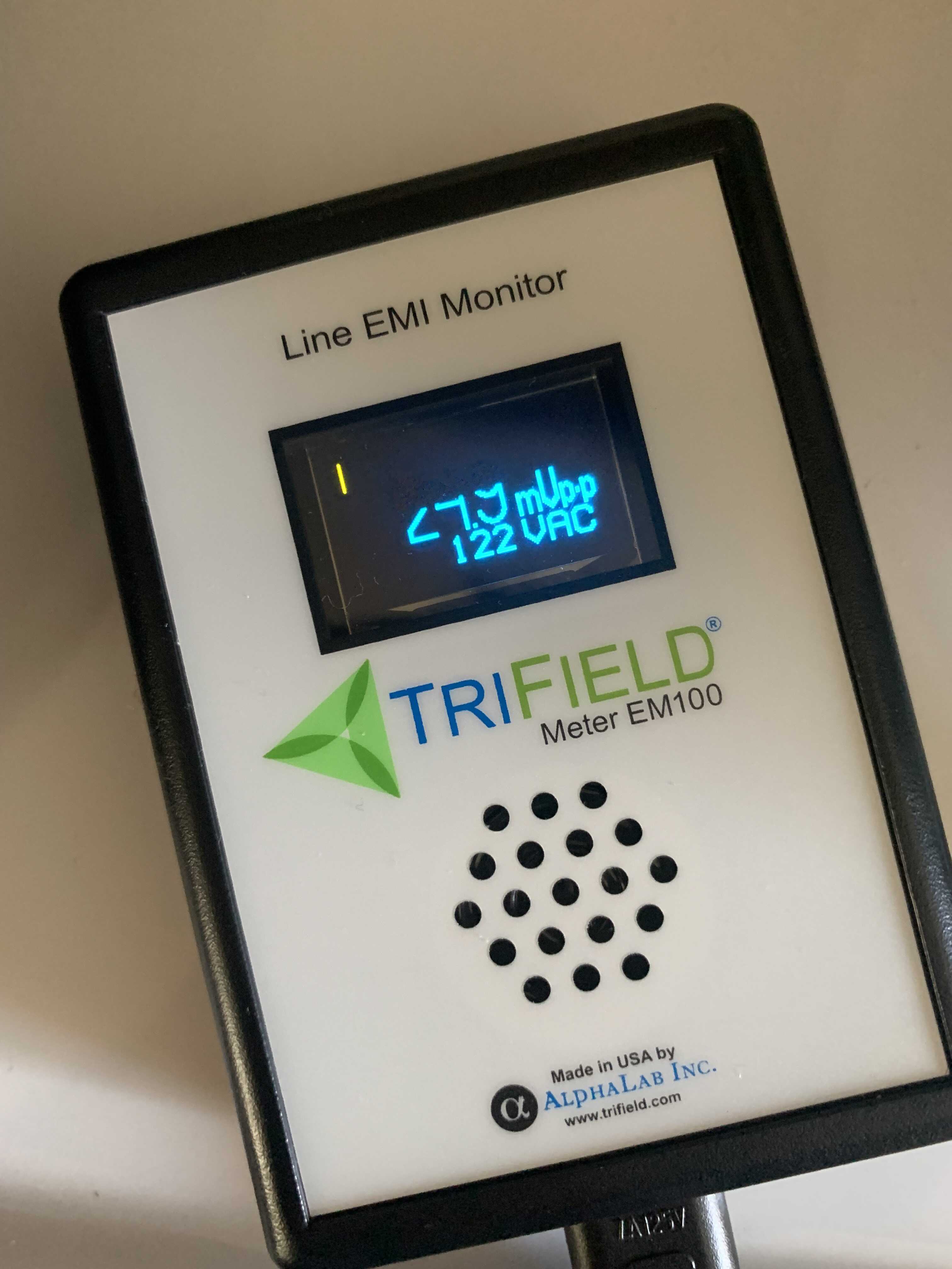

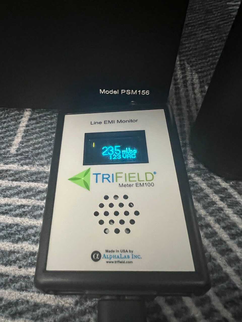

Here are the readings in my system. Noise from the wall is very low so power conditioner isn’t doing a ton. But the tone of the noise from the Puritan PSM156 is much smoother sounding then from the wall. I’m not sure what the sound coming from the EMI meter indicates but it’s not as annoying when it’s connected to the conditioner.
Power from the wall (direct line 15A):
Power from conditioner with everything on (MC1, Serene, First Watt):
The First Watt raises the reading on the EMI meter quite a bit. The Tyrs raise it a little but not to the same extent. And the source components don’t have much of an effect on the mV reading from the meter. I know most people don’t connect power amps to conditioners but I haven’t noticed any negatives from doing it like this. Especially since the power limit of the Puritan is so high.

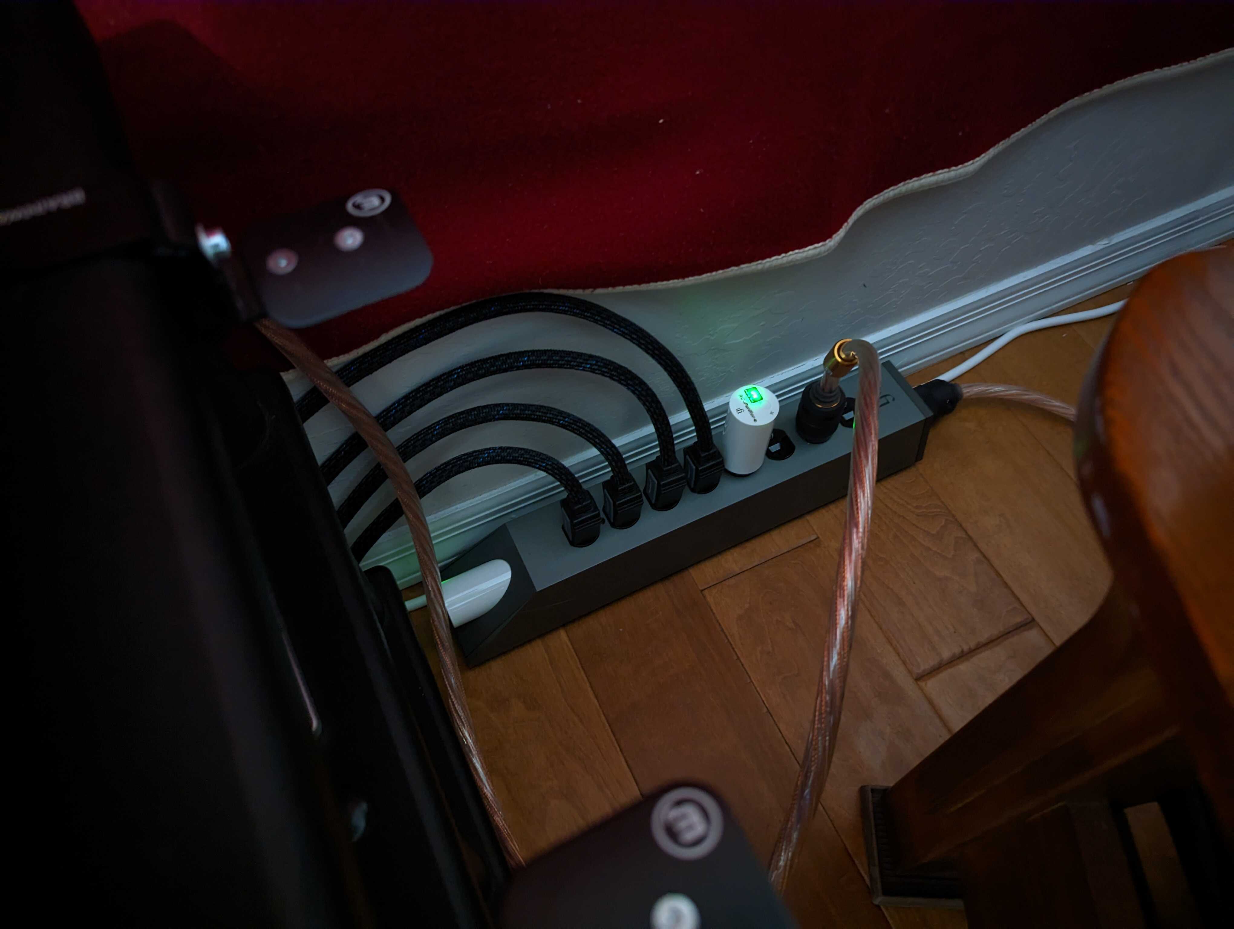

Retested this morning with iFi PowerStation, connected to the wall via iFi supanova cable. I’m down to 35mV:
Highest I’ve seen from the wall is around 230mV, depending on what else is turned on in the house.

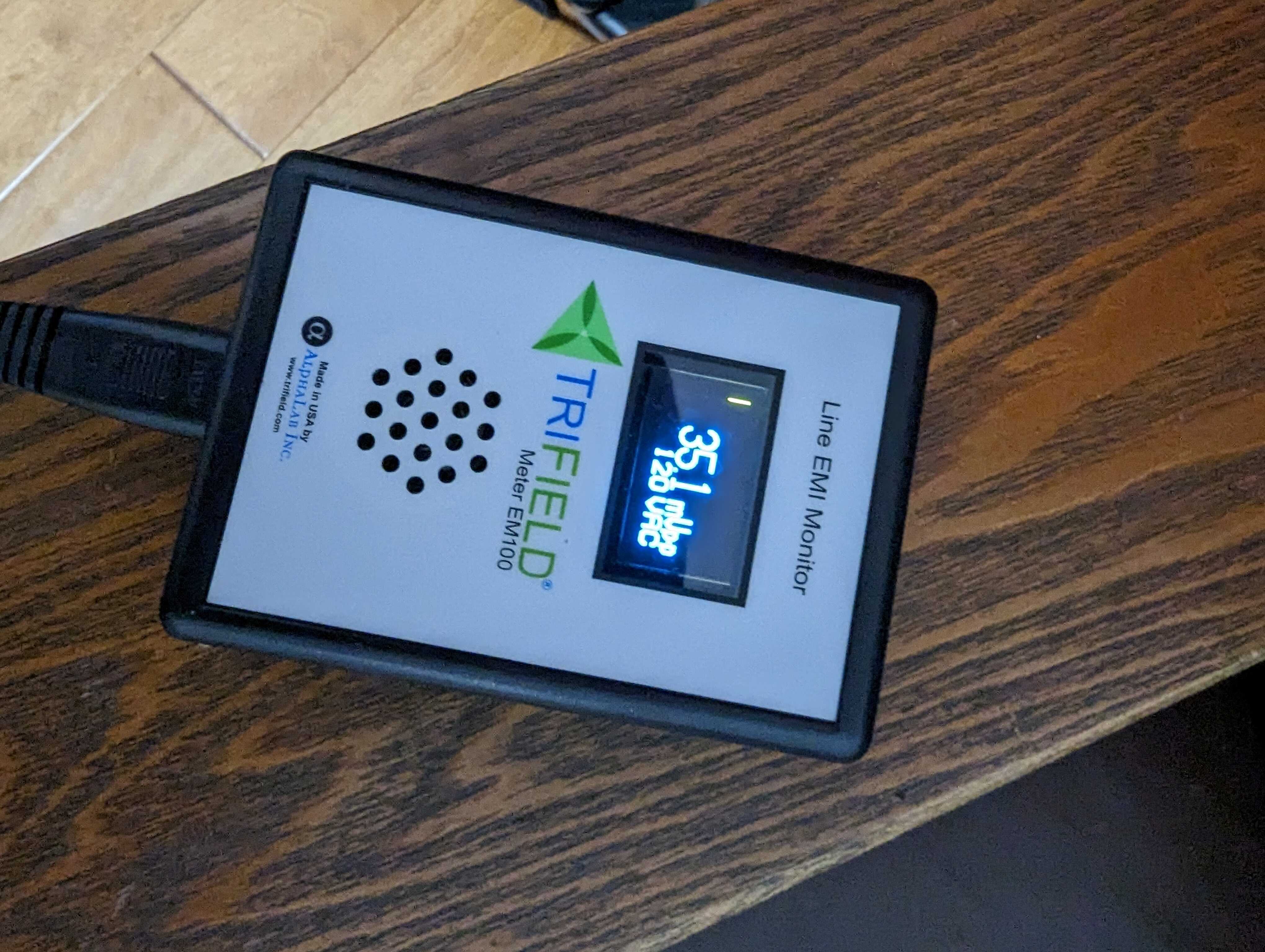

Out of curiosity I added an extra iFi iSilencer to the power station:
This got me down to ~30mV from ~35mV before. So some measurements improvement.

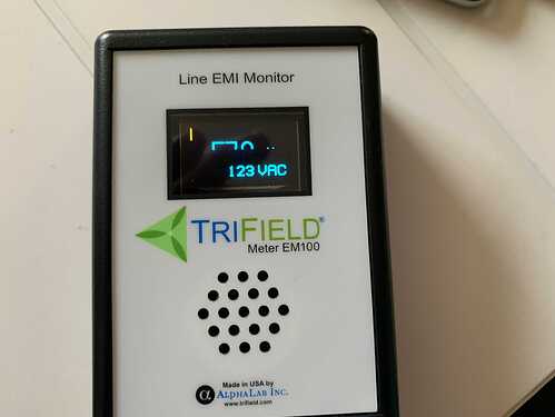

Very interesting results. First off, my power is much cleaner than I thought it would be. I also had three different power solutions that I tested: iFi Power Station, Furman Power Conditioner PST-8, and a Belkin Power Strip Surge Protector.
I tested the outlets at various locations in my home and the results were very surprising. All pictured results are taken with all equipment connected and running at their respective locations which includes tube/SS amps, VU meters, usb chargers, lighting, etc. The iFi was the sole audio-only setup. All outlets for the power strips measured about the same (the differences were negligible).

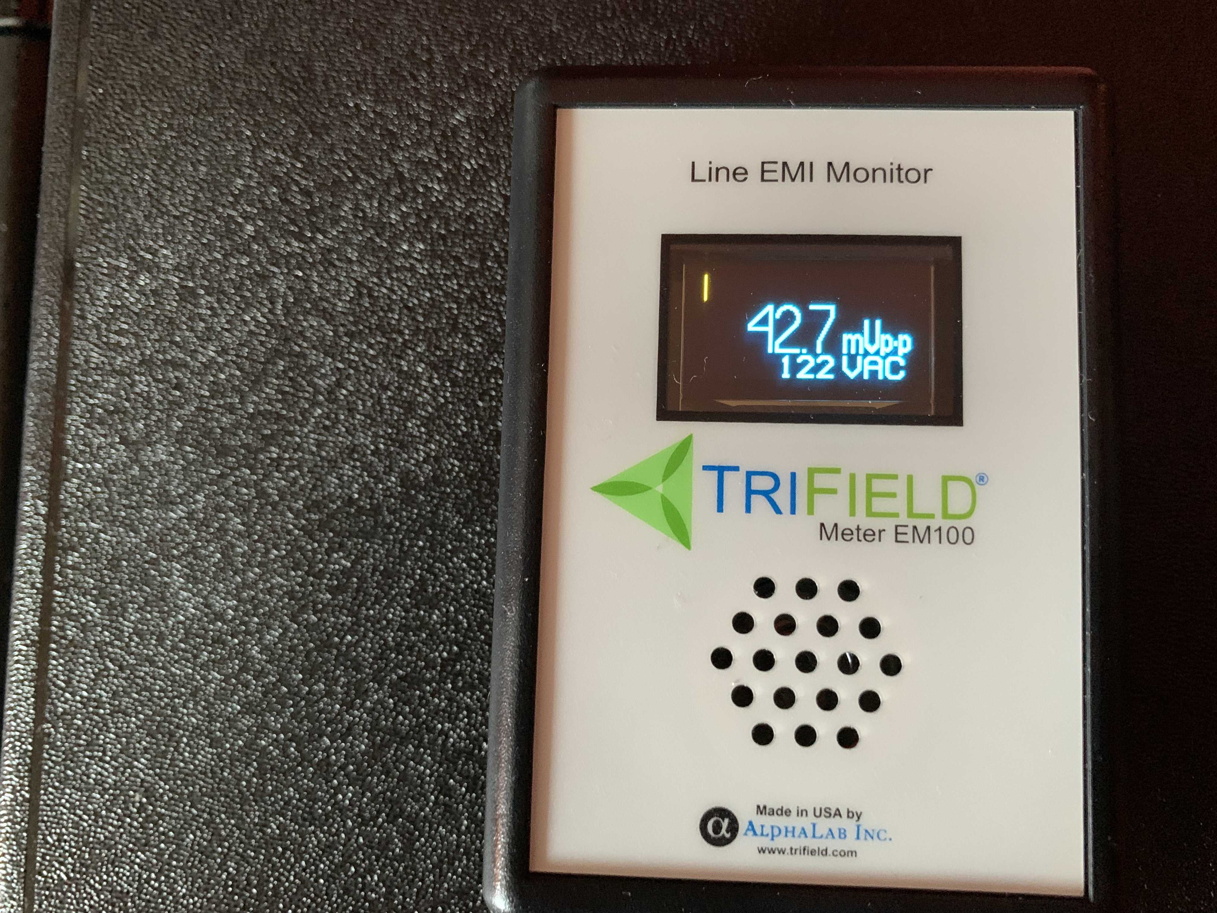

iFi Power Sation, 42.7

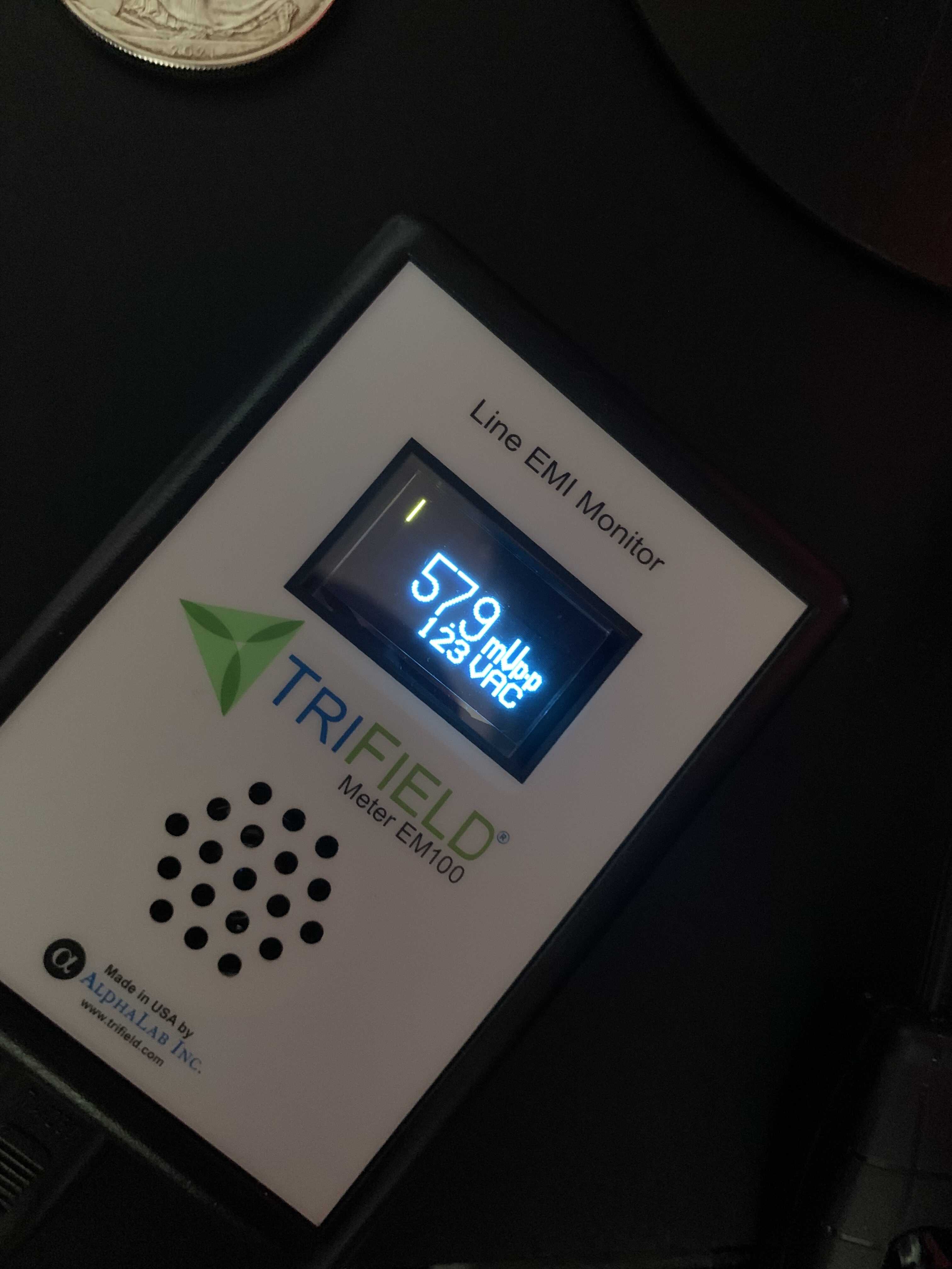

Furman Power Conditioner PST-8, 57.9
Belkin Power Strip Surge Protector, 57.0

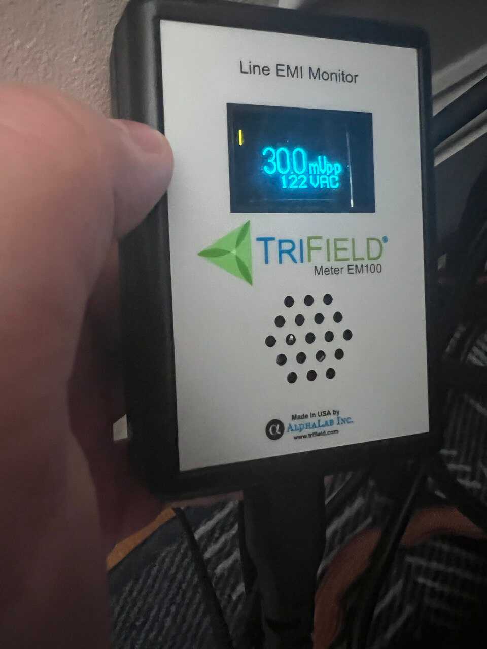

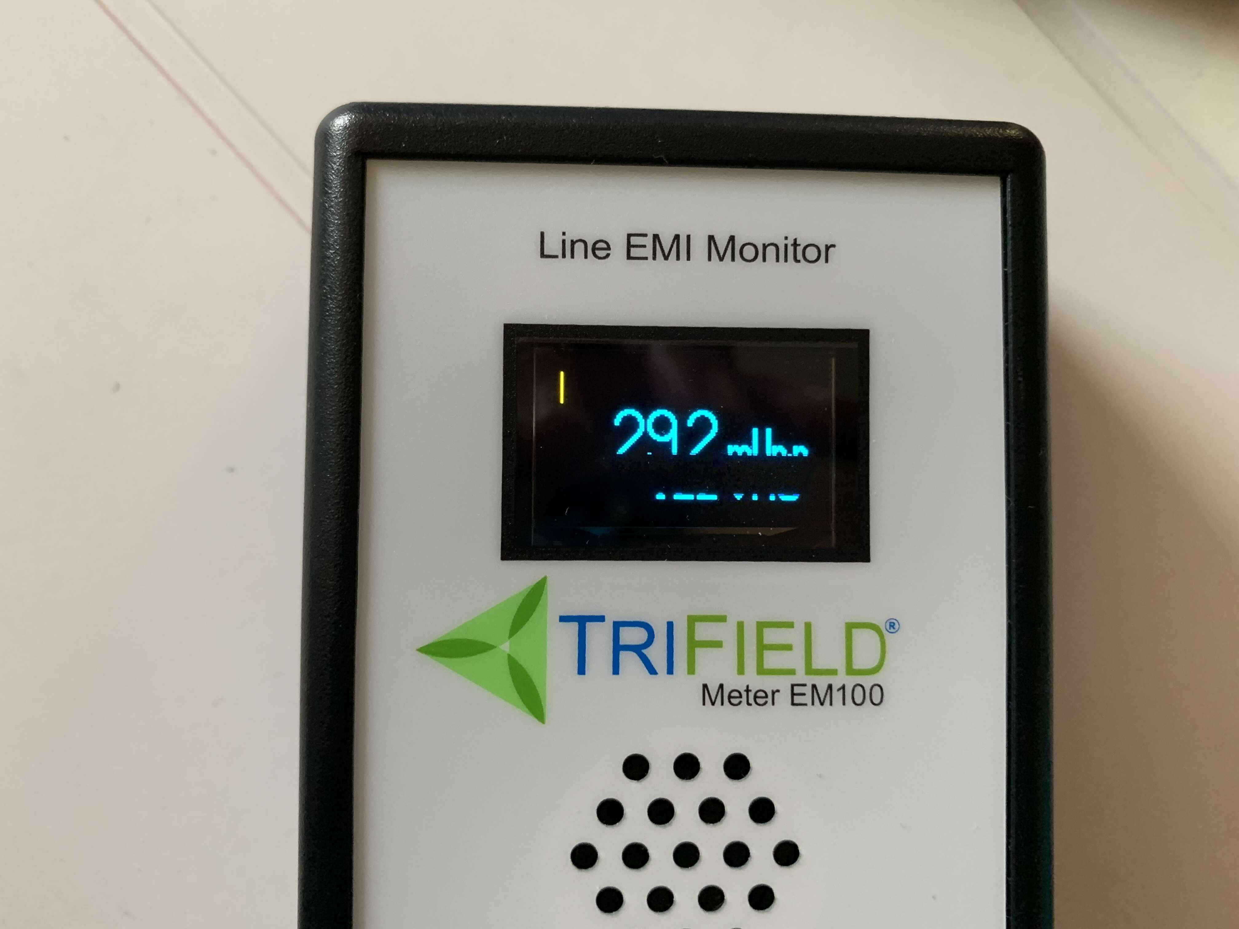

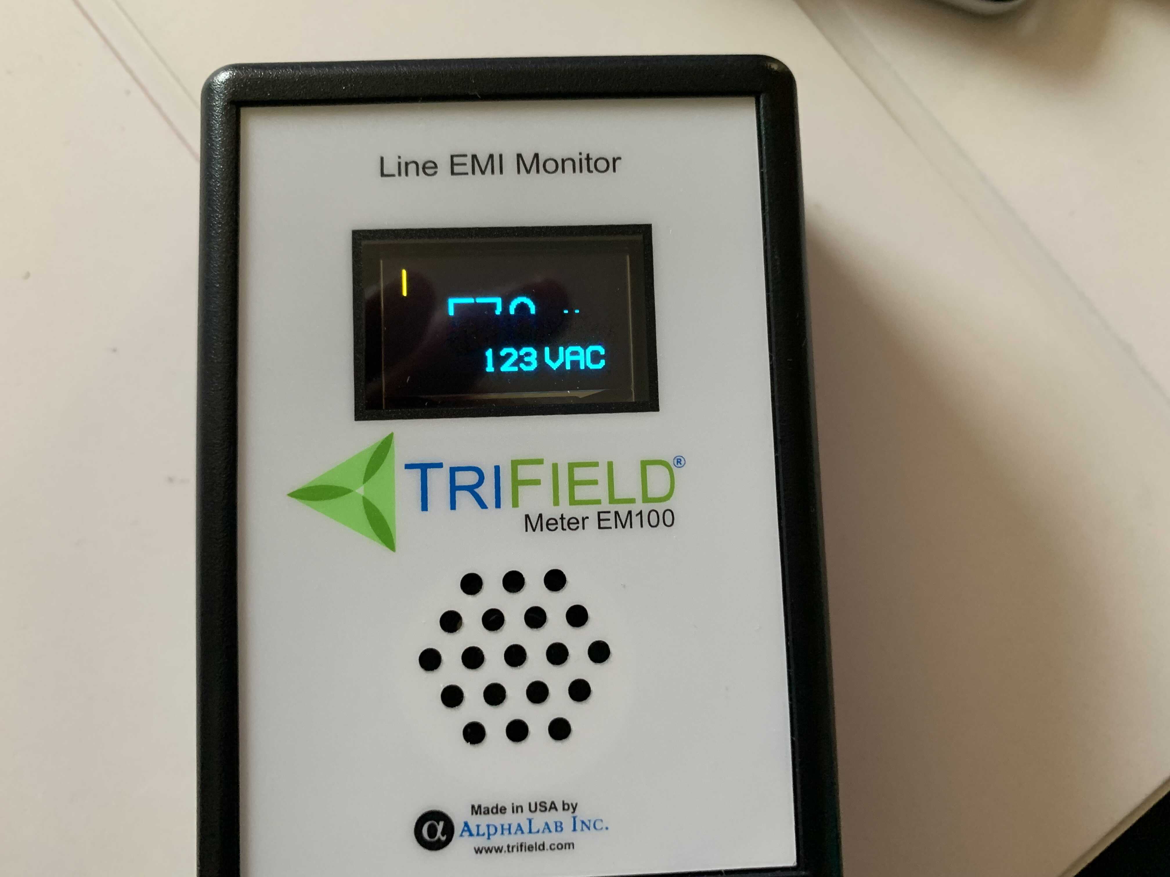

These are the measurements for the outlets. The three outlets measured virtually the same so I only took one photo since it’s a fair representation of the three locations.
29.2 with an average of 30
Lastly, this is the quietest measured location in my home which was the kitchen.
24.9 with an average of 25
My outlets are quieter than any power solution that I currently own with the iFI Power Station being the quietest of the three.
Another interesting observation was that the iFi iPurifiers injected noise into all sockets tested, Wall or Power Strip. On the iFi they added about 3mV each. With the Furman they added an average of 10mV each with similar but slightly lower averages on the Belkin.
The noisiest measurement recorded was the Furman with the 2 iPurifiers getting an average of 80mV.
I also tested with and without equipment connected, but the differences were also negligible. The three tested about the same with or without electronics connected.
Subjectively I find the iFi to sound the best to my ears, adding quieter backgrounds, and greater dynamics.
This was a really fun exercise, and I learned that my power is better than any solution that I currently own. Go figure. :man_shrugging:t4:

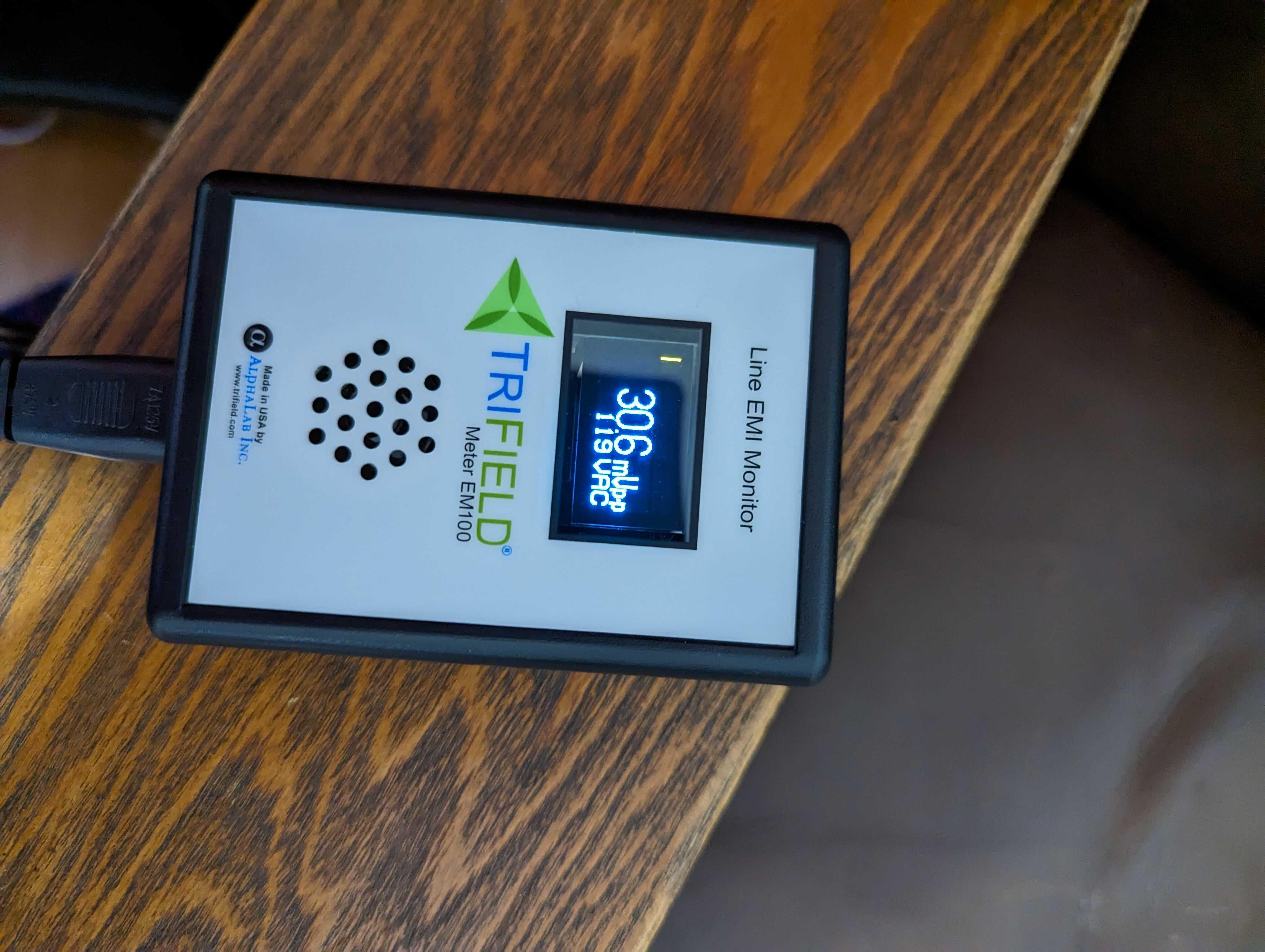

I measured this morning since most of my neighbors are still sleeping, and I got slightly lower numbers.
One other thing I did out of curiosity was to swap out the stock C7 cable on the meter with an Wireworld Mini Stratus. It measured more noise than the stock cable (averaging 5mV more noise).
