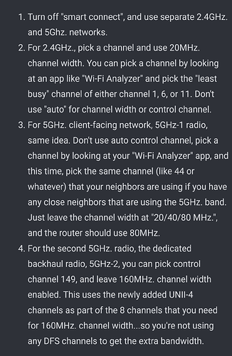

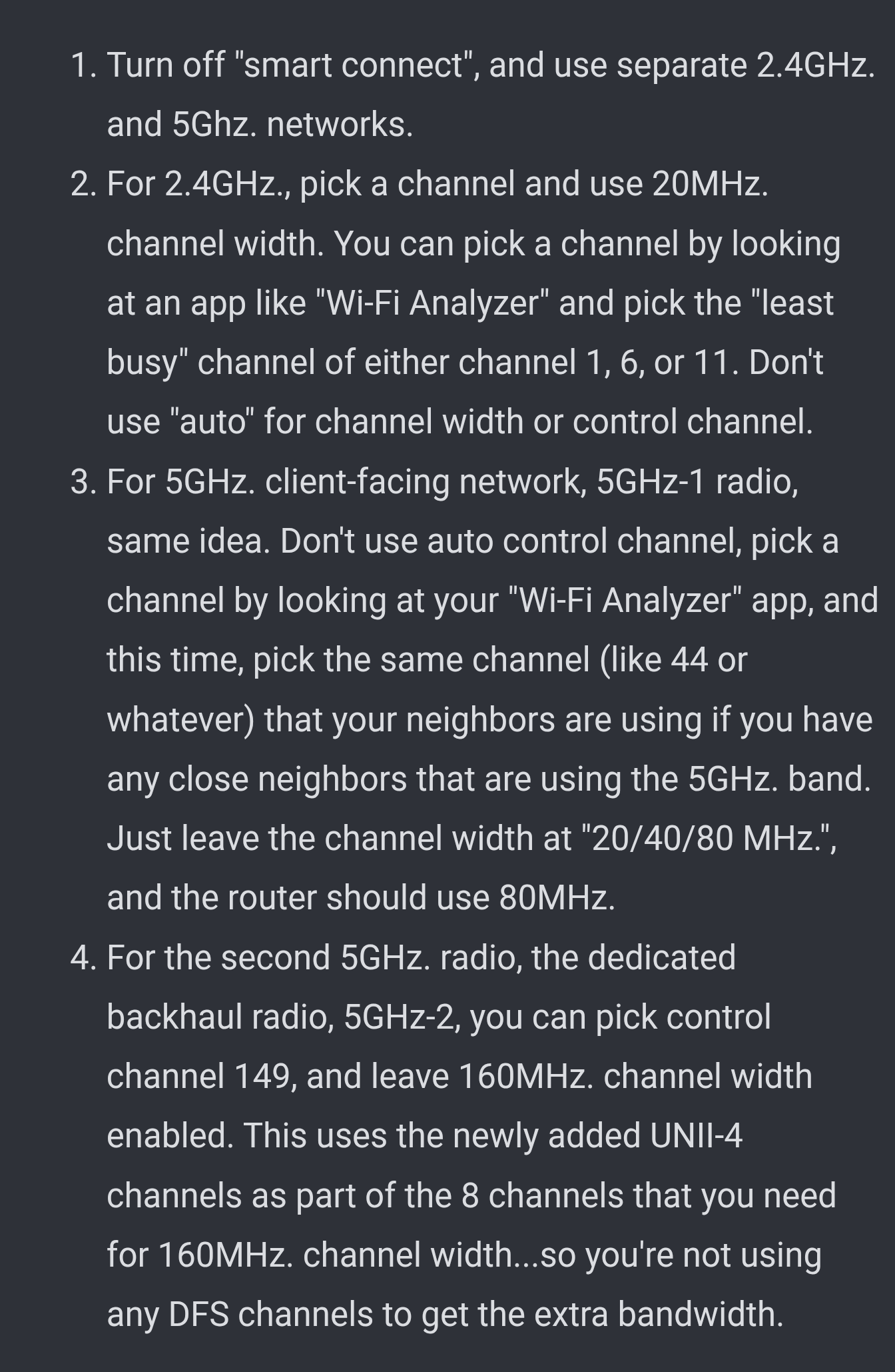

I have an asus router, i need to lock it to one channel or else it will keep on disconnecting and reconnecting devices.
This is worth a try unless you want to daily power cycle the router…
Thank you! I’ll try that.
