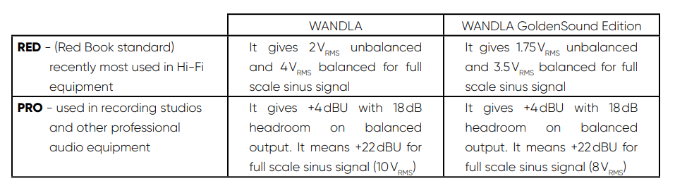

I actually don’t owna a WANDLA, i tried to use the v281 as pre because i read that the WANDLA has a 12V output signal, and my Gungnir “only” outputs 4V via XLR.
Noon is like 10% of the input, so ~1V with 10V in, and as I said the signal will be less than that probably closer to 300mV RMS on average.

It’s mostly moot anyway, 7v sounds like a lot more than 2.2V, but it’s only about 7dB’s.
It looks like the input sensitivity of the Orr is 4V RMS, that’s pretty high, would require an ~11V PK2PK input signal to clip.

The Wandla XLR output
v281 input voltage seems to be around 21 dBu, which works out to about 8.68 Vrms.
You can still adjust the voltage in bypass mode. Just use the digital trim on the Wandla to bring the level down a bit. For example, run Pro mode in bypass and knock a few dB off with the digital trim. Or skip bypass and use the voltage adjustment to lower the output directly.
