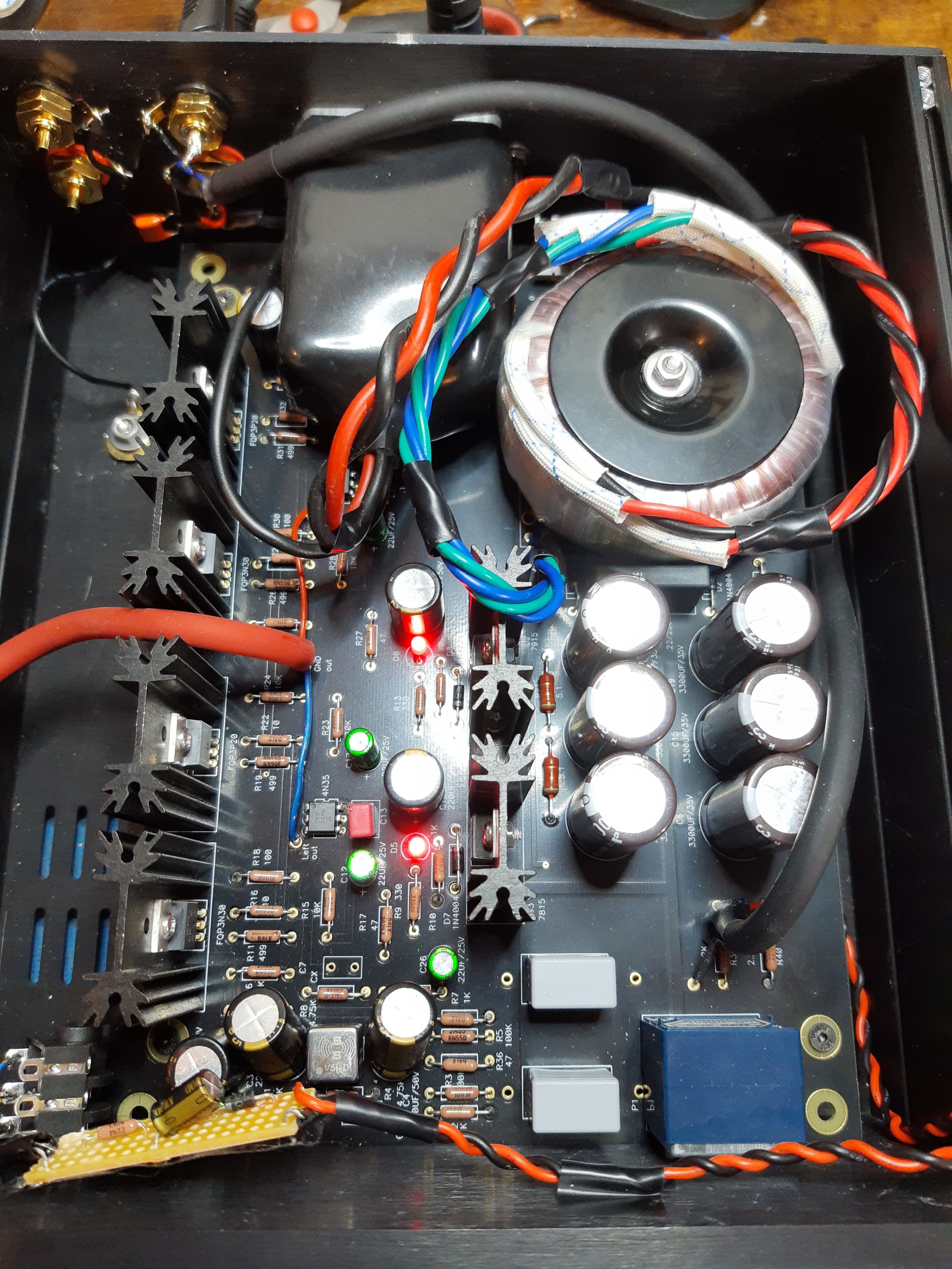

, I have recently finished rebuilding the Whammy. I wasn’t happy with the quality of work and I learnt so much I knew I could do a much cleaner build. Also and most importantly I just really wanted to do it again.
I reused all of the large caps but replaced everything else. For the smaller parts as a matter of ease since I had no wish to de-solder all of those!
I made one change by replacing the transformer with a toroidal transformer. Mostly to learn how and partly for aesthetics.
It was a much, much quicker job and I completed the rebuild in about two hours and remounting in the chassis took another two as I was trying to get some nice clean cable runs.
So now a small confession. I’ve been very sceptical of those of you who are absolutely sure you hear a difference from a cable, or a power source. No judgement, whatever makes your fun flow is fine by me. However… I swear blind I can hear a difference in this rebuild. Whether through better work or because of the change in transformer type I have no idea but it just sounds a bit more lively. Funk bounces with a little more spring? It just dances a little bit. Really hard to pinpoint, no idea if it is a factual or subjective difference but it doesn’t matter as I am really enjoying it.
Also it does look cool and I made it.

But yeah, so much makes differences. I would think for you the transformer would be doing it but cleaning up any wiring can help keep the signal clean.
Heck yeah you did! Great work btw, very impressive. We need to get you a bhc kit stat!
Damn you all!!!
I think it most likely is the transformer too but I can’t rule out other variations. I really would not have expected the way the power is delivered to have an effect. It’s in the range of the change I heard moving up to the BF2. Small, subtle but there if you listen carefully.
Weird and kind of cool. Now I have to think about power too dammit!
Thank you so much. I am unreasonably proud of myself. Btw, I learnt to solder at school - all kids had to along with basic woodwork, sewing and cooking. Most useful life skills school gave me.
I think I will have to save up for a BHC. I keep looking at the guts of those and it does look like a fun build. Nice to have something to aim for as I was thinking that my setup is just about complete for a few years to come.
