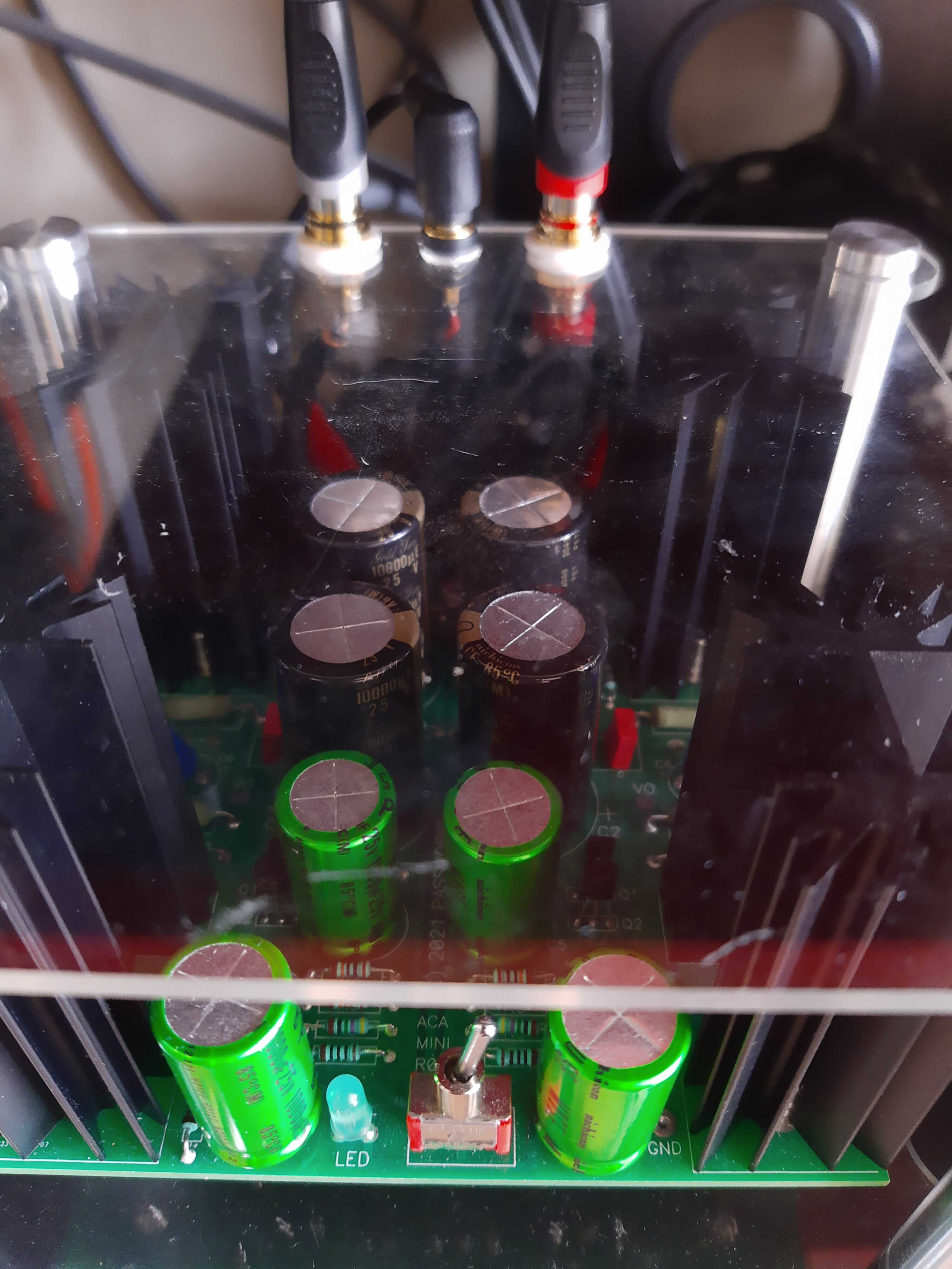

I finally finished building an ACA mini. I say finally as I had previously built one that failed to work and the problem solving would have led to far more trouble than a rebuild. Not a difficult build - a lot simpler than a Whammy for instance, but part selection is fairly important - especially for the trimmer resistors. Additionally there are two BOMs and one is slightly buried in the build guide thread over on diyAudio.
Long story short I elected to start over and got a new board. I got the essentials kit with pcb, mosfets and jfets and sourced the other parts myself. This saved money (being in the EU) which I then immediately spent on more expensive components than I would have gotten.
Nichicon capacitors and vishay resistors stuff the board, I got a Leicke power transformer as a like for like alternative to a Mean Well.

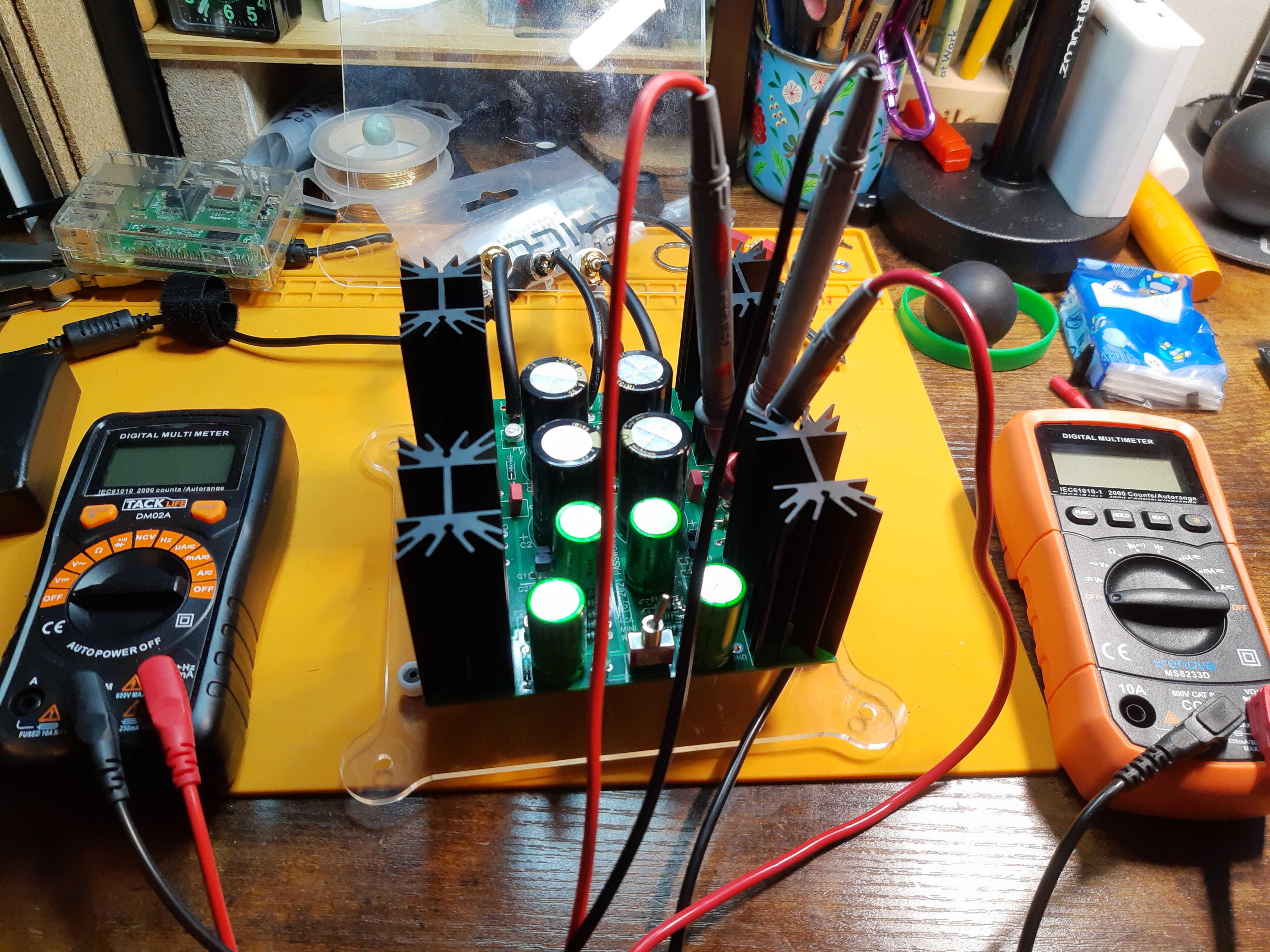

The build was super simple and complete in a little over ninety minutes including part sorting. Biasing the circuit took longer and I found this excellent video guide.
Essentially each channel needs two trimmer resistors that effect one another tuned to get as close as possible to target voltages. You then wait for the circuit to stabilise and tune again, repeat until there is no more drift. This was precision work and I took an evening over it.

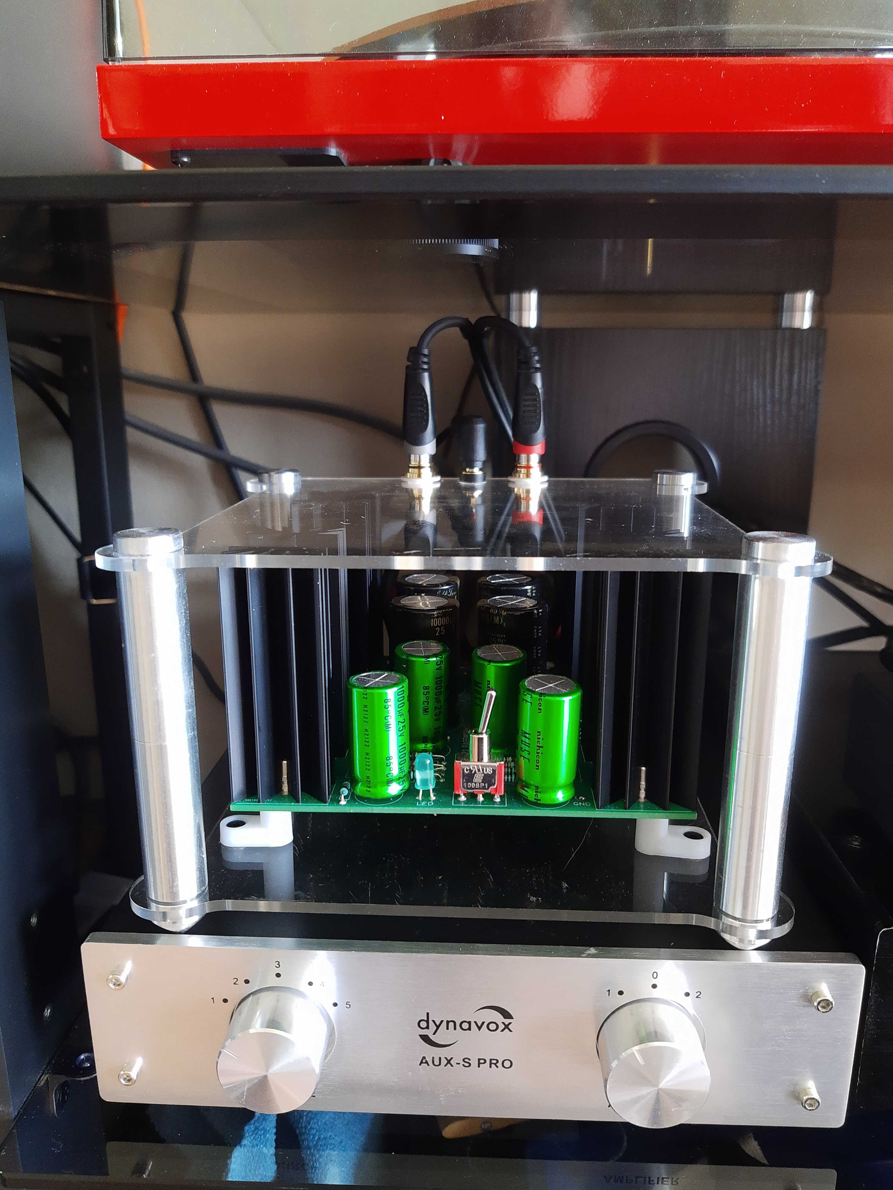

This done I mounted the amp in a small acrylic and metal stand thing (made by Topping) I had lying around and set it up.
So this is a very low power amp at only 5W into 8 ohms and 8W into 4 ohms so I was unsure and curious as to what I would get out of my Dali Spektor 1 desktops rated at 40-100W into 6 ohm. The answer was a really, really nice sound. Louder than the BasX A-100 - I had to turn things down- and while there is minimal difference I feel like things are a little more sparkly in the treble and sub bass is a a little more textured. All in all everything sounds like the nicest, cleanest vinyl with a little digital precision sprinkled over it. Stereo imaging is really good. Like, really.
In short, I love the sound it makes.

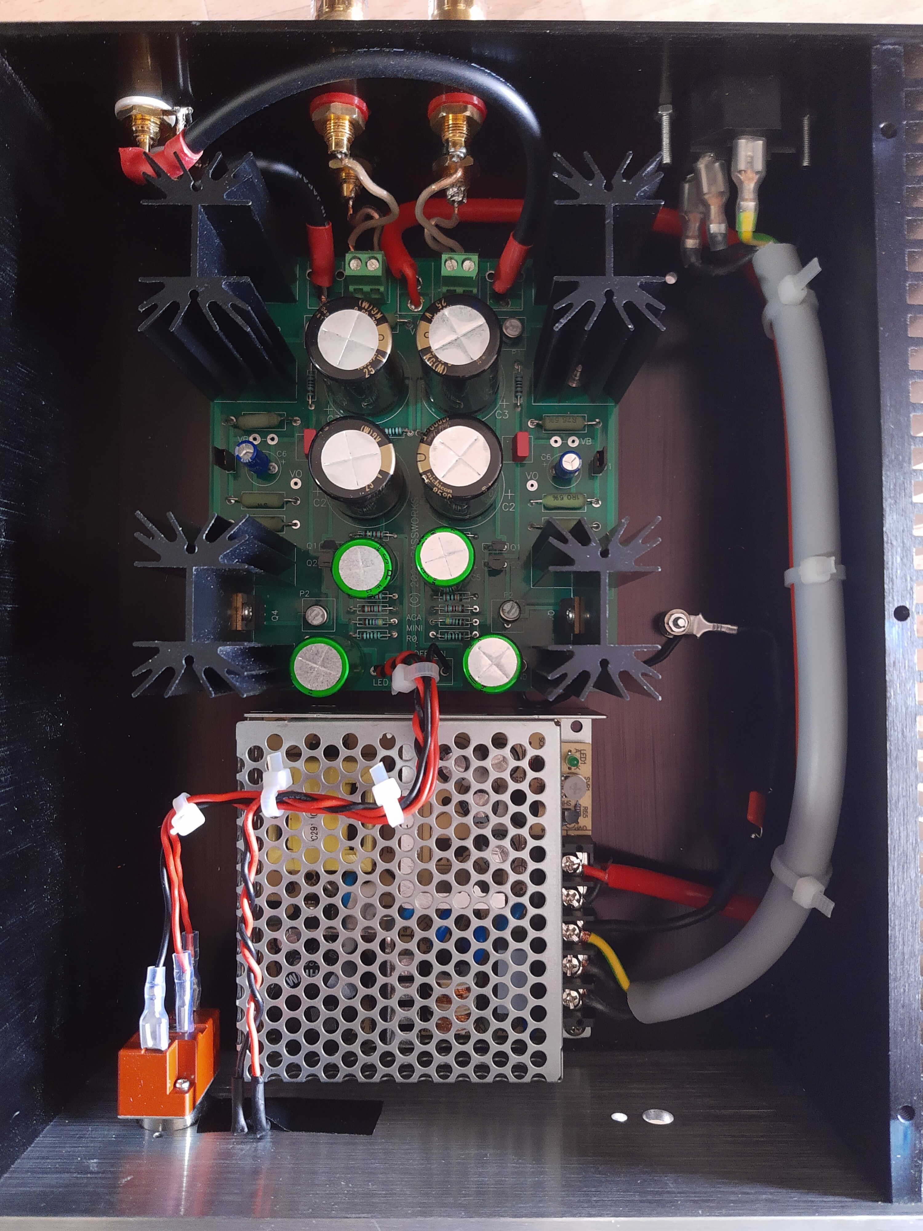

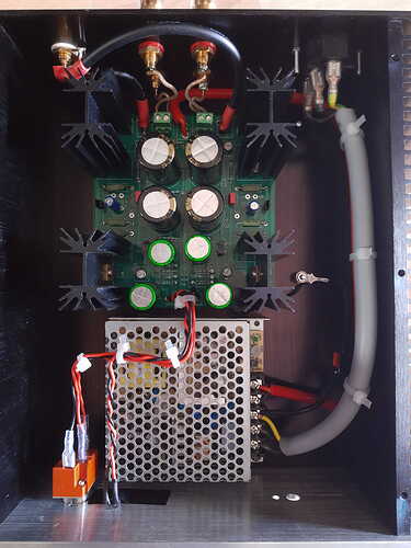

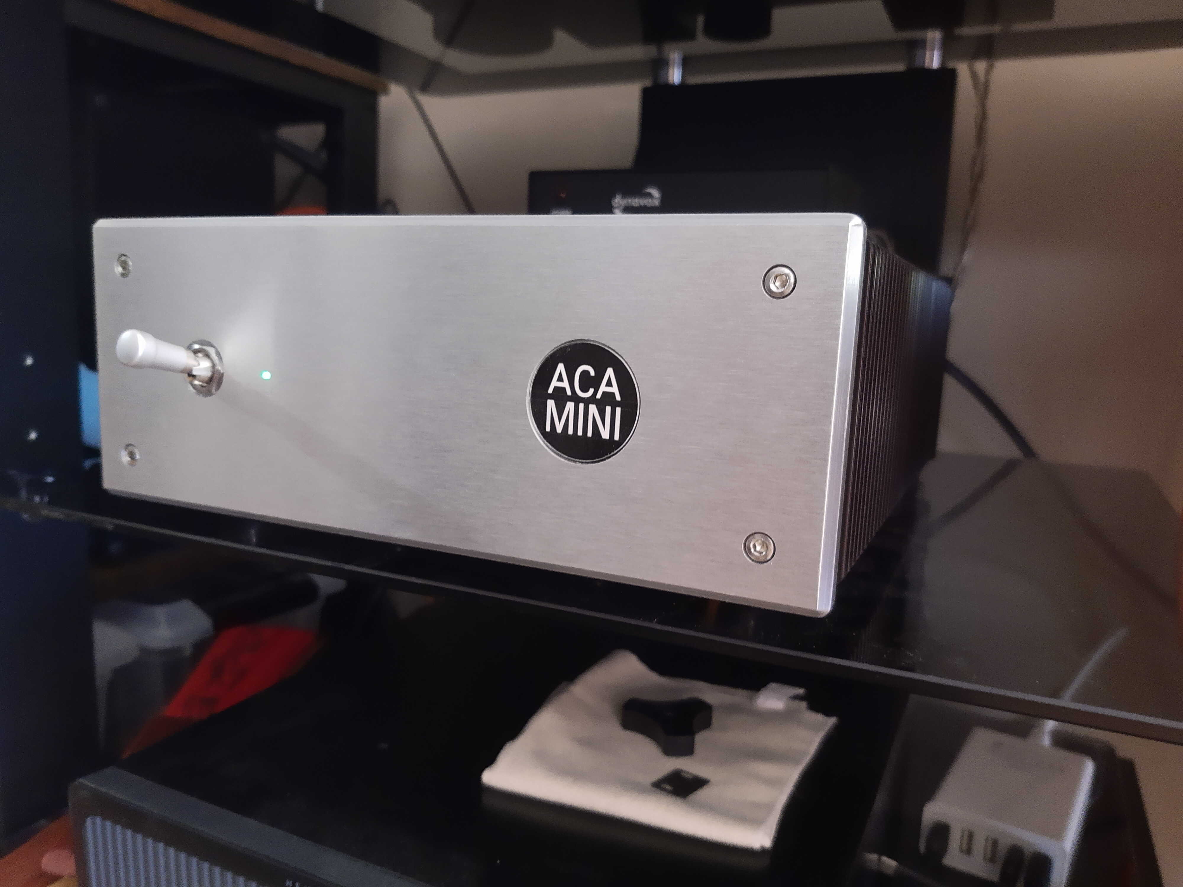

Placed in an enclosure with an internal Mean Well SMPS. According to the designer the ACA Mini is designed to run on a switching power supply. Locking lever power toggle cost nearly as much as the chassis but it is soooo pretty.
Muy sexy!
