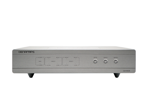

Hadn’t notice that Denafrips made a master clock. Reasonably priced given that some I’ve seen out there are in the $10K range.
Anyone tried it?

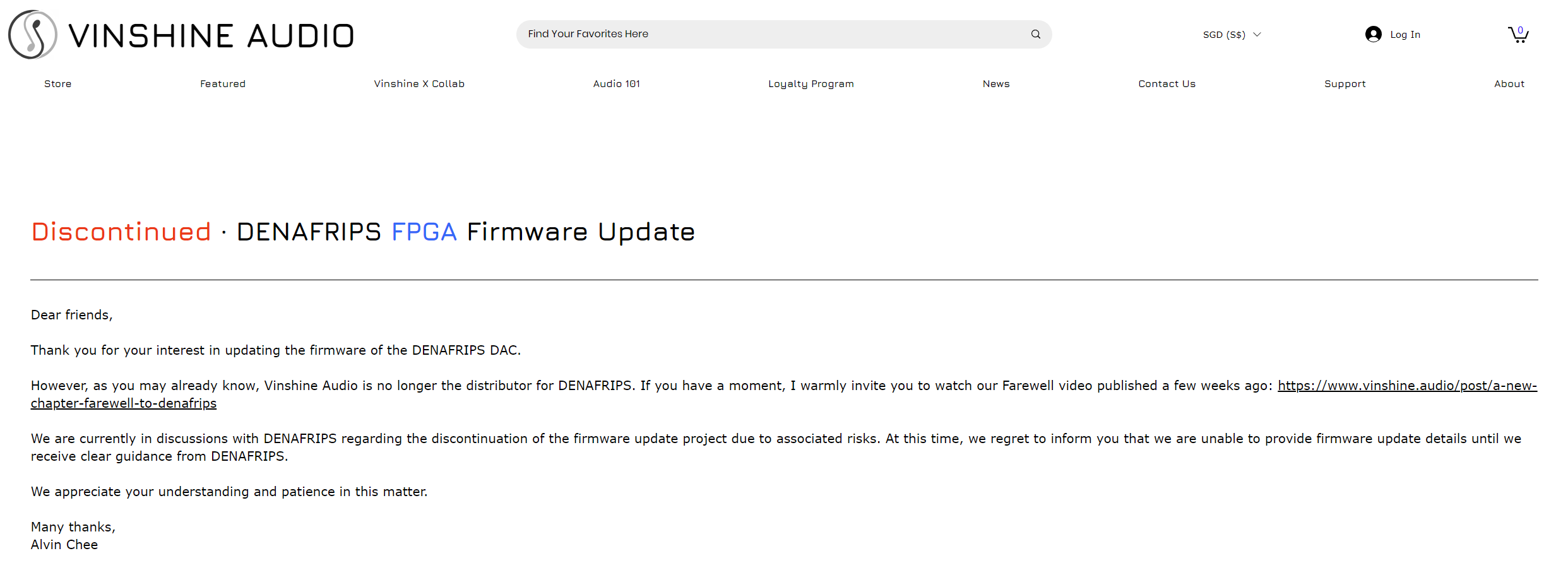

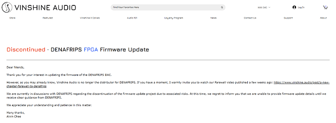

I appear to have hit a stumbling block. Anyone have any advice regarding how I should now go about upgrading the firmware on my new Pontus II?
Reach out to Denafrips direct, since they’re doing their own distribution and support now. Only thing I can think of.
I’m sure there are tons of folks that prob have the files stored locally on their PC but you’re opening up a can of worms potentially with that.
