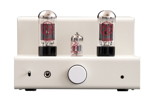

This is the other speaker Amp on my desktop, it’s an elekit TU-8150, mine has upgraded resistors and is modified with an additional switch on the front panel to change the modes the tube is running in rather than using internal jumpers.
It’s also a decent headphone amp for high impedance headphones.
But it’s only ~3W into 8 Ohms, so you need to pick the right speaker.
Unfortunately I think it’s discontinued now.
